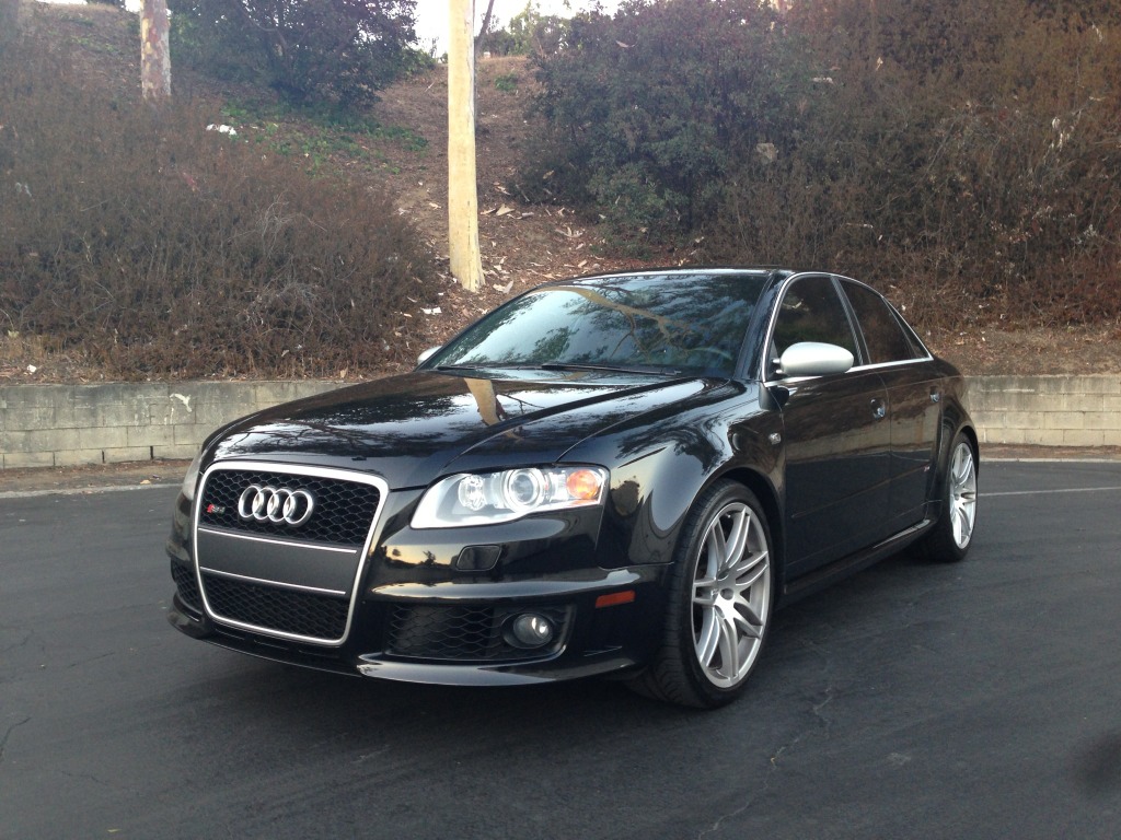

About 9 months ago I was considering my options and getting some owner opinions on whether I should trade my 2012 GTI for an RS4. I received a lot of feedback, and it helped steer me towards the right decision...which was to buy a Phantom Black '08 RS4 with about 57k miles (92k km's). I picked up the RS at the beginning of December 2012 from the dealer, and drove it home, with a stop at my in-laws to pick up my wife:

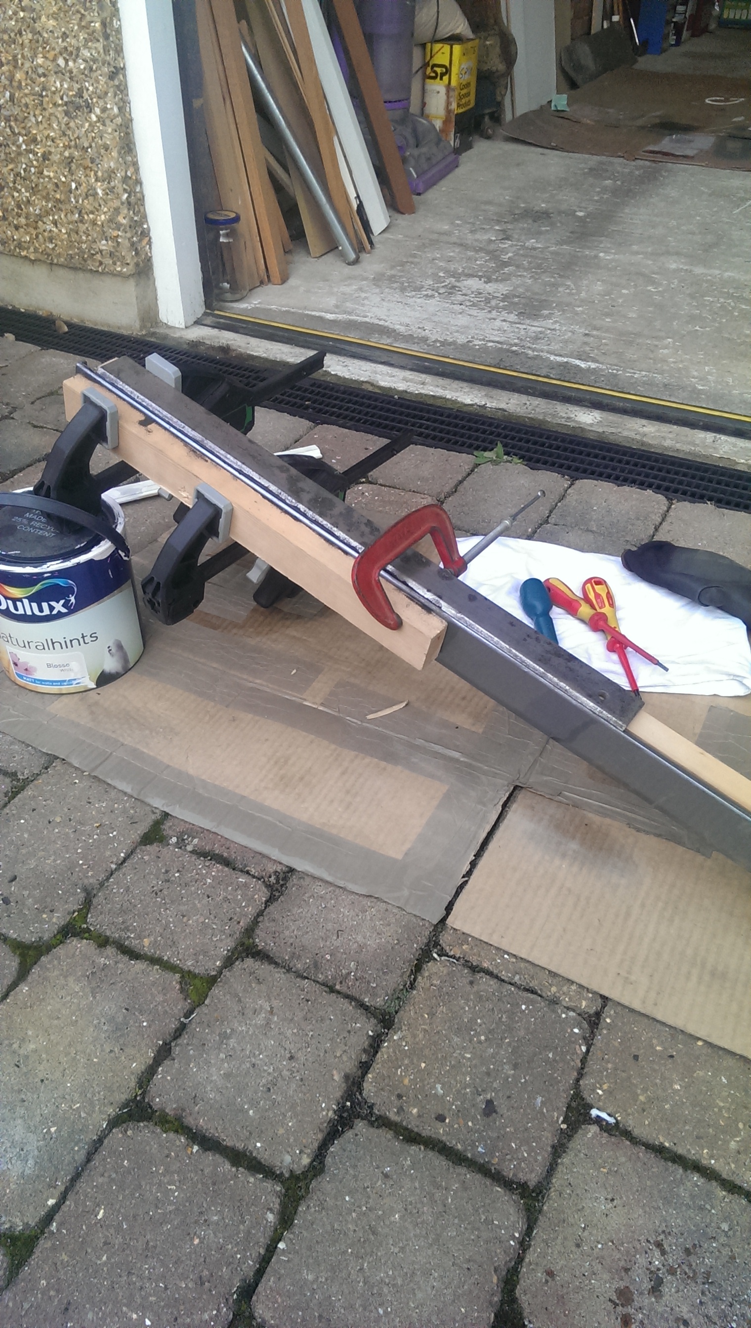

Out of interest how did you sort the side strips delaminating ? I just happened to have fixed both mine this afternoon.
I was dreading the same problem that had plagued my old B5 (corroded lugs), but fortunately was able to remove all the internal rust and re-bond.
(why the fcuk would anybody use both steel and aluminium in the same component.... oh wait, aux -rads.)
Looks like new again now :-)

I did similar. Spent some time cleaning out all the rust and crud. Then clamped before using "Q-Bond". I'd never heard of it before and had some doubts as its cyanoacrylate based (super glue). But it comes with two small bottles of "powder", one for filling metals, one for plastics.
A couple of minutes after application and it's rock hard.
Amazing stuff.
The strips look as straight as a die now.
Clamping. Notice the black "magic" powder. The excess just shakes off.
