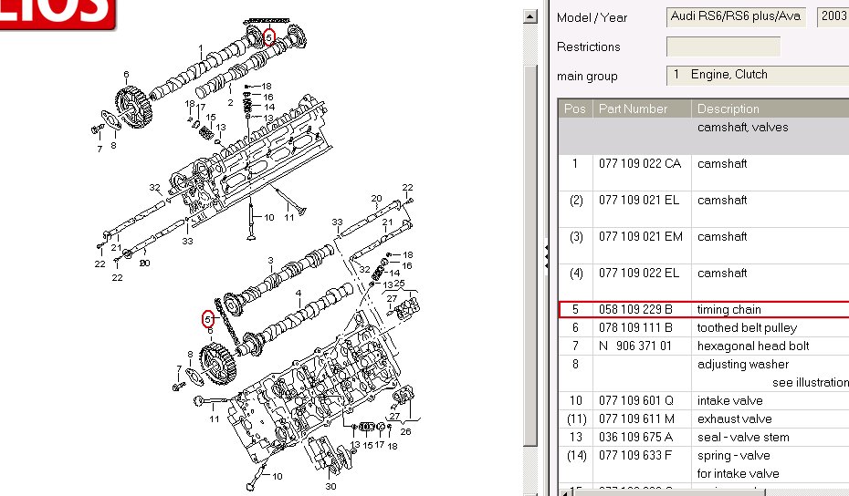

Hi, the rattle you hear is the camshaft timing chain tensioners. With age the oil seals perish in the tensioners causing oil holding pressure to drop overnight, as the engine is started it takes a moment for oil pressure to build up in the tensioners to tension the timing chain correctly, causing the chain to rattle. Simples
Posts: 20345
Post by Shoppinit » Sat Oct 24, 2009 8:36 pm
What timing chain?
raceman
Posts: 158
Joined: Wed Feb 25, 2009 9:43 pm
Post by raceman » Sat Oct 24, 2009 9:26 pm
the ones at the back of the engine?

ecain63 wrote:Timing chain? I thought it was belt!
There are chains inside the rocker covers to keep the cams in time....

Post by gorwanvfr » Sun Oct 25, 2009 7:54 pm
Chains

Post by TIMSRS » Fri Oct 30, 2009 10:03 pm
Yep, you are right they have chains just under the rocker covers.
If the tensioners go weak the chain will catch on the rocker cover itself.
