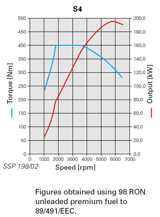

Post by MCB » Sat May 26, 2007 10:17 am
Taken from the Audi S4 Engine PDF:
S4B5 Avant

Post by dazzer » Sat May 26, 2007 10:30 am
Thanks:
1 Lb-Ft = 1.35582 Nm.
