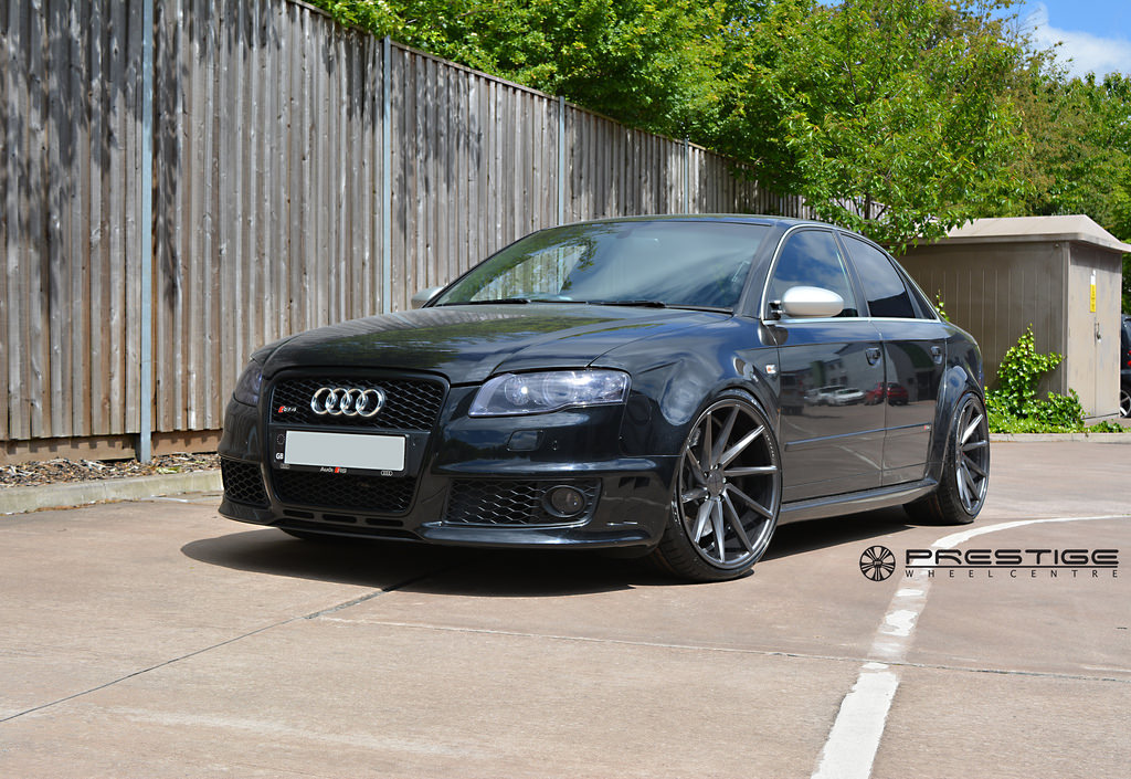

Would quite like these on my imola yellow rs4, they're made by vossen

Those wheels look pretty awesome. Prestige wheel centre are a forum Sponsor, I'd give them a call and I'm sure they'll sort you out.
Standard wheels are 19" x 9", with an offset of ET29, and centre bore 57.1. Most people slap on 8mm spacers making an effective ET21.
I have a 20" set of wheels from a Q7 (although I have my 19's back on for now): 20" x 10" with 255/30/20 tyres - bit stretched. Wheels are ET44, and I have 15mm adapters making an effective ET29. Lowered on coilovers, front arches have previously been rolled. No rubbing.

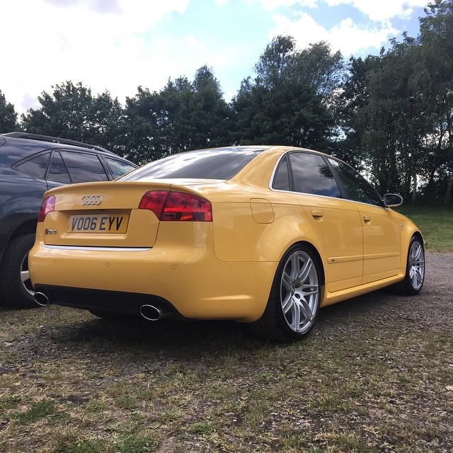

Thanks guys, I will post pics when I get it all done, I only have this picture of it clean (currently filthy), not everyone's colour but I absolutely love it.
