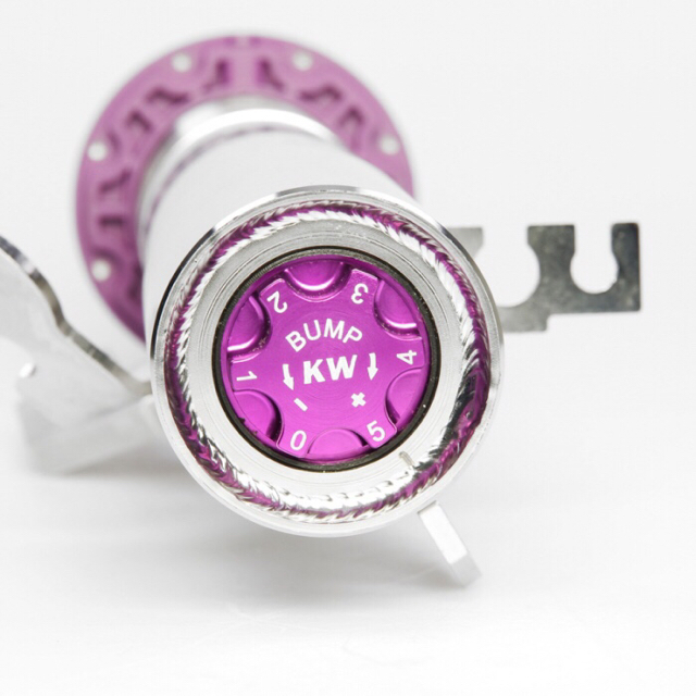

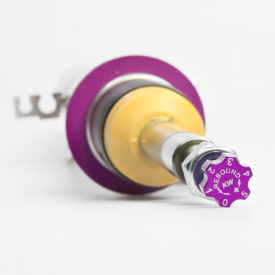

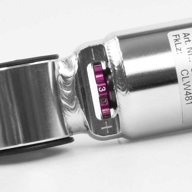

So I've found some images of kw v3's but unsure if they are for the b7 and found a bump in the road, maybe.....
Can anyone confirm the adjusters on the b7 look like these?
I'll need to make adapters or have them made up but the 'bump' is mounting to the shock body tube. It's not like I can weld a bracket on there........? Cable ties? Lots of cable ties!!!?

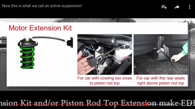

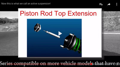

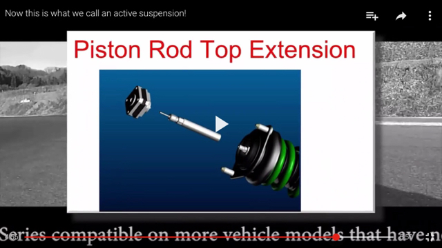

Re: KW V3's with modified Tein EDFC
Just found these the I could modify and may be easier to attach....
They are cable driven extensions and may help with attachment and tight areas if they come up.
