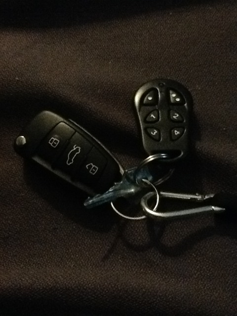

I live in not such a lovely area of London and have a key fob that means that whoever has the key has to know the code before it will start, I have the keyless go/start option and whilst I miss it, its nice to have a bit of confidence that that car should be there in the morning. I've tried to attach the photo of it but it may not have uploaded. Cost £100 fitted.
