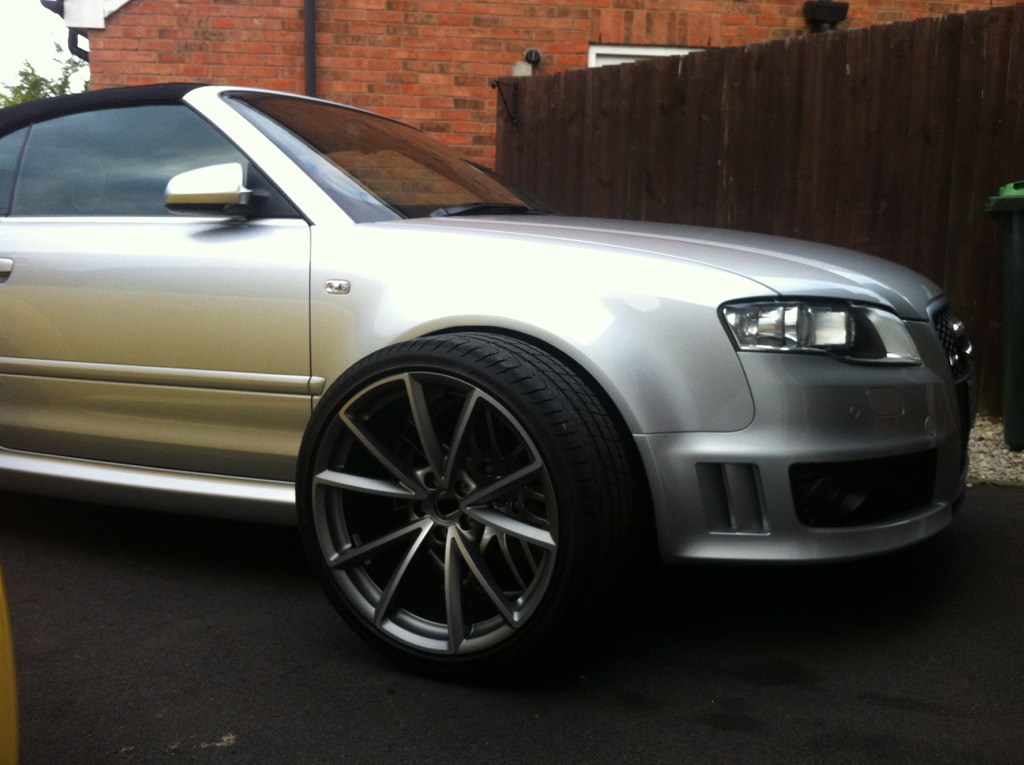

The bore sizes will be different I think buddy. B7 was a 57.1mm bore most of the modern Audi''s are 66.6mm bores. Hopefully someone can ratify this. What's the offset on them?
Re: Audi RS4 B7 fitting RS5 20" V-Spoke Alloys
Post by HYFR » Mon Jun 24, 2013 10:46 pm
Yes, you will need spigot rings
Post by MikeFish » Mon Jun 24, 2013 10:59 pm
8E part number is for a B7 isn't it?
Defo not RS5 wheels at 19" and ET29 offset, that is B7 size and fitment (unless they are a smaller winter wheel or something).
Also, I didn't think the RS5 came with V spokes.
Post by MikeFish » Mon Jun 24, 2013 11:00 pm
Hang on, the title and your first post said 20" then your lat post said 19". Which one is it?
Post by MikeFish » Mon Jun 24, 2013 11:03 pm
That part number comes up as standard 19" RS4 alloys for the B7. Where did you get the 20" v spoke bit from?
Post by MikeFish » Mon Jun 24, 2013 11:05 pm
In that case I'm pretty sure you will need spigots rings (57.1 to 66.6mm) as suggested earlier before you threw the hoobaloob with e wrong details.
Post by MikeFish » Mon Jun 24, 2013 11:36 pm
No worries mate. I got metal and plastic spigot rings and found the plastic ones much better.
