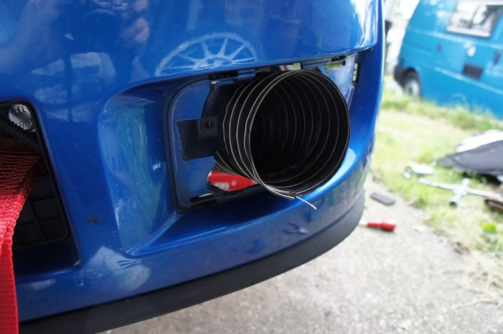

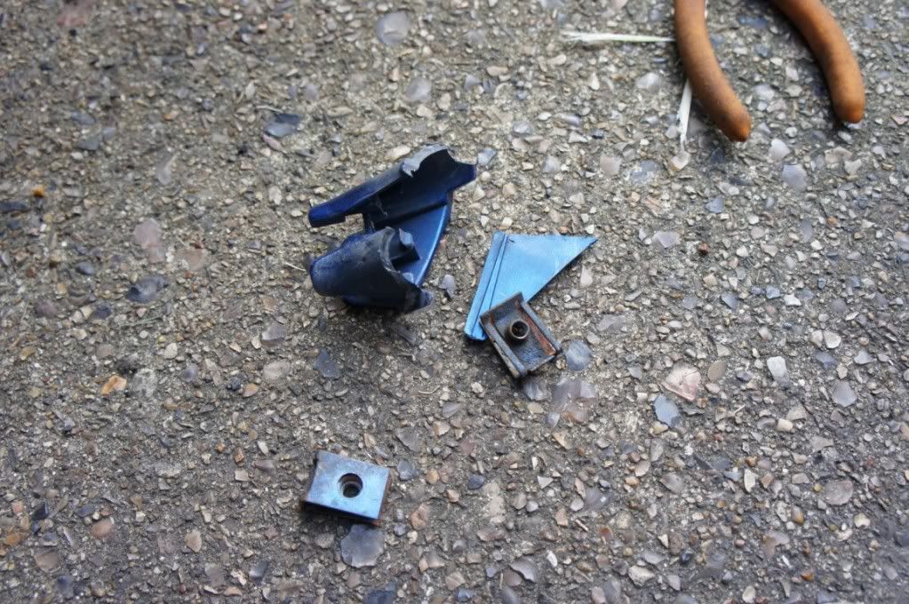

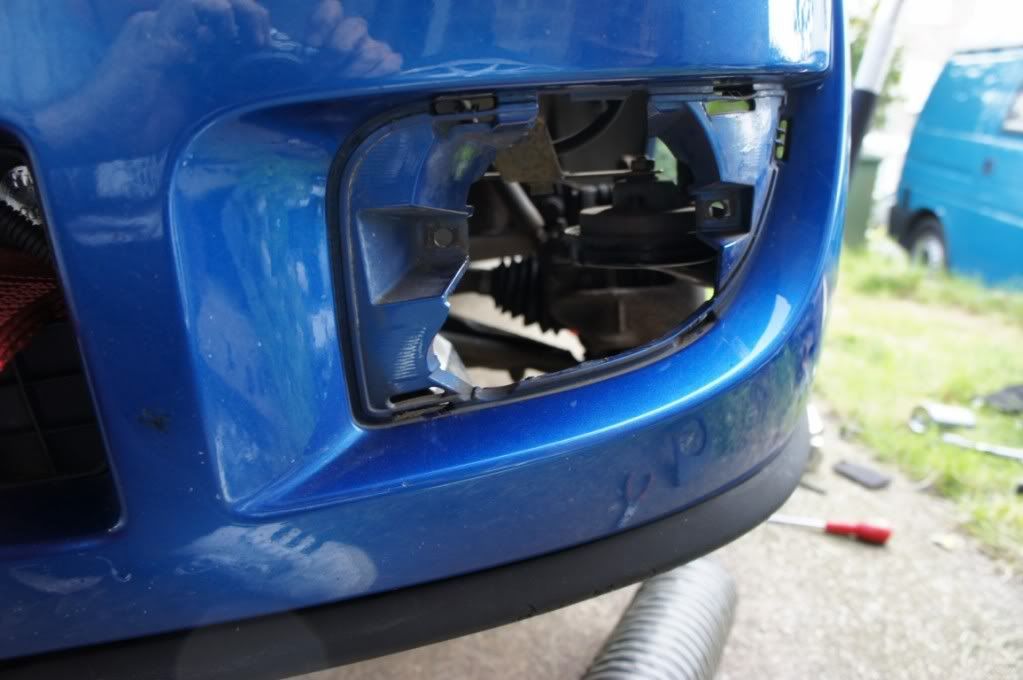

Made the most of the nice brake in the weather and got some jobs done.
Today I added a Nimbus heat shield to the bulk head, this is to reflect the radiant heat from the exhaust manifold from the break lines. I had this Nimbus shield left over from a previous project.
Then I attacked the brake duct cooling.
Removed the fog lights and trimmed some of the plastic mounting away, this fits fairly well and snug.
Attaching the ducting using black cable ties either side using the screw holes for the fog light.
I removed one of two horns and split the bracket, relocating the single horn a few inches higher up to stop it fowling the ducting. The tone of the horn sounds weaker, but will do for now and will still pass a MOT.
Putting the inner wheel arch liner back in, I then cut a 103mm hole and fed the ducting in place and tied it in using 3 pairs of cable ties.
All that is needed now is a air deflector plate placed near the wishbone/suspension strut to deflect the air to the breaks.
