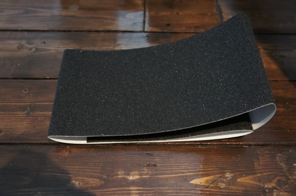

Gripper tape added to driver foot well

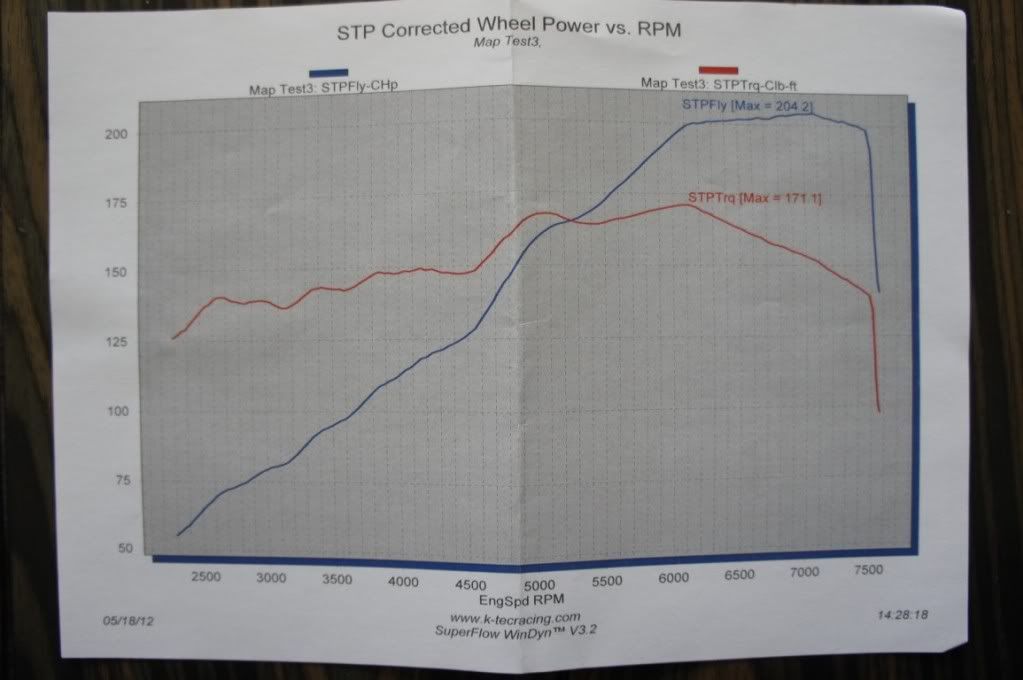

I picked the car up yesterday and was happy to say the least. The car drives and sounds so different and pulls very hard. Im well happy. I also had one of Ktec new panel filters fitted for the ITBs, good bit of kit. The car mad 204bhp on the rollers, Andy seems to think its being restricted somewhere. I am still running a stealth system with cats. I have decided to add a custom tail pipe (cutting a recess into the rear bumper) as this should eliminate the boominess caused by the stealth (and dear I say it an extra ponnie).

power graph

so 204PS at what weight ? 1300?

Cheers buddy...1300? Hell no. this baby is around 950kg now

950KG !!!
feck!
so better BHP per tonne than a stock RS 4 !
