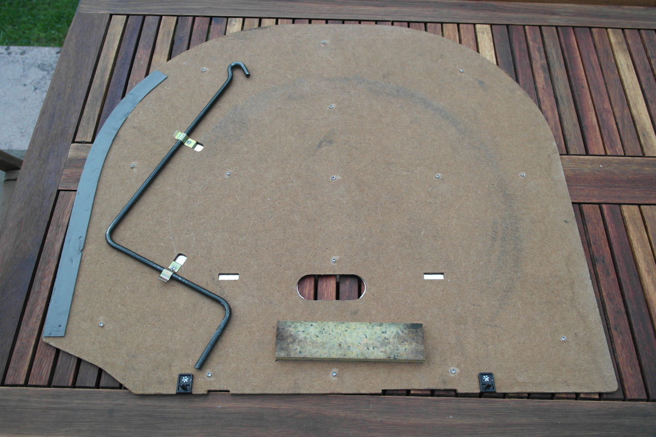

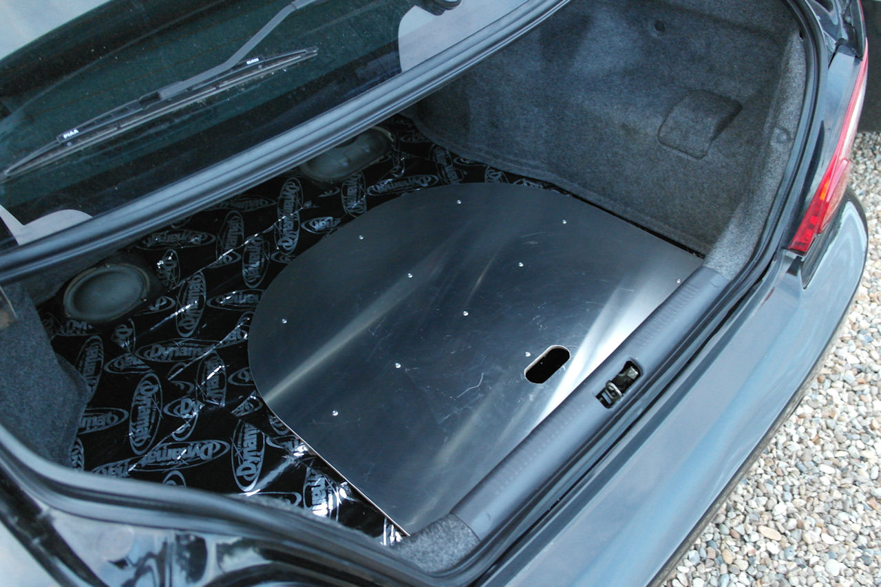

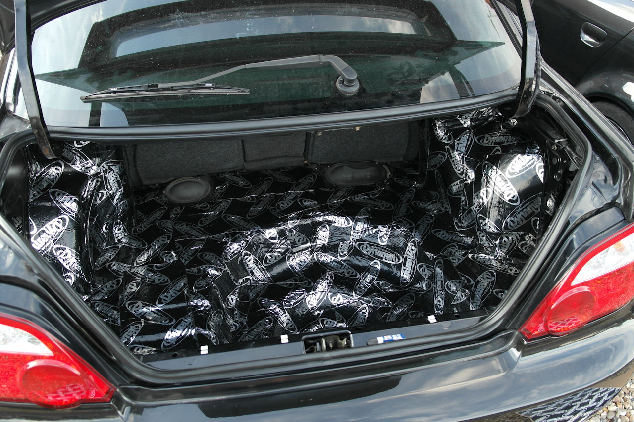

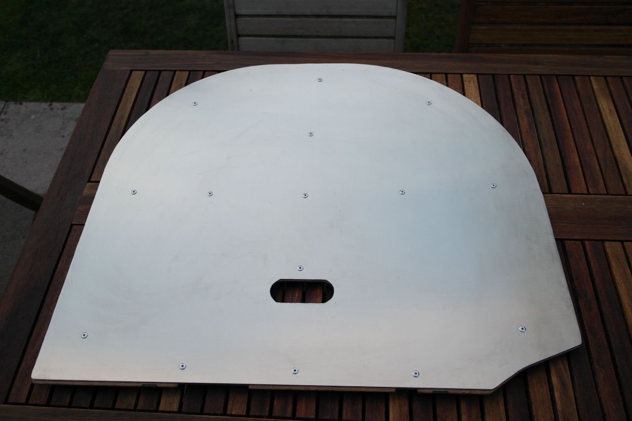

All rust removed from the floor sieve-like leaking boot (there was lots.....). Kurusted for the hell of it and hammerited/ filled in the various huge chunks of missing bitumen-like floor pads with seam sealer that I will sand flat and spray in the morning. Leaks located and new boot seal arriving tomorrow. After I repair whatever other rust damage I find under the old seal I will apply Carafax IDL 99 to the inside of the seal and I have the rear clusters coming off for the same treatment as well as figuring out why one side isn't fitting as well as the other, will bodge accordingly to get a spot on fit.
Dynamat xtreme kit will be here tomorrow with enough to totally deaden the whole boot and will take up the floor again and fit whatever is left under there. If noise persists I will deck out the boot at least with Dodo Pro Barrier MLV on top of the dynamat xtreme but have to watch the weight. Chopping up the roof to fit the DAB aerial this weekend in theory since I have installed the other DAB bits. Almost bought another head unit for the hell of it tonight but resisted...
Looks like I have managed to source another mint headlight so will be cooking all 4 of them at some point to swap the covers and blackout the lens surrounds at the same time. Man, I hope to god the end performance makes all this worth it.

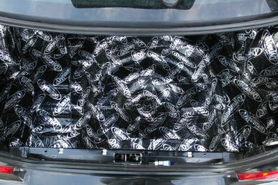

Waffle time again. Under the bootseal was a Pandora's box of horrors. Multiple perforations and rusted through holes in the turned up metal that the seal grips to, surface rust throughout the layers between the top metal under the rear parcel shelf and the main boot roof layer. The seal metal was fairly mangled in places where the metal looked like it had been randomly attacked with pliers and twisted in various directions. Straightened this all out and the places where the seal metal obviously wasn't following the best directions to follow the bootlid as it closed.
Found 3 small gaps (sub 1mm gaps but gaps none the less) between the bodywork panels where they were spot welded together by the seals where water ran past/could build up, were enough to let water in. I dremeled every single bit of rust on the seal metal, holes/damage, then kurusted it all and painted when ready. For the panel gaps I soaked kurust through them then once cured, sunk super glue in to make a waterproof seal of sorts before painting over to complete the seal. After heat drying the glue the seams look flawless, painted over perfectly and totally sealed.
These sound like bodges but there wasn't anything better I have used in the past for minute jobs like this and the end result looks factory. For the seal metal where it has been perforated/rotted (the metal is 1mm thick if that), I have sealed over those with some special aluminium tape I have, again, sealed with superglue to ensure a permanant fit and painted around the edges. Adds virtually no extra thickness to the seal metal and does the job perfectly, will ensure that the carafax sealant doesn't have to work too hard to keep a waterproof seal for the rest of the life of the car.
Bought another pair of headlights in the end so I am spoiled for choice and at least if I bollocks up the first pair I swap/black out (lens housings, not the actual lights), I have spares... replacement rear parcel shelf bought to replace the tatty, drill-holed for no reason rattly one that is in there and managed to source the rear wash spindle cover too. Again, this car had better be worth it.
If this was the 6 then of course I would be doing things differently but being the 4th one of these bacofoil buckets I have owned, I know what works and what is overkill. The bodges above will work perfectly and nobody but me would ever know. I do really wonder what the hell was going though the heads of the previous owners though when they did the various things they did to this car.....

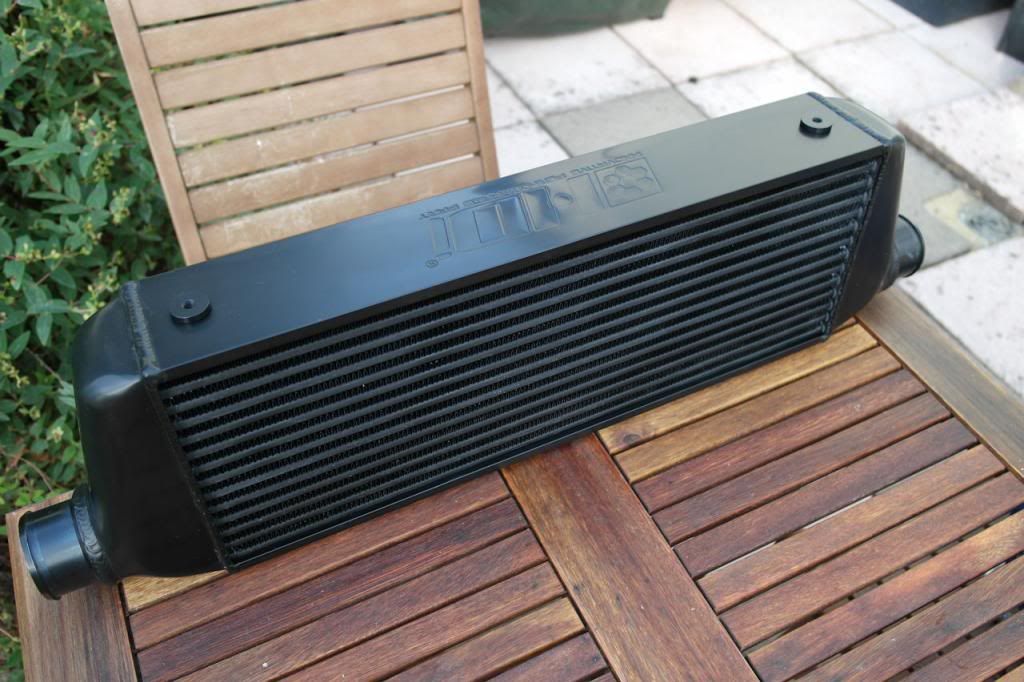

Last update from me for a couple of weeks as the Pooperu goes off to the tuners again tomorrow morning for:
Ripping off the new Hayward & Scott system and fitting a new full Milltek system with downpipe
Fixing compu-diff system they broke when changing the clutch
Fitting that bootiful HDI black intercooler
Remap number 2, factoring in all the lovely new things the upgraded ECU can do
Anyway, apart from pesky clients calling me and having to take work breaks, this has been the last 2 days of my life, including carafaxing the new boot seal, leak testing: I started off with nine sheets of Dynamat xtreme to try to dull/kill off some of the fecking exhaust noise/other noise. Far more than I should have needed for a boot but due to all the nooks and crannies, I ended up using 7.5 sheets of this heavy stuff and that was with very accurate placement/overlaps. All inside the wings etc done.
I decided that this car would always be a fat bird unlike Fluffy so I have given up on trying to keep the weight down, I will just offset it with more power. I was sick of the saggy balsa-tastic wheel well cover so I got a 2mm sheet of Alu and made up a toughened version so that you can actually put more than a potato in the back without the thing buckling: After all the flaff with making up the double skinned, toughened interior boot panels, the anal dynamatting, the toughened cover, putting the mats back in and cutting them to factor in the different trim panels, I can't tell any difference in noise levels inside this biscuit tin. However, that was just sitting on the drive.
When I refitted the upgraded ECU I did a load more soldering/cable tidying and as an end result, the anti-lag is working far better when I enable it, quite amusing in a very chavvy way.....

Lol. Well worth it then.Mr Footlong wrote: After all the flaff with making up the double skinned, toughened interior boot panels, the anal dynamatting, the toughened cover, putting the mats back in and cutting them to factor in the different trim panels, I can't tell any difference in noise levels inside this biscuit tin.
That is one freakily psychedelic boot lining.

Tuners told me that in their opinion, the far more expensive HDI intercooler I went to the trouble of anodizing blackwould be a step backwards in performance to the cheaper silver POS slapped on the front of the car. Agreed to disagree but am going with their judgement. I told them that one way or another that car wasn't coming back to me with a silver intercooler so they were to take the front off anyway, tidy up the bumper pipework cutting and sort colouring the silver monstrosity for me as I had done my part....
The previous owner/tuner has done such a fecking butchering job cutting out the front bumper to fit the FMIC as I suspected from checking it myself, that the fog light hole covers that never stay in place properly, never will of their own volition. I have told the guys that as long as they have done a bang up job with the FMIC seals, there should be no reason to have to remove them so just bond the bastards in place as long as the bodge can't be seen. As the front is held on by hardly anything, if I ever need to alter something I can have the front yanked in no time at all.
