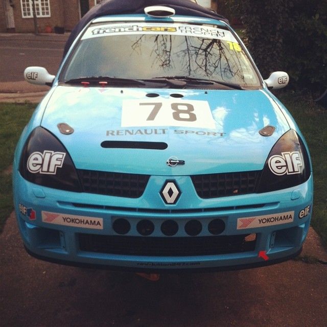

Took advantage of a break in the weather this week and removed the gearbox from the car. I decided to lift engine and take box out rather than dropping the sub-frame.
Dropped box off yesterday with Matt at CodeRed (Sevenoakes)to inspect the box, as I couldn't select reverse gear due to me hitting a high rumble strip at Donington in last years Track Attack race. I am also having the closer ratio 5th gear added.
Im getting good at this, done this in less than 4 hours and on my todd....
Re: Clio 172 Cup, track car to race car
Update March 2014
Ok so we are back on track....
Picked up my gear box yesterday from CodeRed, box needed opening up to investigate why I had lost reverse gear (due to the knock it received at last years Donny race), after a lot of time and effort my Matt, replacing parts and stripping and assembling the box together he finally found the problem, we initially suspected a damaged selector fork but it turns out to be the spindle that the gear-set is on..so he replaced the whole gear set with one of his spares. (maybe Matt can explain more on findings).
He had found my 4th gear to be burred around the edges, this must have happened on the race or at the 2 test days at Spa (car had only seen 3 track days).
Service from Matt has been second to none, so many thanks Matt.
I was due to have the 33/37 ratio gear installed, the parts turned up, but the box had been packaged up incorrectly and was supplied with a 39th 5th gear....so without wanting to waste any time, I took the box away to install on the car, while Adam sources the correct part.Bit pissed off, but such is life.
So today I popped the box back in, car now has a lightened flywheel and new clutch. I still need to plumb the rest of the coolant system in along with the drive shafts and wiring etc, I ran out of time before having to start work.
So only jobs to do, is to install the new year discs and pads and cut the grooves into DS3000 front pads and we are good to go.
I have a test day booked at Rockingham next week on the 20th March, so looking forward to that.
