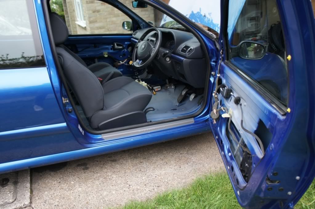

Been very busy working on the car over the past week to get it ready for the Summer track day season.
Last week I started to strip the interior out of the Clio. The front seats are staying in until I find a sutable set of frames for the Pole Positions.
Removed all this rubbish, shed about 50kg of weight.
Now looks like this.

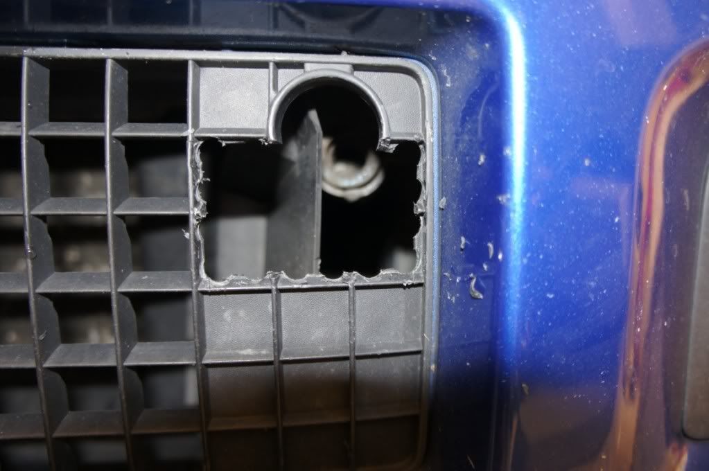

Next was to put a TSR tow strap on the front, this needed modifying slightly.
Cutting out the front panel
The hole is needed to be filed to fit the M16 X 50MM tow bolt
Finished product, I may however swap this for a 100mm bolt so the tow eye is more forward, this would stop the bumper cracking if towed from a side angle. (i.e out of the gravel trap)

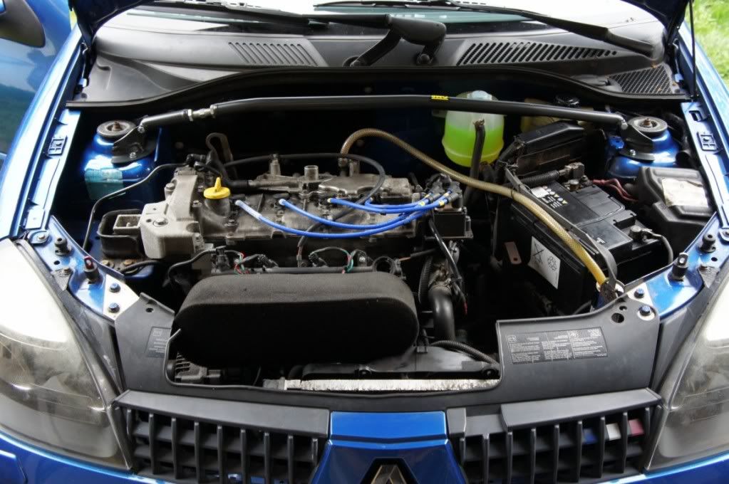

Next job was fitting new spark plugs and 8mm Magnecore HT leads. The car had those silly Bosch super 4s in them...replaced with some NGK performance ones.
Next was to fit a front OMP adjustable strut brace and a new coolant bottle as the old one had seen better days

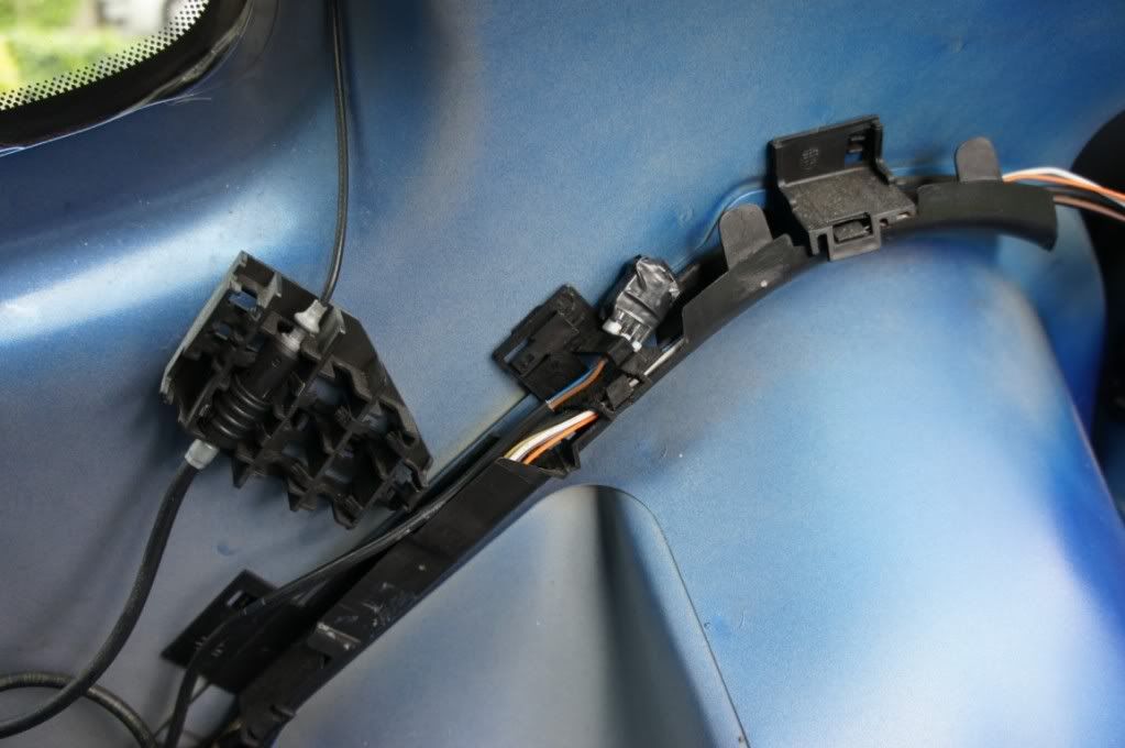

Rear wiper was removed to free up more weight. The wiper was seized onto the bolt so out came the axe saw
Holes was plugged up and sealed with sealent and rubber grommets from Halfords

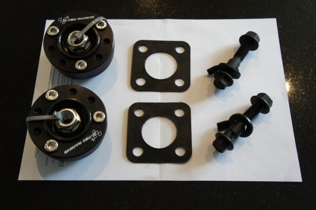

Also to go on are these solid top mounts, rear camber shims and front camber bolts

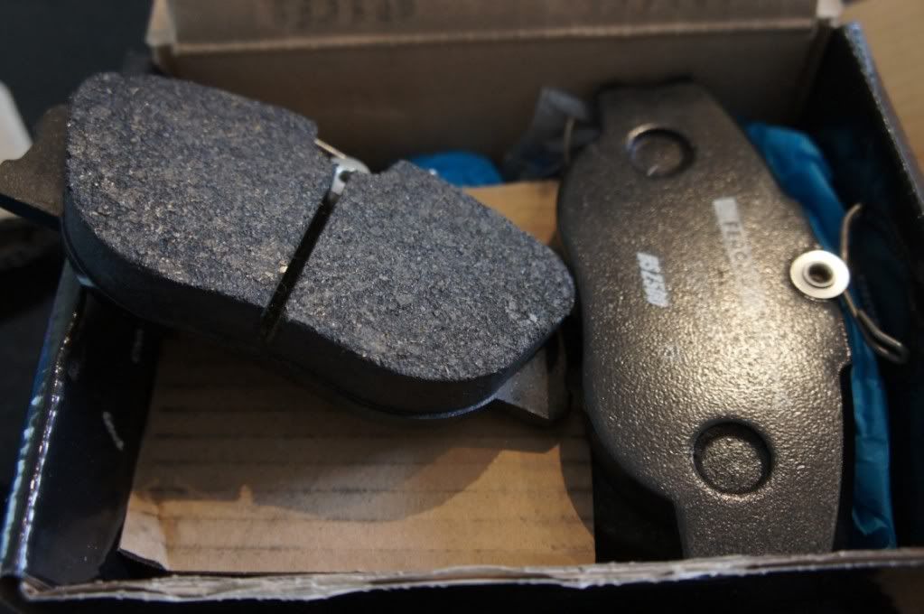

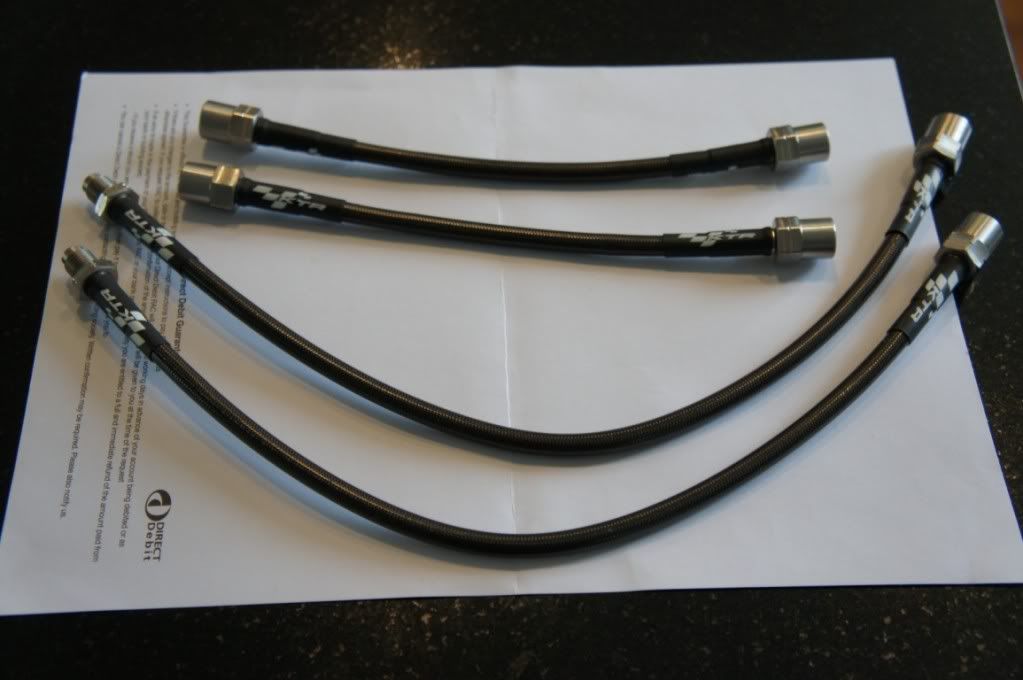

Also braided hoses, DS2500 pads and Brembo grooved discs, these will go on when my RBF600 fluid finally arrives.
