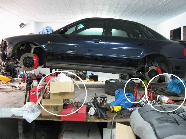

ok guys but is it me or is this car floating in the air
Don't be silly, there's a 5l can of oil holding it up at the back :-)
@ Grizz, you've got damn good eyes, I don't see anything on this side of the rear of the car?

The Box doesn't look right, the line between the axle stand and wheel is definitely dodgy and the rags and plastic bag above the brake cleaner
look like they weren't really there, odd? :?

and the perspective is wrong the tyre must be huge!!

Post by rolskii » Fri Apr 18, 2008 12:39 am
aposegil wrote:damm thin i need to get my eyes checked but did freak me out for a second.
Anyhow more info/pics and why adaptor plate had to be welded on would be great :)
Well either the v8 lump has different bell profile/holes and/or the spigot shaft is too long...... maybe tdiquattro could ask him ...?
... there rs4 uprights on the front susp. only changing the engine not drivetrain layout .. looks good though .. :beerchug:
more pics if poss ..?
happy dayz .... party ....

Post by kostas@aprgreece » Sat Apr 19, 2008 12:17 pm
Hi everybody, first post here, nice to find you.
If you see anything that you don't like please feel free to tell it.
This is an A4 B5 and we installed the RS6 engine. Our only problem is that the front bumper won't fit so we have to make new hood, bumper and wings from carbon.
I will post some more pics in the next days.
