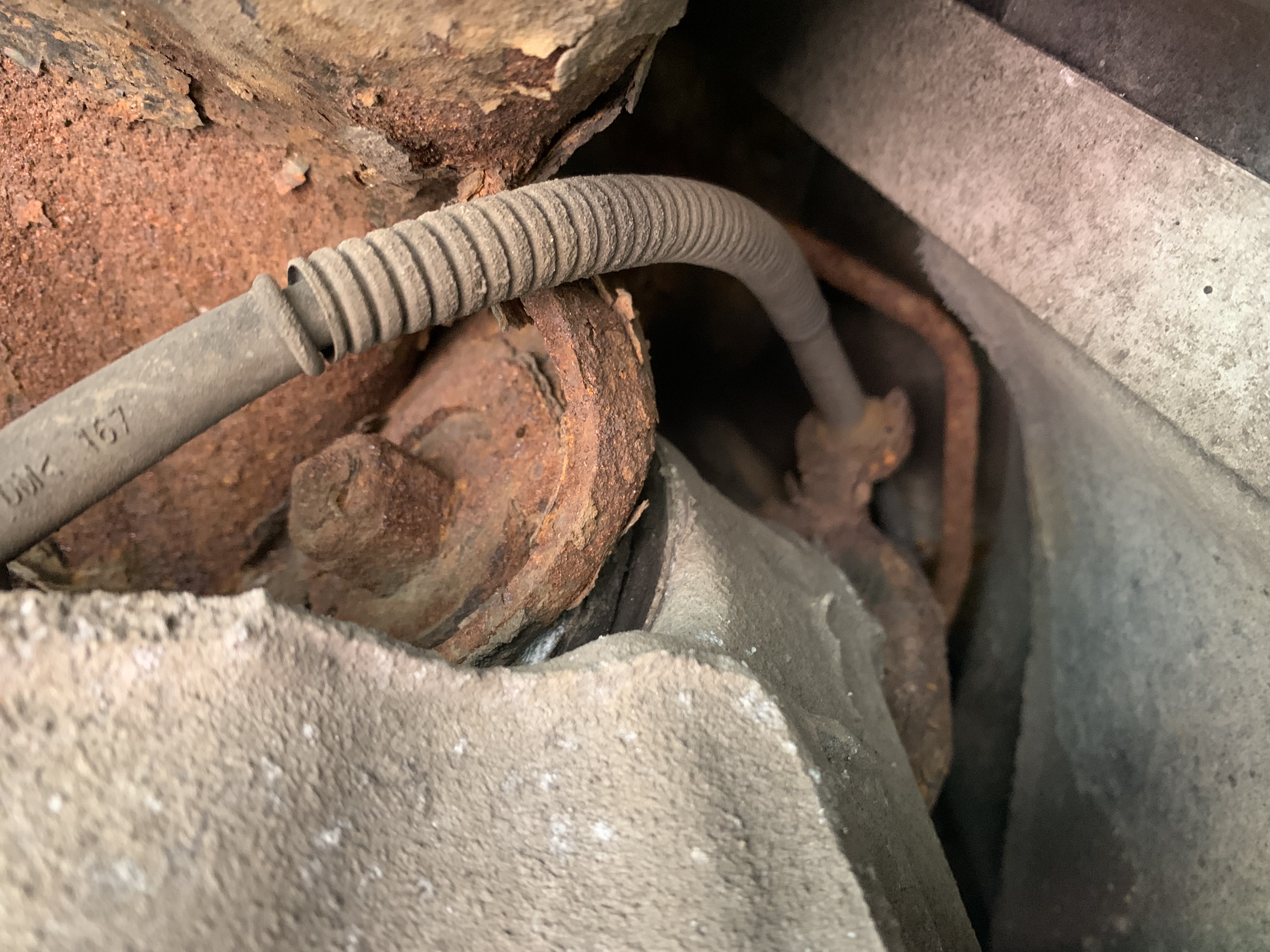

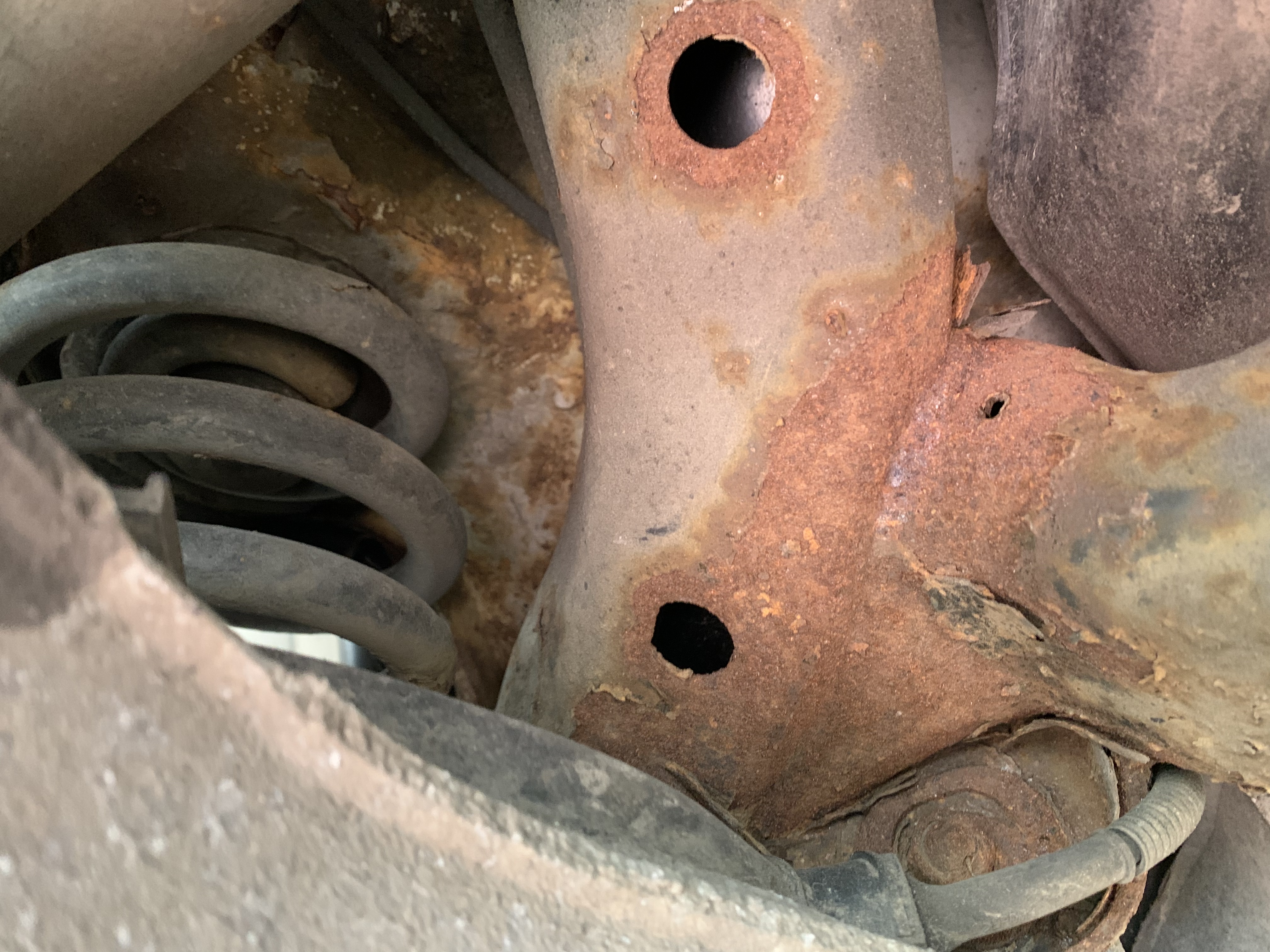

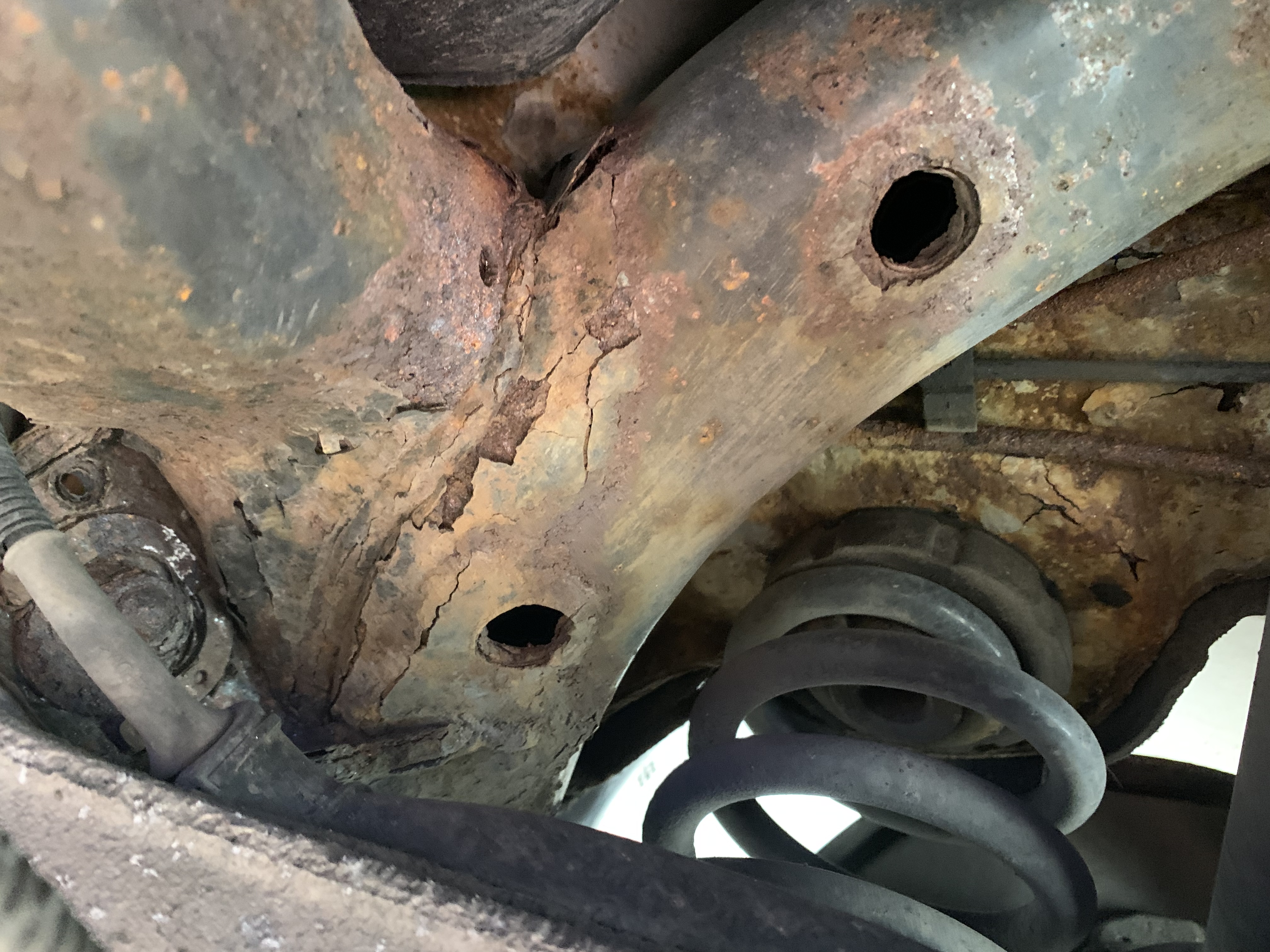

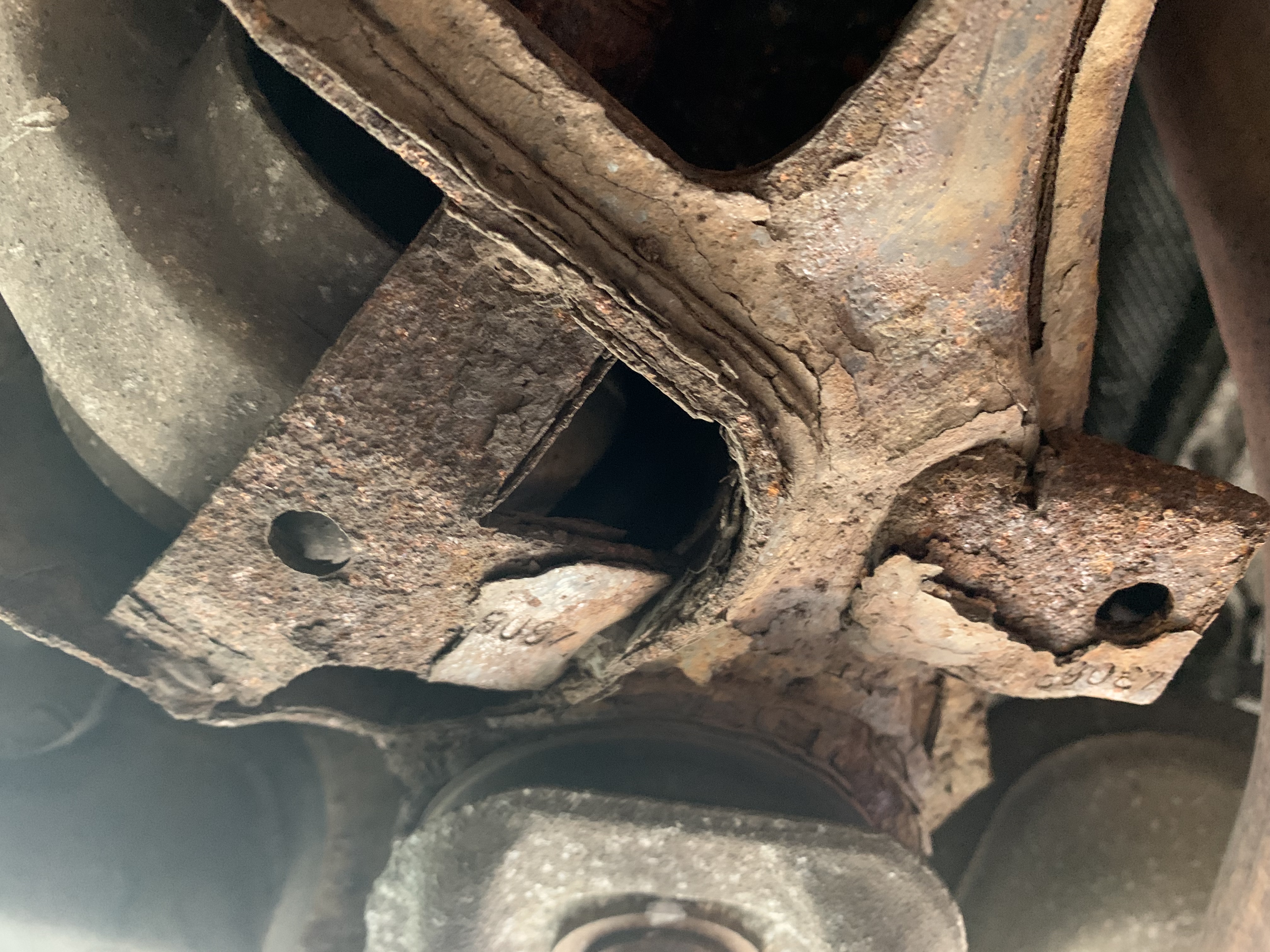

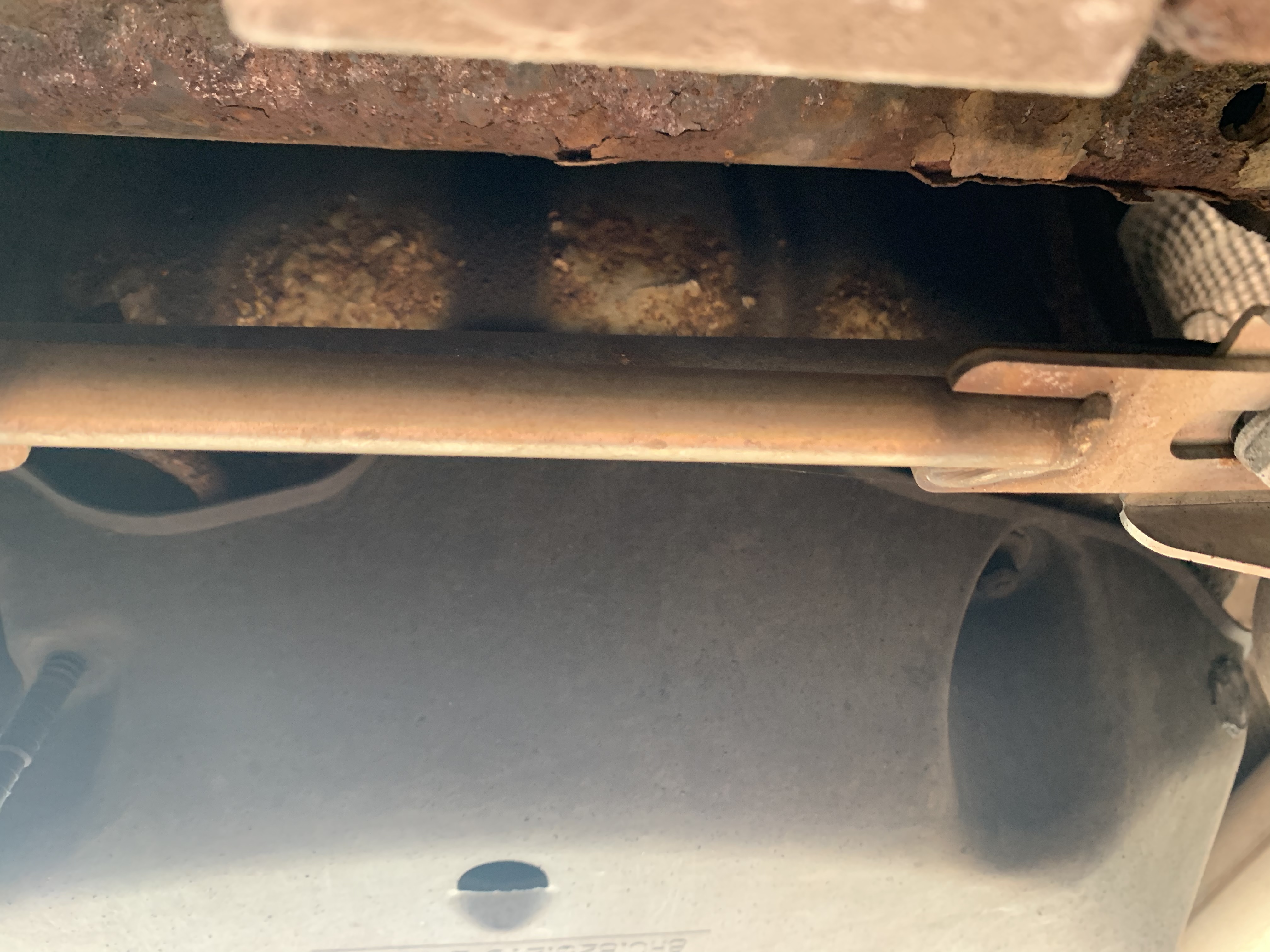

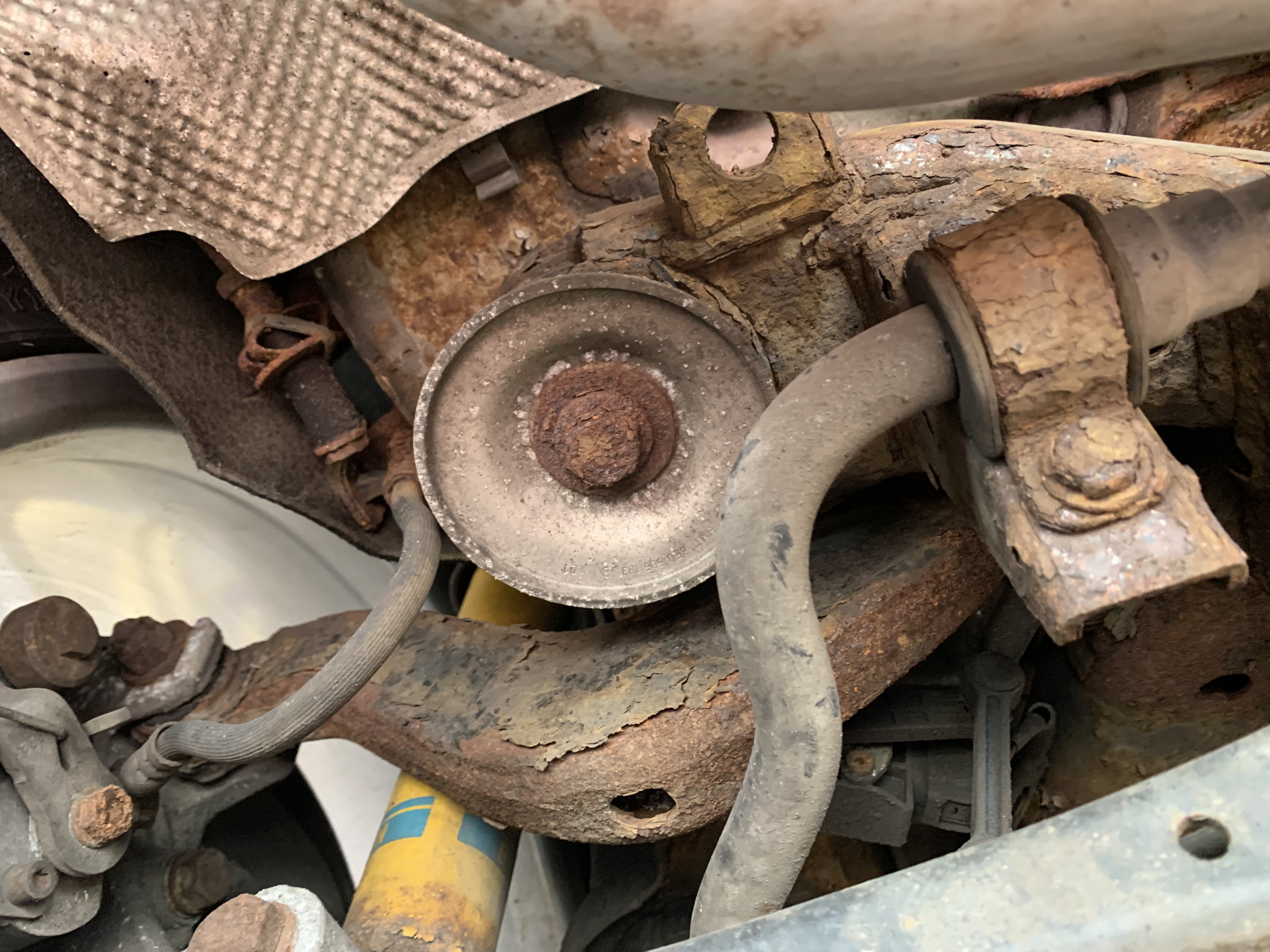

A friend from a forum has recently had a very bad experience with FS Performance, regarding this car:
https://www.fsperformance.co.uk/used-ca ... 5205930156 (it's back up for sale now)
"As you can imagine, I felt pretty ill.
I drove it (f*cking slowly) to my local Audi dealer to see if they could inspect it, mainly so I'd have paperwork to back up these pictures for the rejection process. All fine, Audi booked it in and I drove home.
On the way home, approaching a roundabout at ~35mph the brake pedal hit the floor, tried pumping it, nothing. There were two cars ahead so I banged it into first and let the clutch up, then pulled the handbrake almost vertical. Luckily I stopped with about a car length to go before rear-ending an Astra.
Arriving back home I noticed that the hard line, where it joins the flexi on the NSF had split. Cause? Corrosion. Weird that.
Anyway, the short version is I chased FS Performance for 3 days before any response was given, when I did get a response it was very off the cuff and hardly proactive. Almost like it was my fault. After much back and forth with the "MD" they agreed to waive the usage charge of £1/mile (I did 384 miles total inc 180 back from the dealer!) as long as I paid £350 to have the car recovered. In the ned to get it sorted I paid this but I'll be taking them to court for the £350 plus costs, damages, loss of earnings etc. Tbh I may even press charges for misconduct. I've also raised a case with the DVSA in regard to the blatantly dodgy MOT.
ps. I probably should have had the car fully inspected, I get that. The clean MOT and good rep from the dealer led me down the path and I got carried away. My fault and not one I'll be making again."
Just a word of warning to anyone looking to buy one - swerve this one.

That’s some pretty horrendous corrosion-there is ALWAYS a good case for getting a car up on a ramp and having a good look with a powerful light. Another tip I was told was to look from the bottom upwards at the paintwork-if it’s been resprayed it will appear wavy and therefore one to ask questions about.

I can see why you chose it as it looks great in the pics and there are lots of them as well-normally a good sign.
This is a proper lesson and a ‘Tale Of Two Cars’-the nice clean looking one on top and the horror story underneath.
Every lemon I ever bought (only few) I didn’t look properly (or at all) underneath. Nowadays I insist the dealer get it up on a ramp so you can see. If they refuse that’s telling and a massive red flag.

Yeah - sorry this wasn't me - however as you say - it's nice and clean from the outside, so you would never expect to see something that looks like it's been sat at the bottom of the North Sea.

Has anyone got any ideas how it could have got that bad? Salt corrosion perhaps from being based near water/the sea? The rest of the car looks in good order-whole thing stinks of dodginess.
Truly horrific.
Truly horrific.

Re: Do Not Buy This B7 RS4 - FS Performance
Yes defo salt corrosion by being near the sea.

Just to let you all know, this car, RS04 LEO, was sold again by FS Performance recently and has been rejected again by the new owner due to the various issues, not to mention the rust underneath!
They have slapped Lanoguard all over the bottom of the car to cover the rust, and supposedly then put it through on a dodgy MOT.
Avoid RS04 LEO if you're in the market for a B7.
