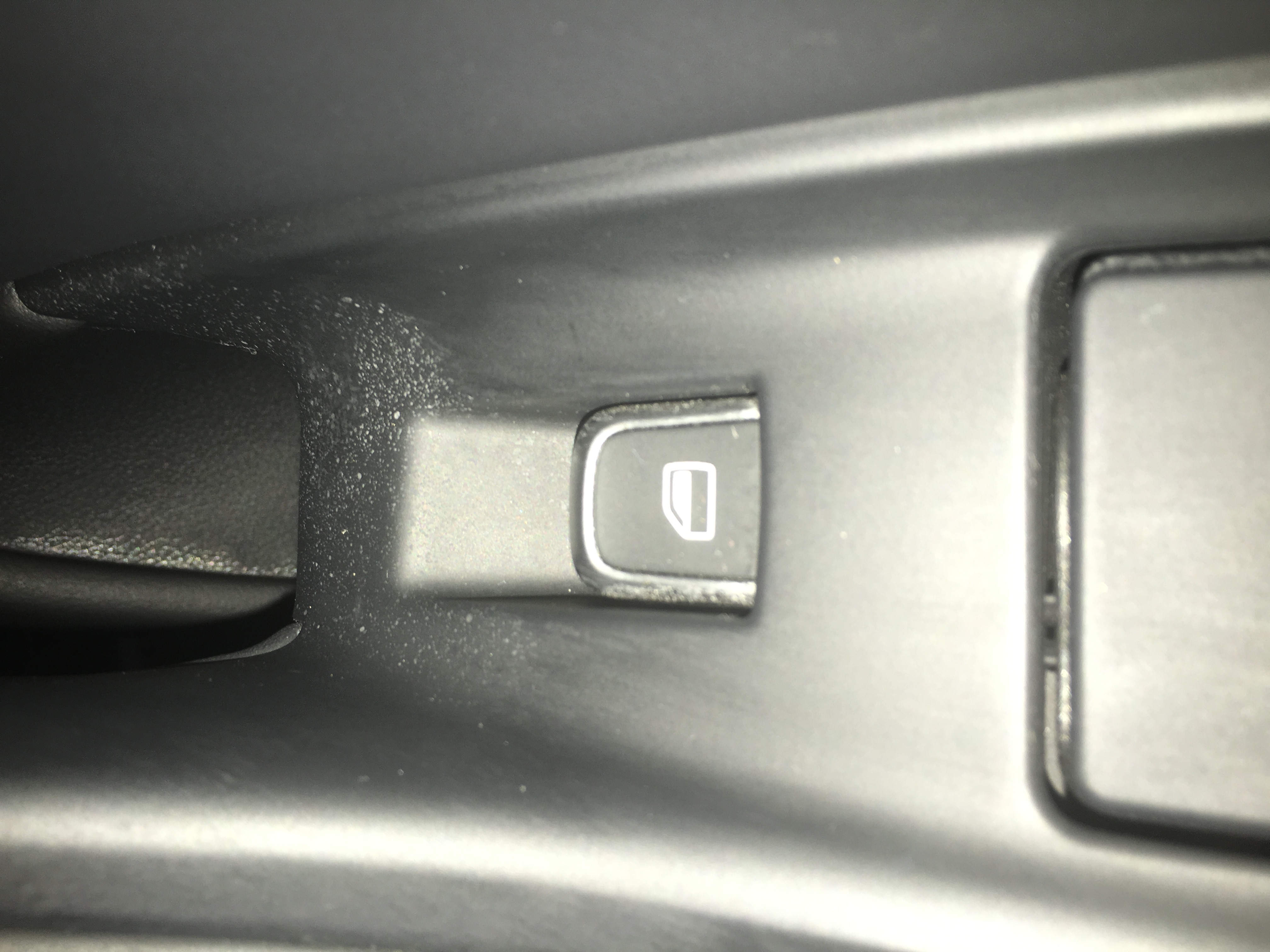

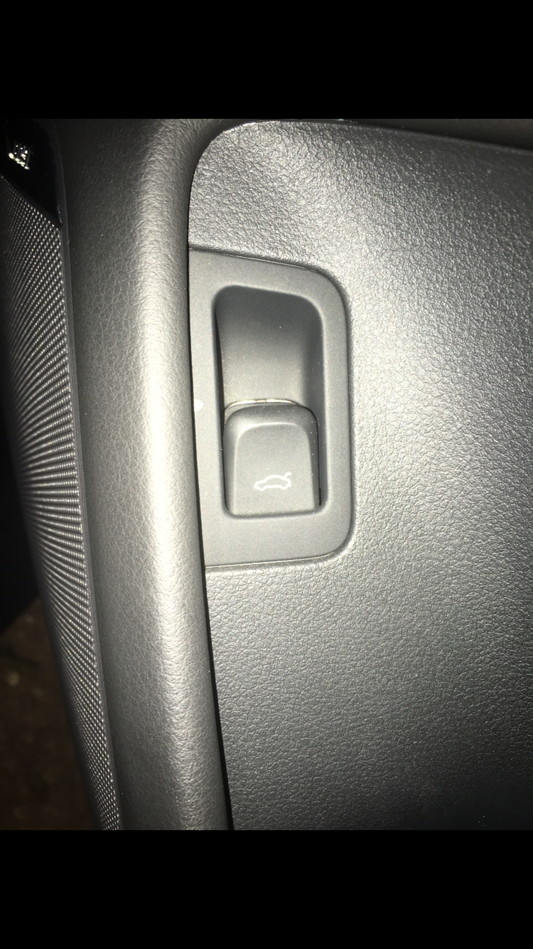

interior open/close boot button (RS6 C7)
Anyone done, or able to do?
Run a cable from interior button to boot button on drivers door, that enables the boot to be closed from the driver's seat?
Looking at the button, it looks the same as what's used for the windows (albeit with a single switch, unlike a two way switch window switch).
I'm sure it can't be that hard a job for someone in the game, although a little over my head if I'm being honest.
Thanks in advance
Thanks in advance
Re: interior open/close boot button (RS6 C7)
Are you sure this is about the C7? The window switch is nothing like the bolt switch.
Well bugger me, you are right. I didn't believe you still, had to go and check.
However, is your goal to close the boot from the drivers seat? If so you can do that with VCDS, no need for another switch. You can do it from the remote too. Although it won't close the boot from the drivers switch when the ignition is off, but a short press of the key fob will close it, or turn ignition on then press door switch.
