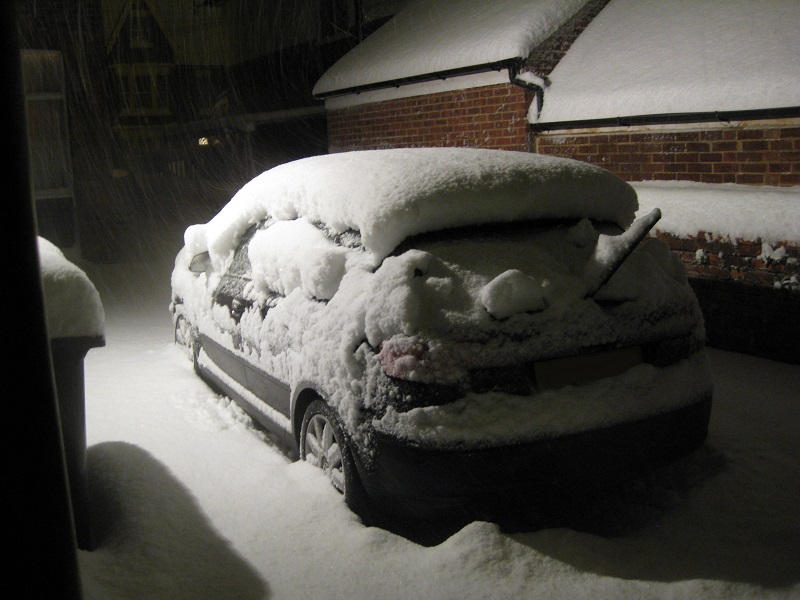

Yeah there's a small spring in there to hold it up and straight and level, dad replaced his (Sportback) after snow weighed it down, dealer said very common in snow, one guy had been in three times that winter! Flip your wiper up when snow is forecast / falling for this reason....
