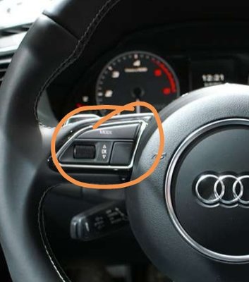

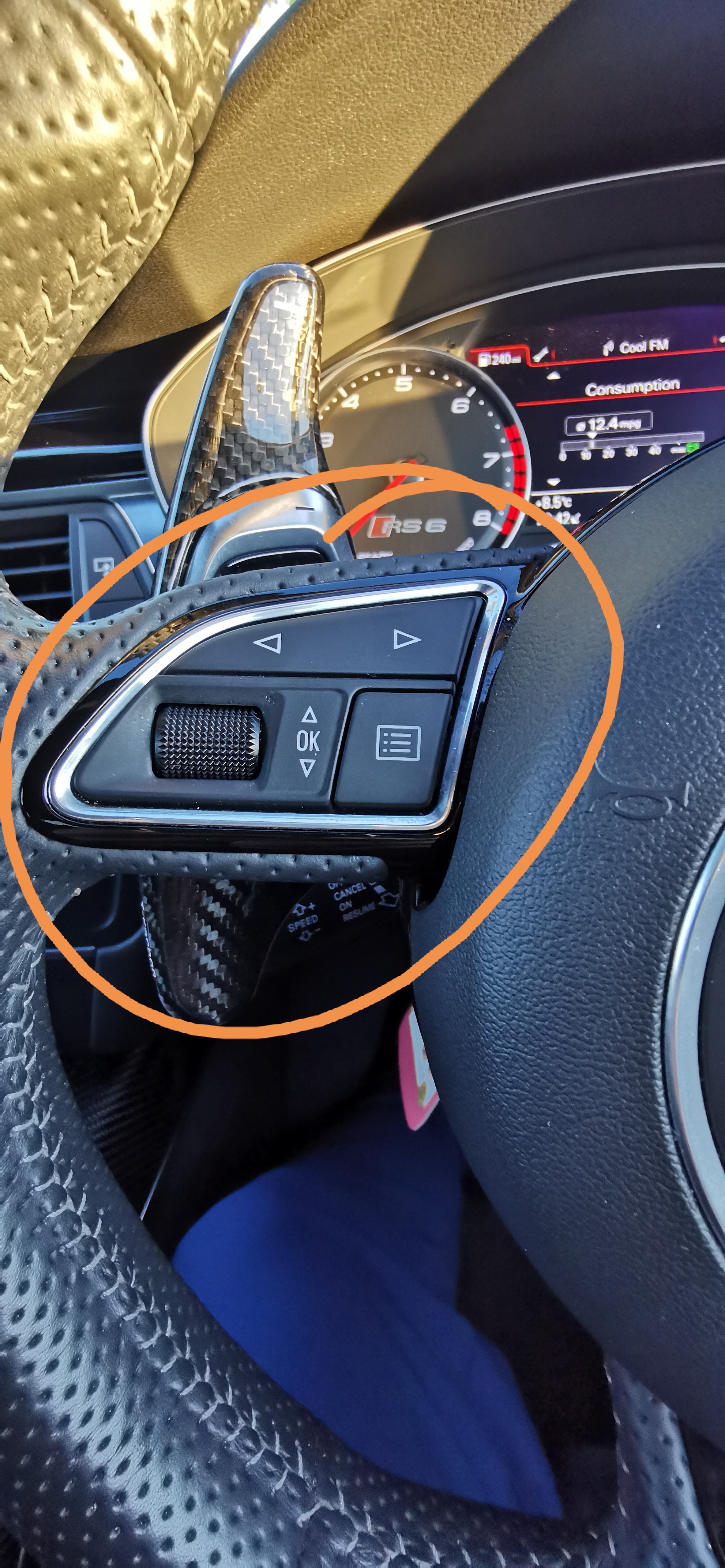

Just a quick question regarding a possible steering wheel swap.
I previously had a 2016 SQ5 with a carbon steering wheel fitted. I took the wheel off when I got the RS6.
What I'd like to know is; would the wheel fit the RS? Airbags are the same size, only difference would be the direction button on the left. RS has left and right arrows, were the SQ5 didn't.
Any help be appreciated.

As you can see, the buttons on the wheels are slightly different but the airbag and paddles are the same.
SQ5 wheel
RS6 wheel

You will need the menu button in order to access the menus in the cluster. Its a different part number from the rs6 to the q5 platform. You can remove the buttons and see if it fits to the sq5 wheel.
Also you need to check if your sq5 is a dual stage airbag or single as the rs is dual
RS6 Performance Ascari blue, Carbon Ceramics, Akrapovic, H&R Anti Roll bars

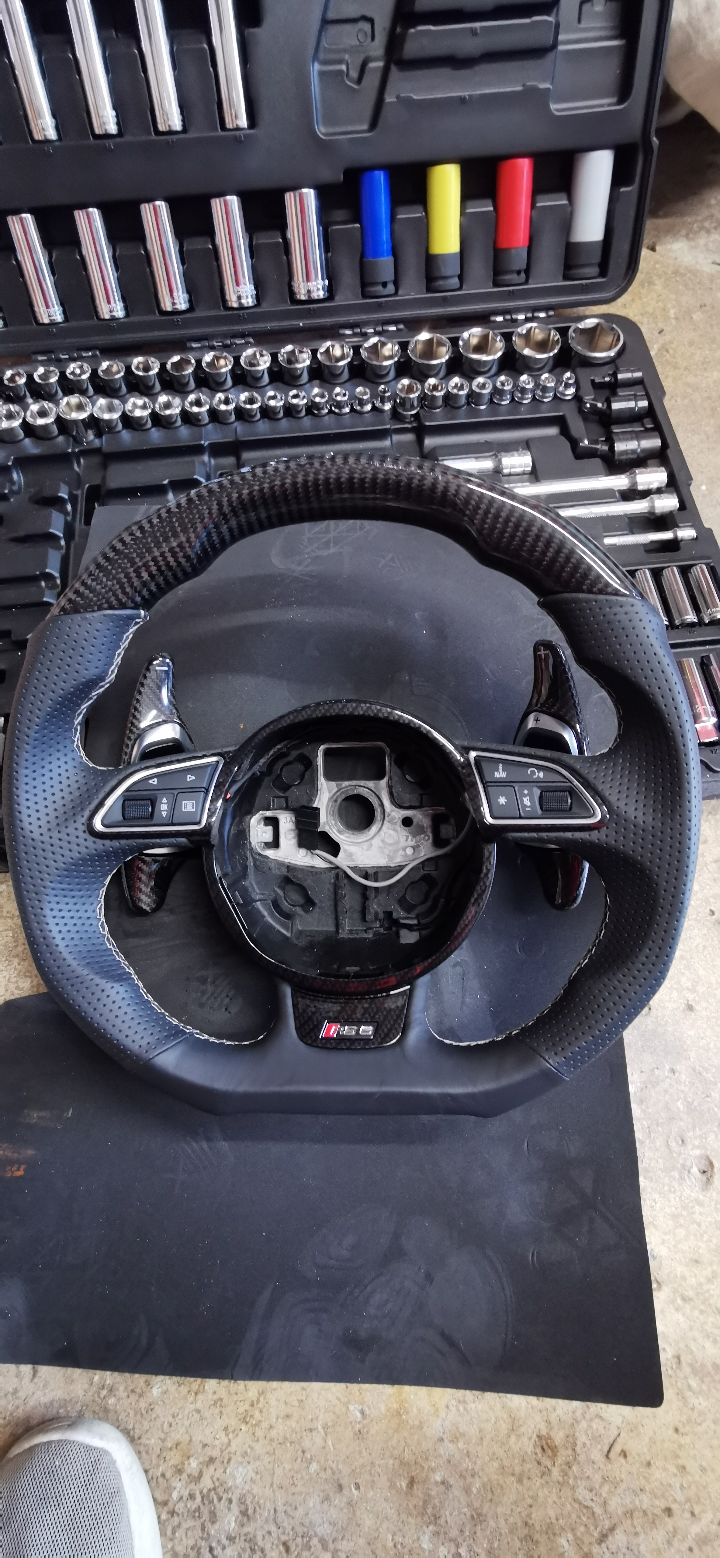

Post by Asian Panda » Wed May 13, 2020 9:21 am
Got it sorted. All worked out :jump:

Post by morski » Wed May 13, 2020 11:41 am
Thats some serious meat in your hands!! Glad it all worked out
