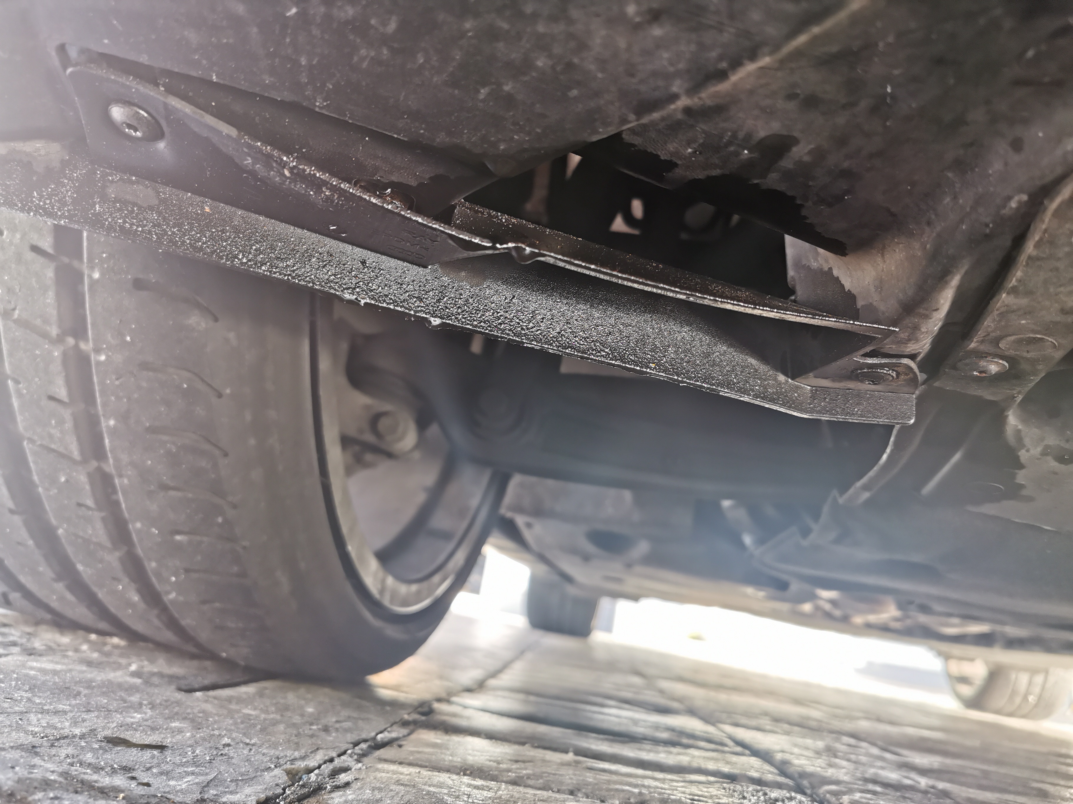

I've just noticed I have an oil leak. Under the front drivers side I can see it coming from by the undertray. I can't see much but looks like it's by the intercooler maybe??
I'm hoping somebody has had this trouble before & it's not too serious. It's only got 19000 miles full Audi SH. Only had it a week & love it, actually making me feel sick now.

My guess would be indeed the oil intercooler, since it is located on that side. It is an oil to air intercooler, meaning the oil is actually running through the (small) intercooler). Most likely it has a pucture. Couldn't be a leaking clap or hose but don't think that is common...
Definatly wouldn't drive it any more and make an appointment. I don't suppose you have dipstick to check oil level (might aswell order one for the future) as now you have a safe way to check your oil level untill engine is warmed making it dangerous driving the car (even to the dealer). Judging by the coverage it looks already a decent amount of oil leaked out. Maybe better tow the car on flatbed to garage to be safe.

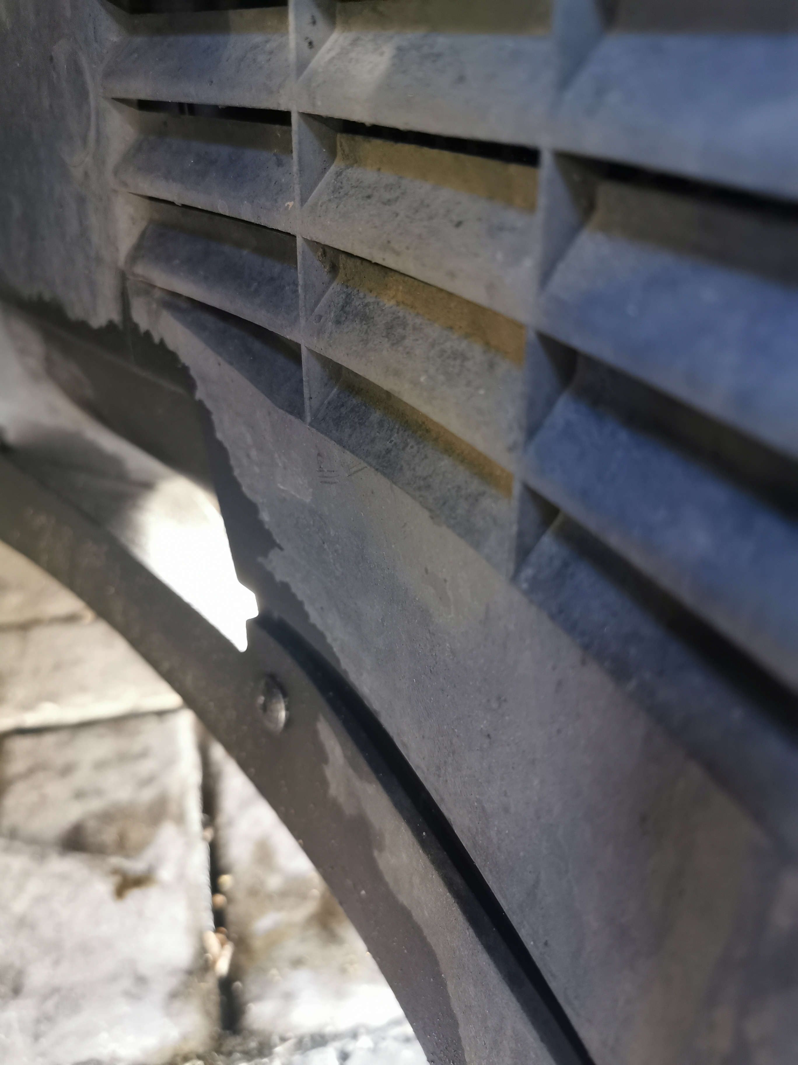

I'm not sure. I'm gonna jack it up & remove undertray & arch liner today & see if I can find the source.

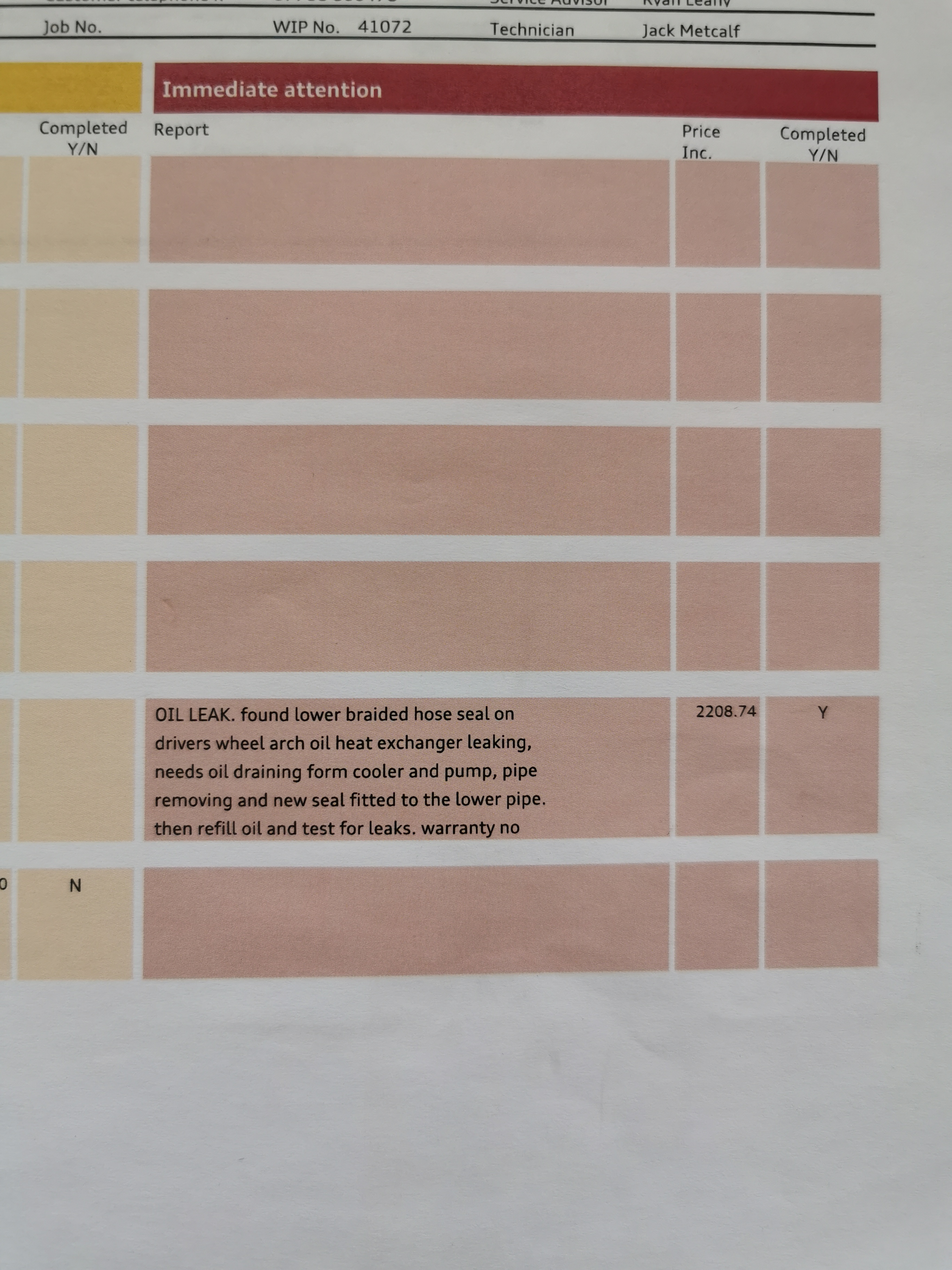

In the meantime I found this in my paperwork
I phoned the previous owner & he told me he had the same oil drip from the exact the same spot & Audi replaced the seal in September so hopefully its still under warranty if its the same leak. Fingers crossed 🤞🏾
