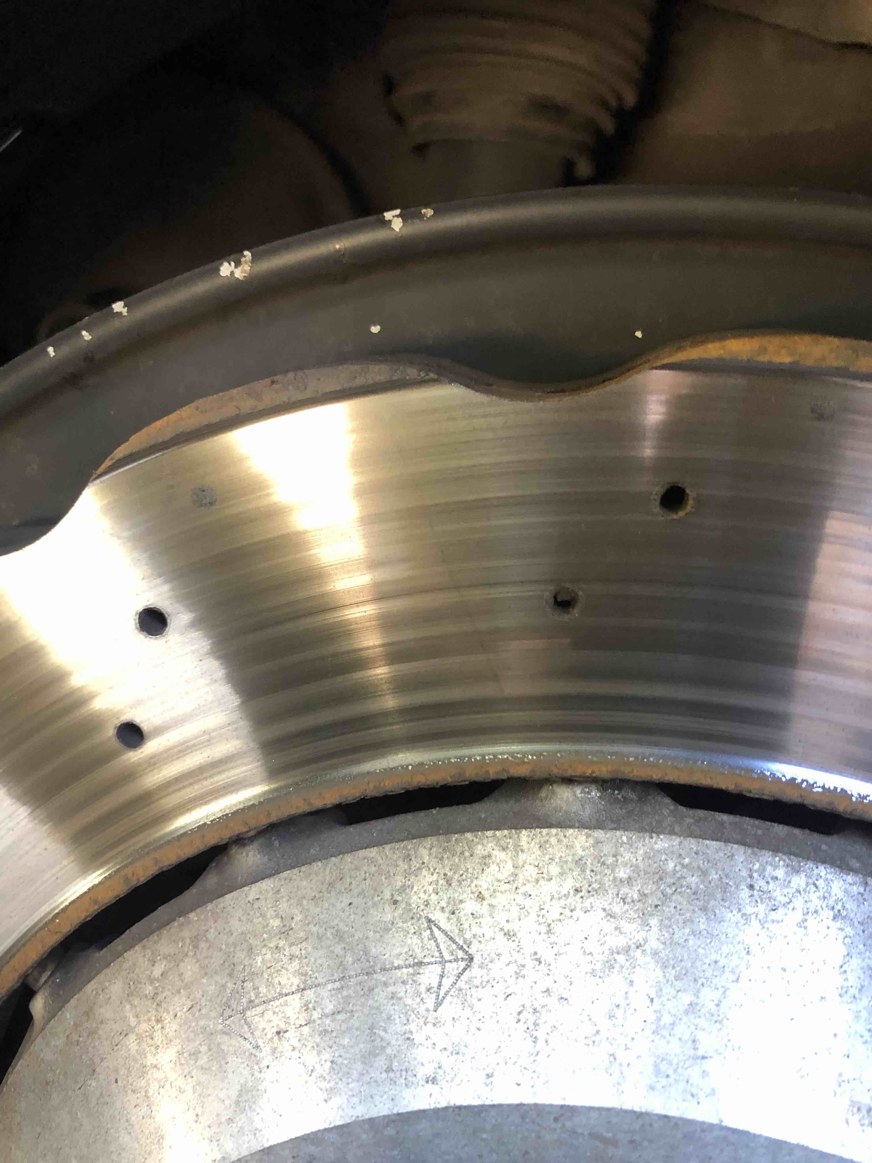

Hi All,
I've attached some images of my brake discs and want to know everyone's thoughts on the wear pattern and level of wear to the discs. The reason for asking is that I've recently collected the car from Audi Used Approved and I had 4 shock absorbers failed after one week. I've been disputing that the 145 point check was not carried out correctly for all 4 to fail.
I don't know what Audi should do when it comes to used approved with regard to brake discs and level of wear. It looks like about 1-2mm of wear and the surface doesn't feel perfectly smooth. I'm sure someone will tell me that this is even wear and within limits but with everything going on at the moment I'm clouded in doubt.
Any advice would be greatly received.
Cheers guys!

That wear pattern looks normal to me (same as mine), but you would need to have the discs measured too see if they should be changed or not. The tolerance measurements are stamped on the disc. You could go to any garage and they should be able to measure the depth for you with a 'vernier caliper' or the like...

To be honest they look ready to be changed. How many miles has the car done?
On my B8 RS4 I got 30k out of the fronts and 38k on the rears.
You really need to measure them to check.

The top disks...the outer 'not fully drilled holes' are the wear indicators afaik. Once they are flat, like in the top picture, they are bound to be replaced. At least that is what i recall on my RS disks i mounted on my A4 B8. But i also think it is best to replace them per axle...so both left and front.

They are all past the wear marks so all need replacing as under the minimum thickness.

It turns out that on closer inspection the front discs were worn to their minimum tolerance of 34mm. The rears still have 1.6mm of wear before they hit their minimum. So they are replacing the front discs and pads.
Still baffled how this was missed in the 145 point check (along with 4 failed shock absorbers - see other thread). I only had the car 11 days before I reported the issues.
