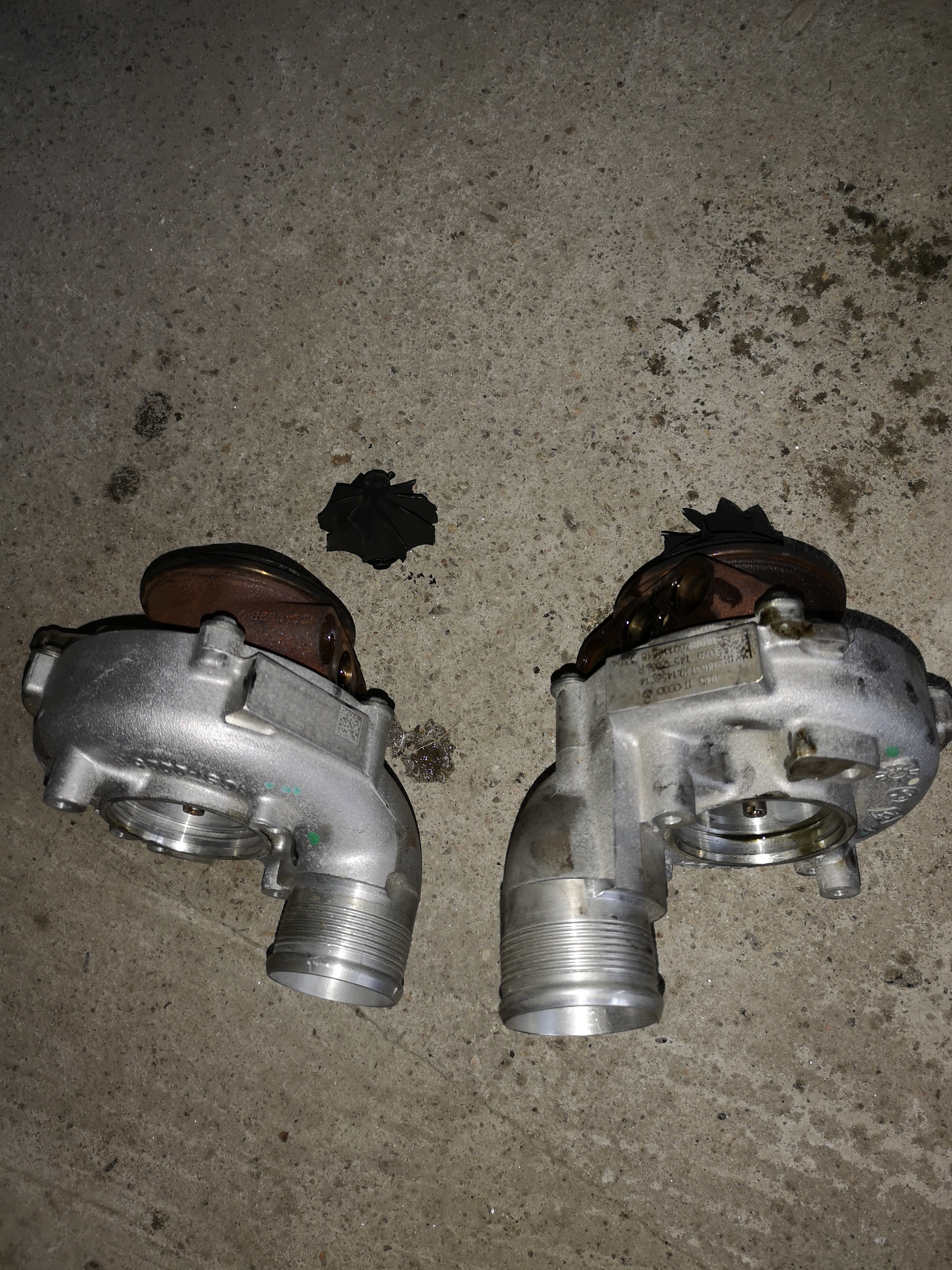

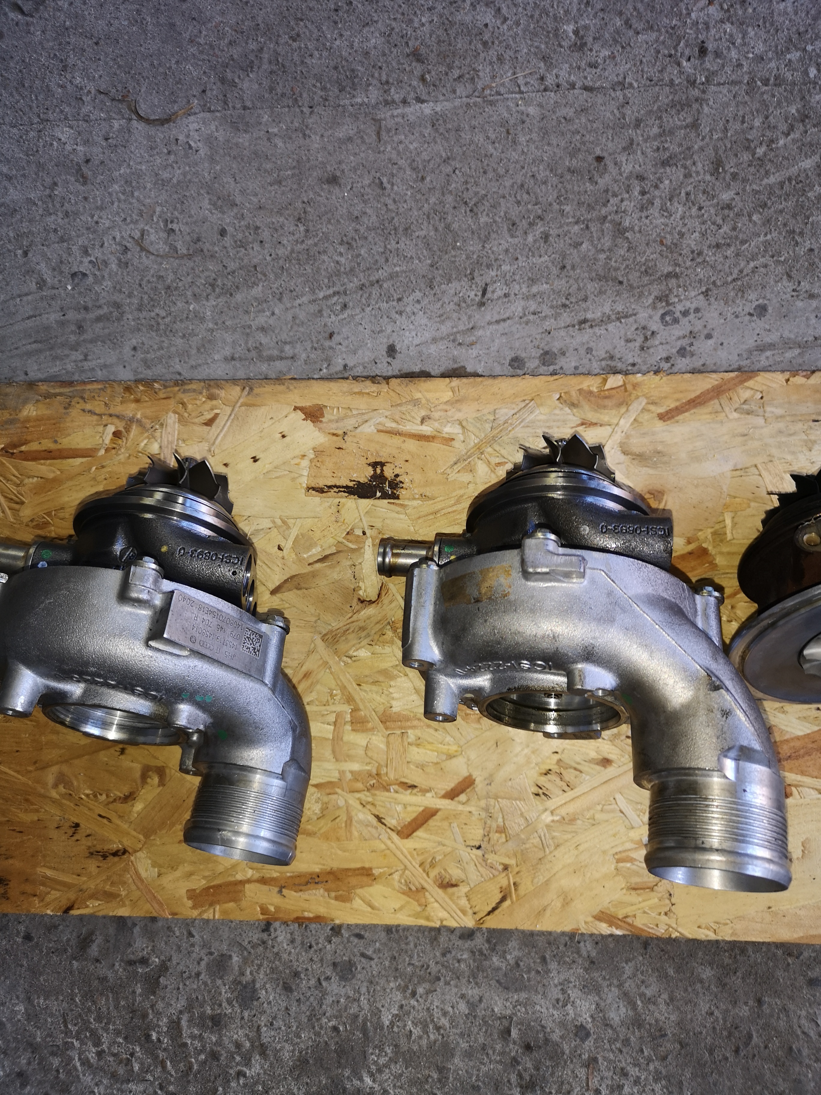

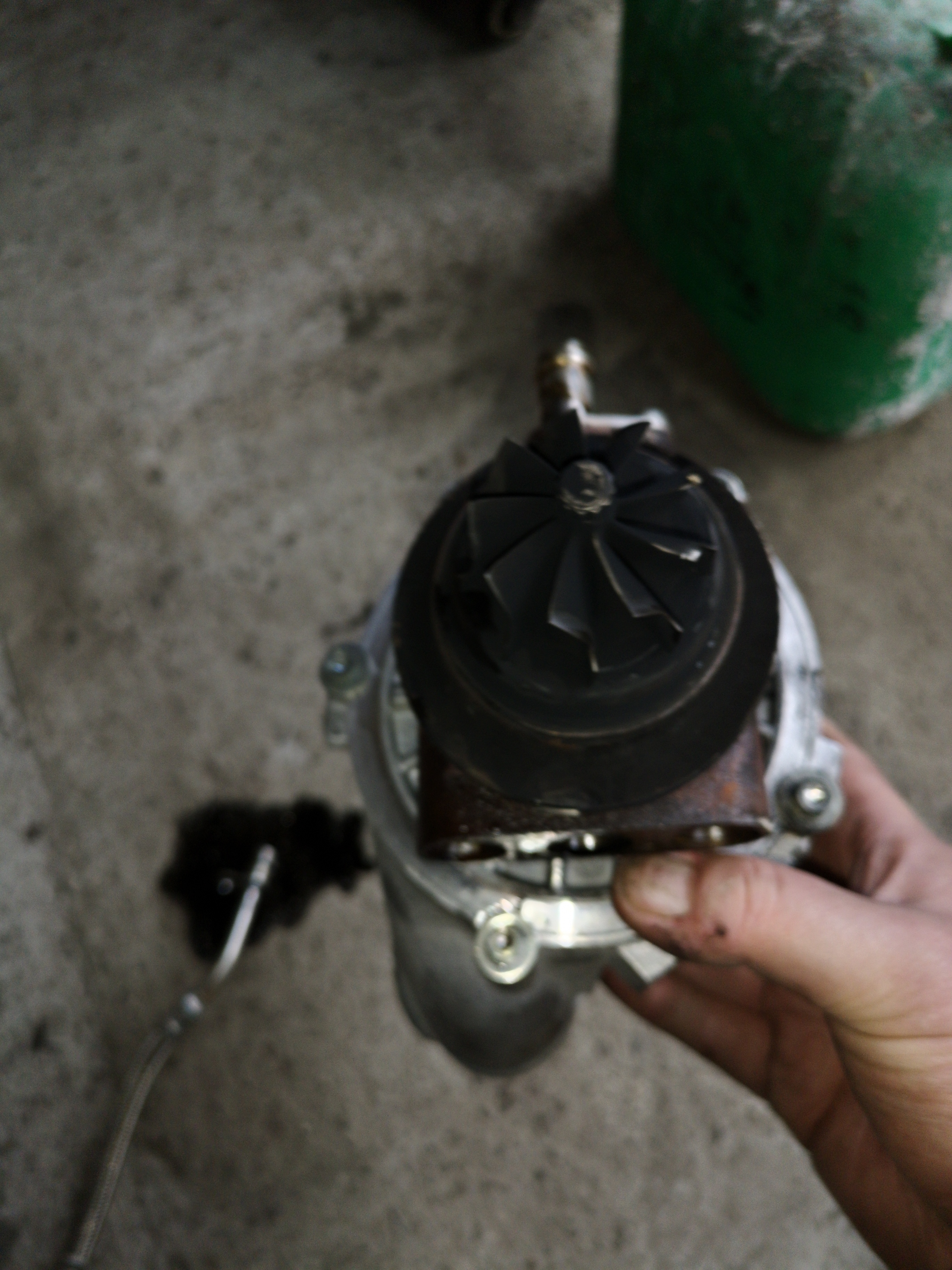

The final nail in the coffin for my RS7 was turbo failure @ 39k miles (combined with continual cylinder 5 misfires). Driver side turbo seized and broke the shaft. On further investigation the passenger side turbo wasn’t much better, just a matter of time before it let go.
This applies to all 4.0TFSi engines. The newer cars have a different screen/strainer I believe. Mine was a FL car and it still blocked.
As for the misfires, I replaced the plugs and OEM coils but no improvement. Would not do it all the time but most annoying all the same. If it was a sticking oil scraper ring that would be a massive job I did not want to undertake.

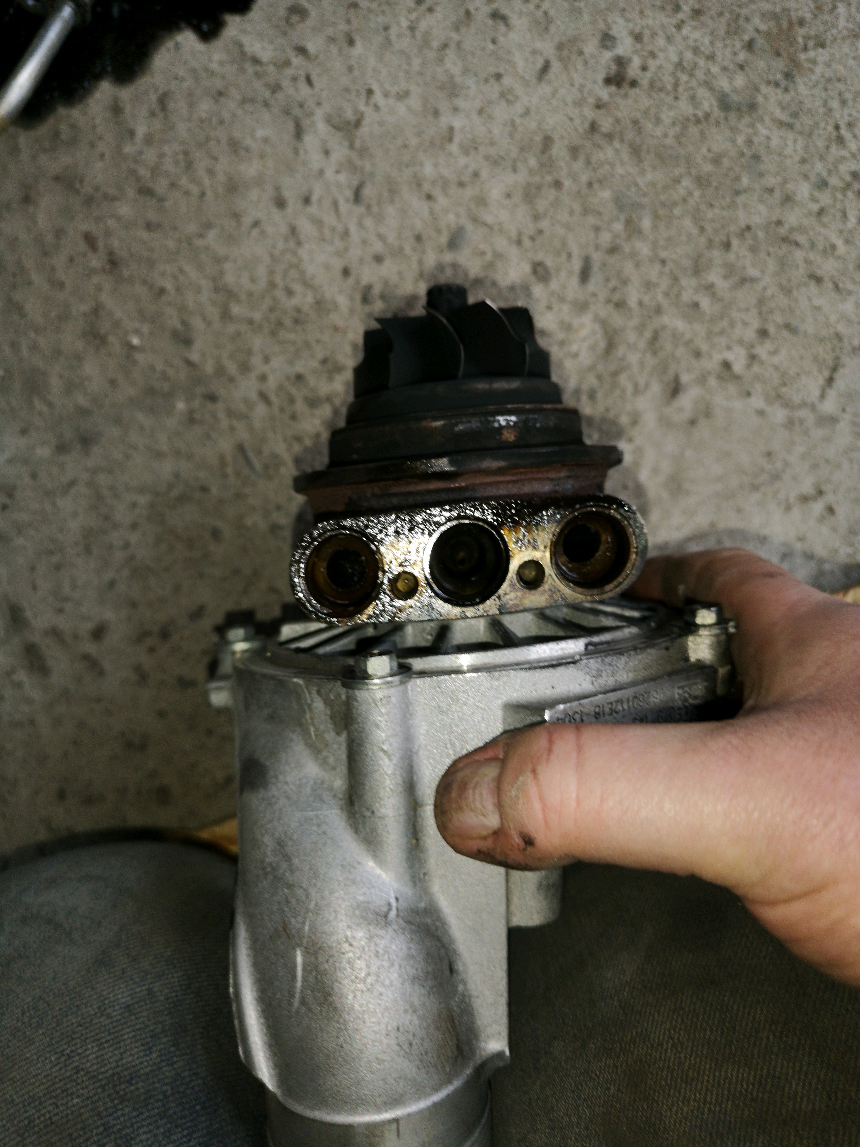

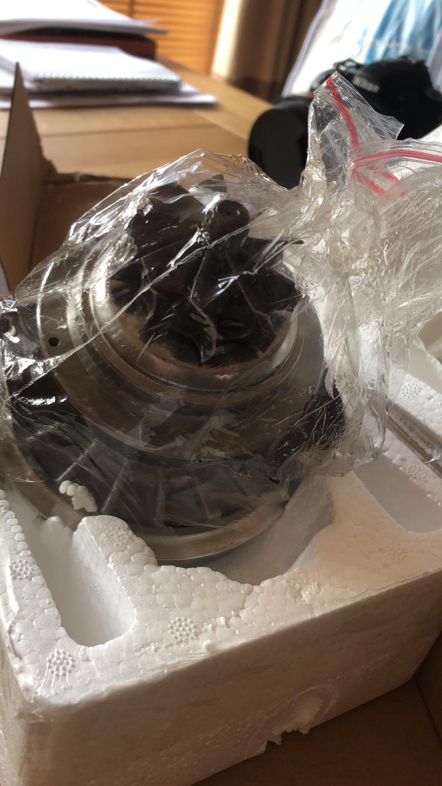

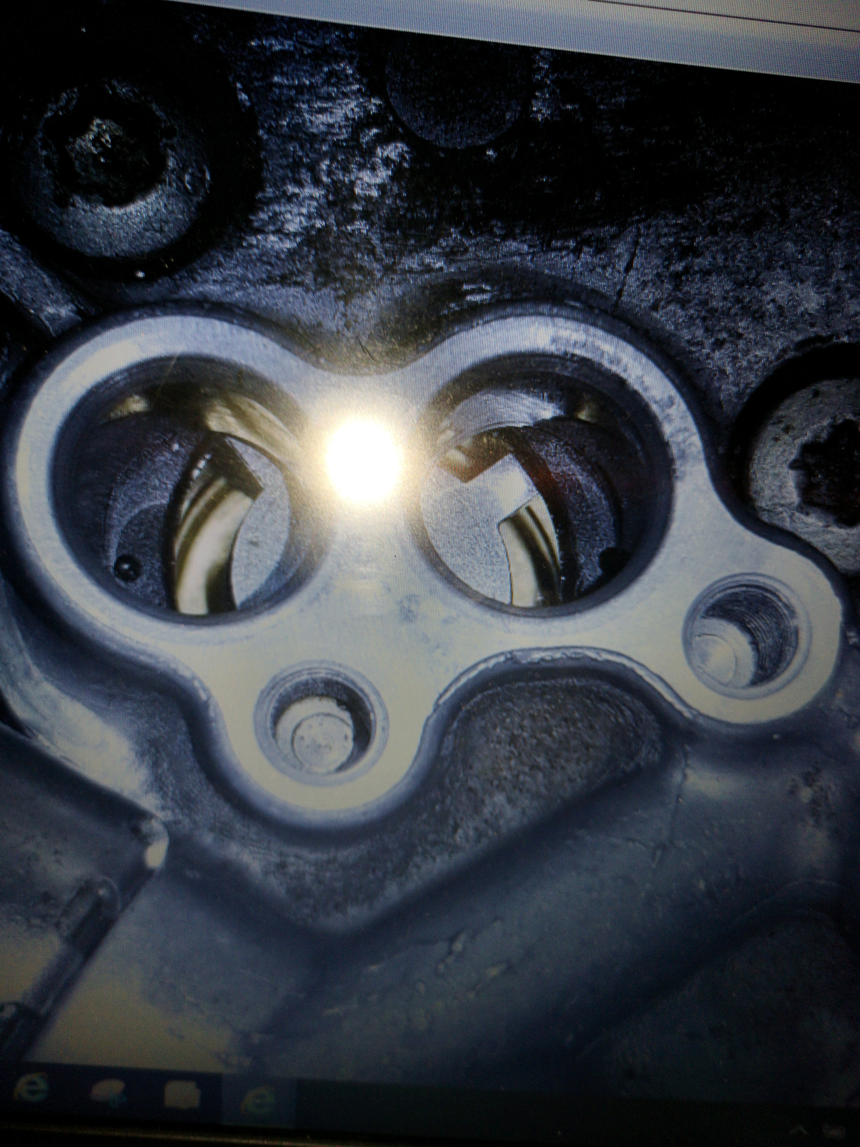

Once stripped out I could clearly see the Oil strainer was blocked (sorry no pics) Sourced 2 new turbo cores and cleaned the screen insitu. Big job but very doable by the home mechanic.

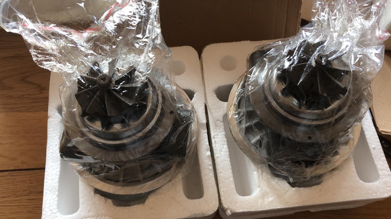

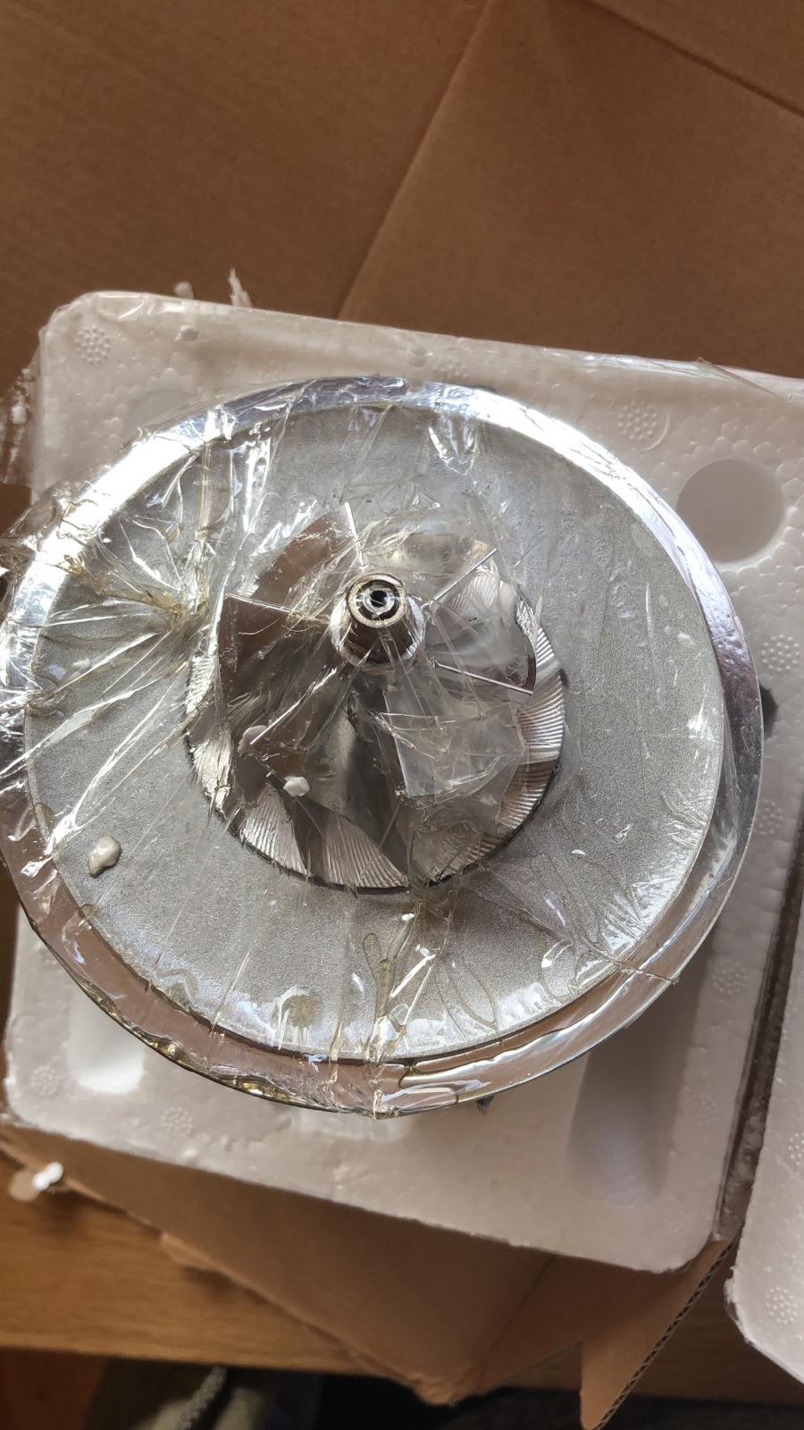

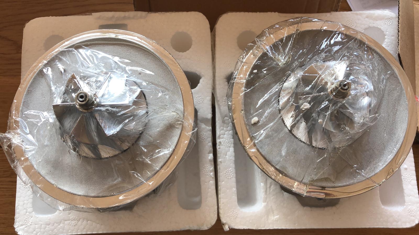

Turbos came from the below link (might come in handy for someone) with billet wheels and cost 613 USD inc delivery for both. Mega cheap I hear you say, they must be chocolate? On arrival and inspection, they look and feel really good. Obviously, I can’t tell the quality of the bearings, shaft or dynamic balancing.
I did around 200 miles on them before I sold my car with absolutely no issues. Can’t say I really care how long they last, much like Audi’s attitude to the oil strainer issue. Sold the car back to Audi. From reading other forums Audi clearly don’t care re this issue and if it fails out with warranty that’s just tough. Very poor in my eyes for a £90k+ car with low miles and full history.

Sorry about the crap pics I was running out of light.
The second pic is looking down into the oil strainer.

Sorry to hear. Pretty much guarantee it will be a blocked turbo supply oil screen. You must get it cleaned when you fit the turbos or they will just fail again.

The oil strainer must be replaced to a later superceded part, which does not get clogged as easily:
Original oil strainer:
079115175F
Revised superceded part, allowing much more flow:
079115175G
