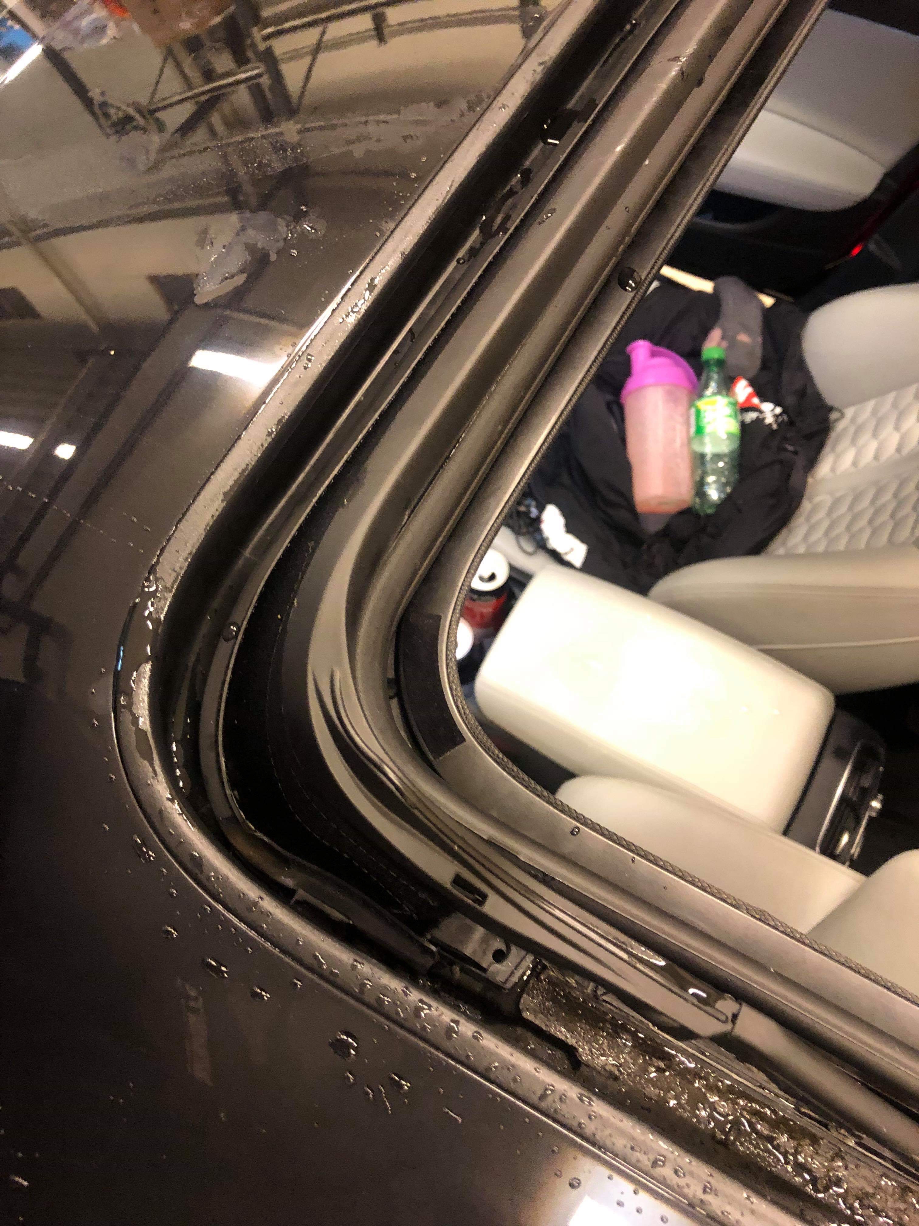

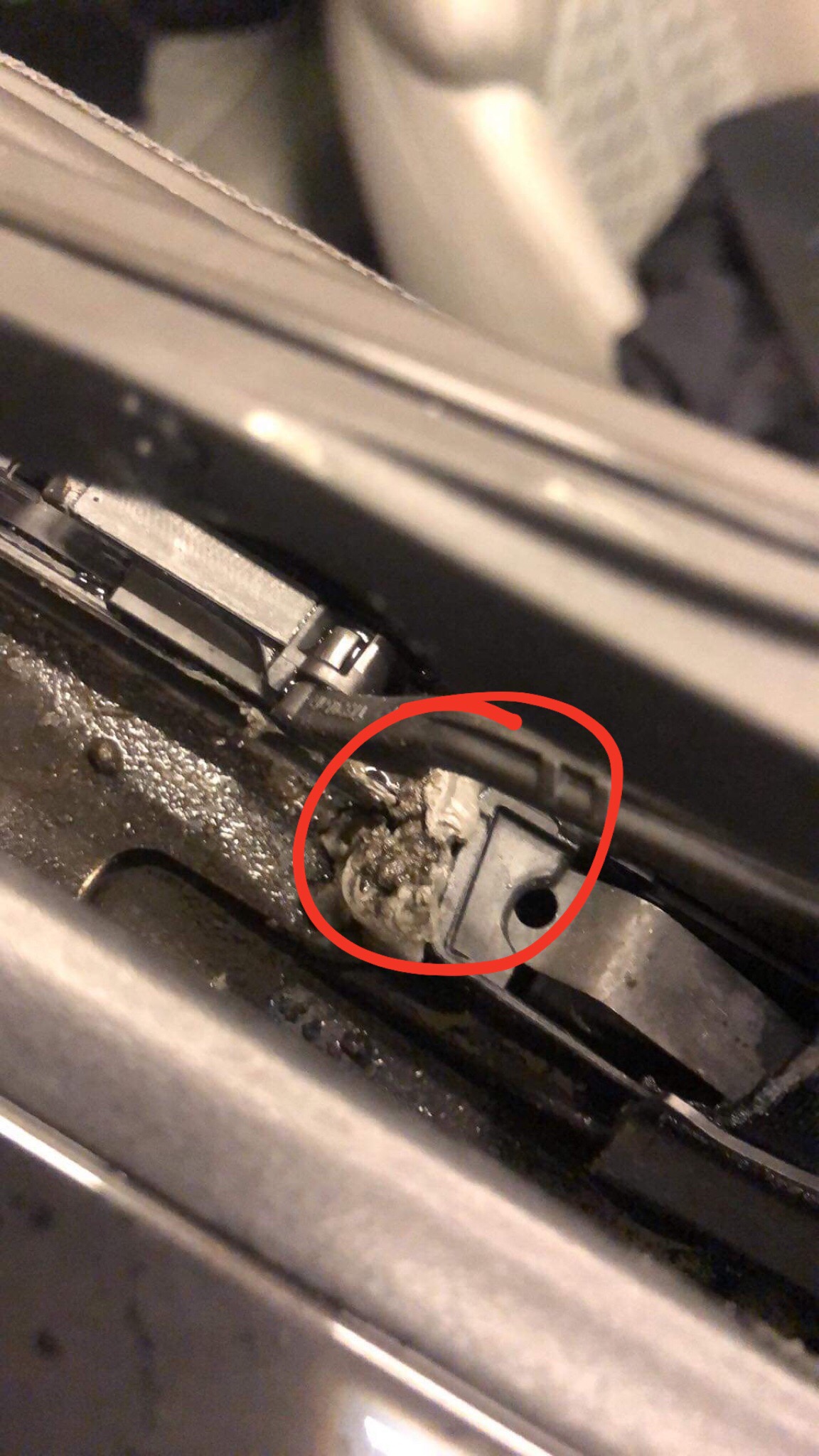

Then i got sick of the time spendt delivering the car back and fort, not having time for this bullshit, got the Shop to dismantle the roof lining and i drove around 2 weeks with the whole roof exposed from inside.
I started experimenting with a water bottle i made together with a 5mm hose, that i slided in the cracks and corners of the sunroof so that i could test it to the limit.
See the grease on the picture, this flux build-up, Builds a «bridge» for the water. Where the water usually leads away from the inside it now started filling over (when car was parked in «the right angle») first soaking the noise-shield that is made of fine cloth, then on to the top of the roof lining, leading onwards to the dash on both sides.
One thin flat-headed screwdriver covered with paper, just easily cleaning the grease away and i have not seen one drop of water in the car ever again :thumbs:
