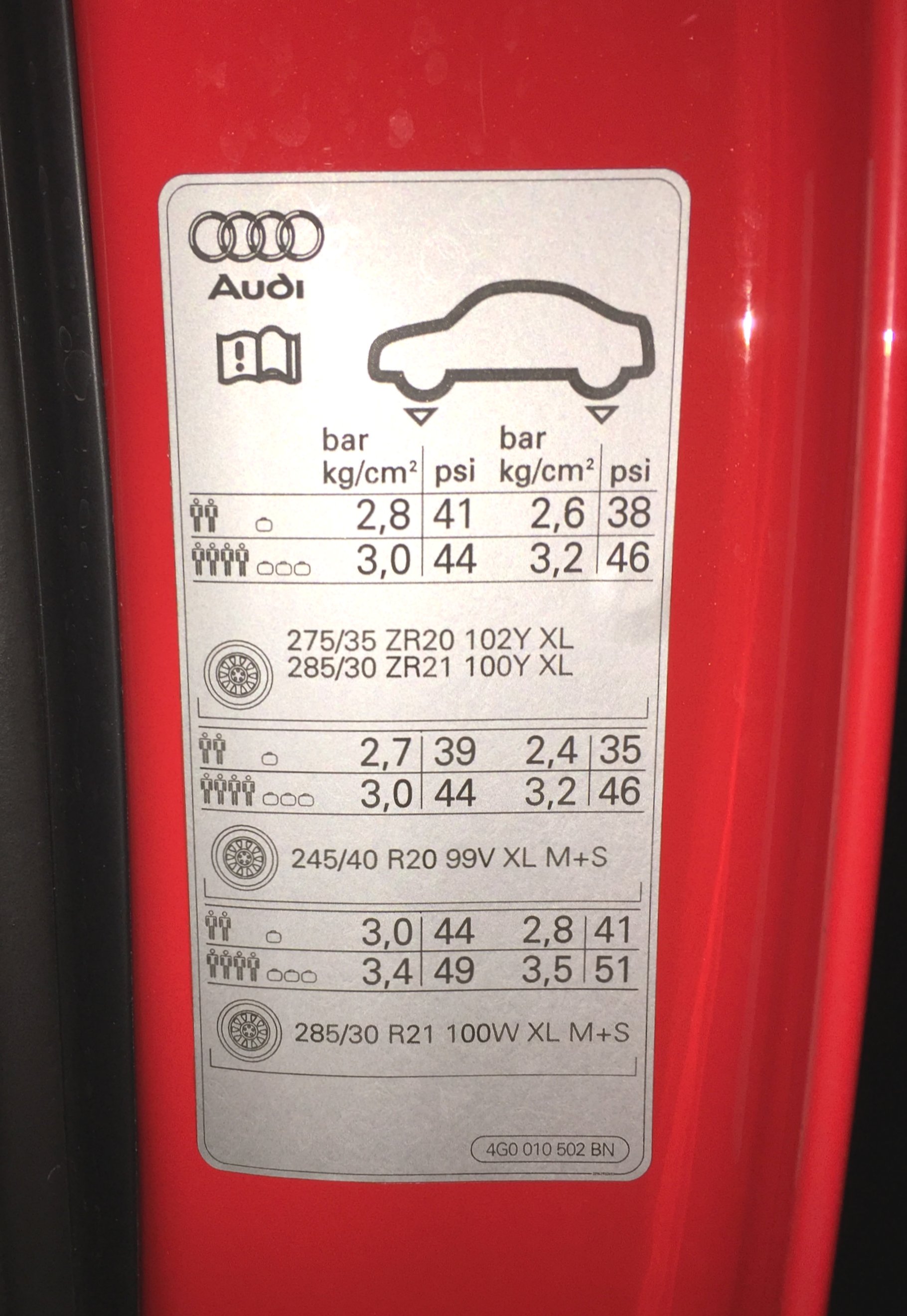

Have C7 RS6 wheels with Dunlop winter tyres 285 30 21 fitted to my RS7.
Can anyone tell me recommended tyre pressures displayed on RS6.
Ta!

Hope this helps:-

I am currently running my Dunlop Winters at 44 in the front and 42 in the back. Seems to work ok for me.

Bumping this, had a a nightmare yesterday and damaged my 285/30/21 contact 5P on a brick sticking out of some uneven ground ! Don't ask .
Anyway replaced fronts as was down to 4m anyway and got 42 front 40 rear . Was thinking u should be 38/35 maybe what are people running ?

I run 2 psi below what my Sticker says so 39 front and 36 rear.

Mine are at Front 41 and rear 38.
Same tyres as the op.
Does that sound ok?

I run my winters on 42 at the front and 39 at the rear with an average load...

Just looking at the guide plate on my 2014 car it recommends 39 psi front and 35 psi rear with 285/30/21 tyres so I'm going to try that.
