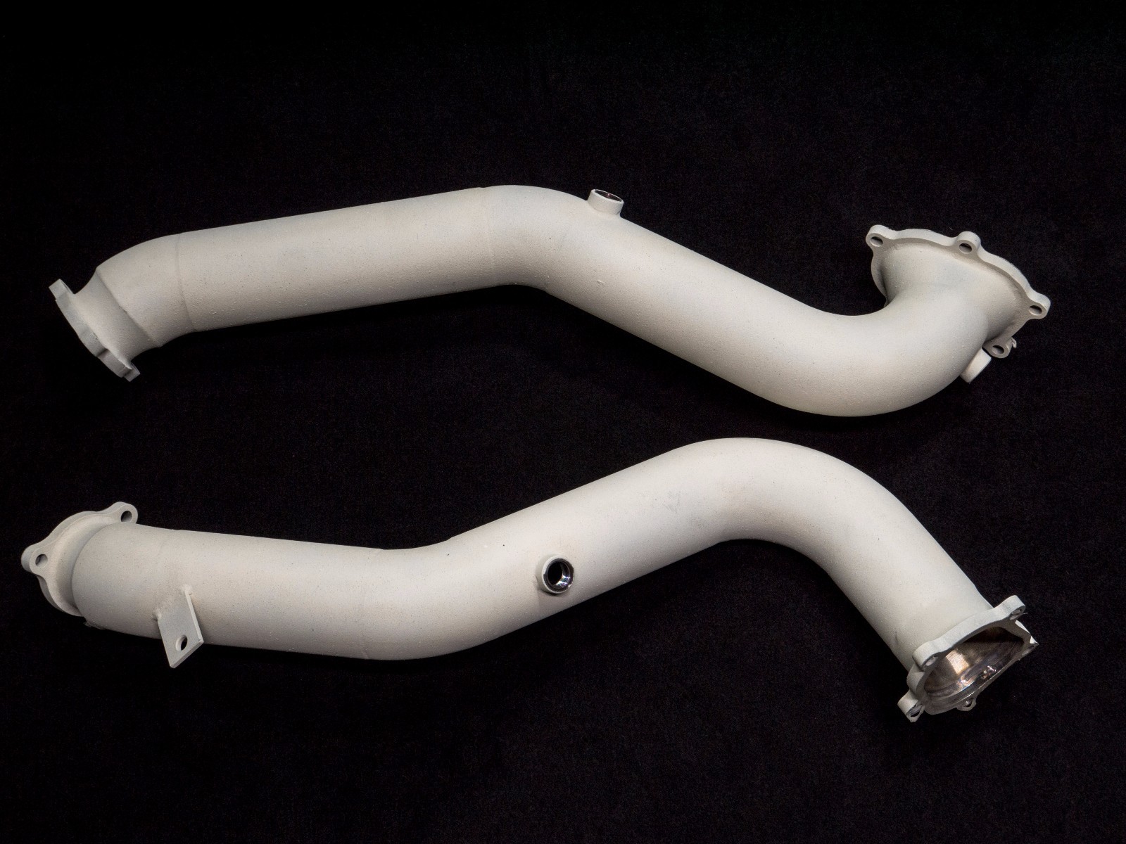

For what it is worth, i have 3" catless downpipes that are Thermo ZO coated from Russia. Only coasted around 1100€, not sure how much they help (stock cats and shape are a big heat source). Normally plug & play for the RS aswell....(PM for more info if wanted).
