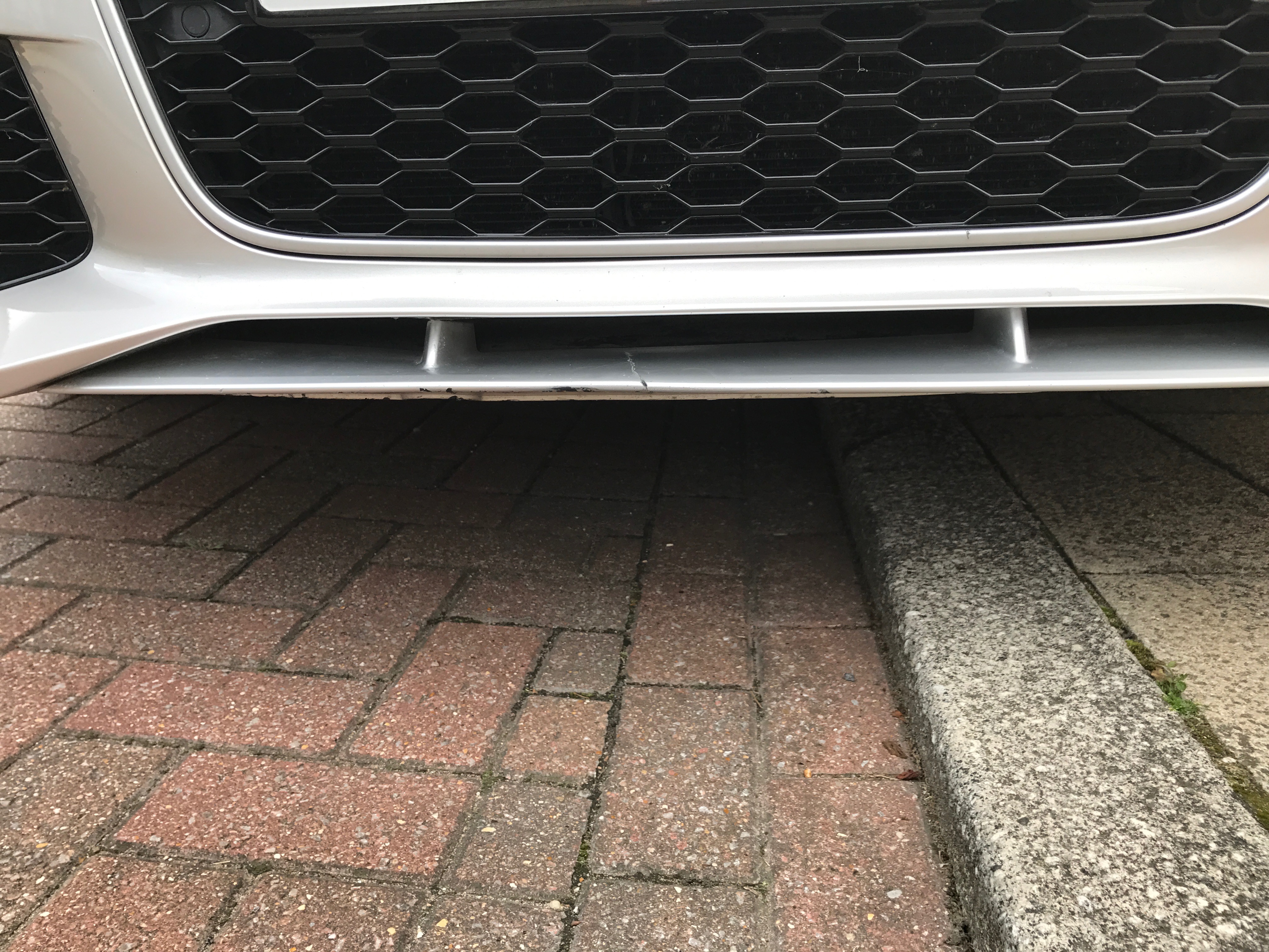

Hi there.
I need a new front spoiler fitted to my RS6 and also a new under belly. Is anyone aware of how easy these parts are to install and does the entire bumper have to be removed? From what I can see, the spoiler is bolted into the underside of the underbelly and it seems to be held in place by a metal strap behind it but I'm not entirely sure as to whether there are other fixings behind the strap that are holding the spoiler in place.
Any advice would be appreciated.

Changed mine a couple times. You need to remove the 2 undertrays behind it to get access to the screws that hold the lip spoiler in from behind. No need to remove the bumper and can be done with the front of the car lifted ie jacks and stands. Takes about 20 mins from memory. Just be careful as you remove the undertrays as there is a wire or hose clipped to it so you need to unclip it before pulling away.

Many thanks for the help from you both, have it sorted now.
