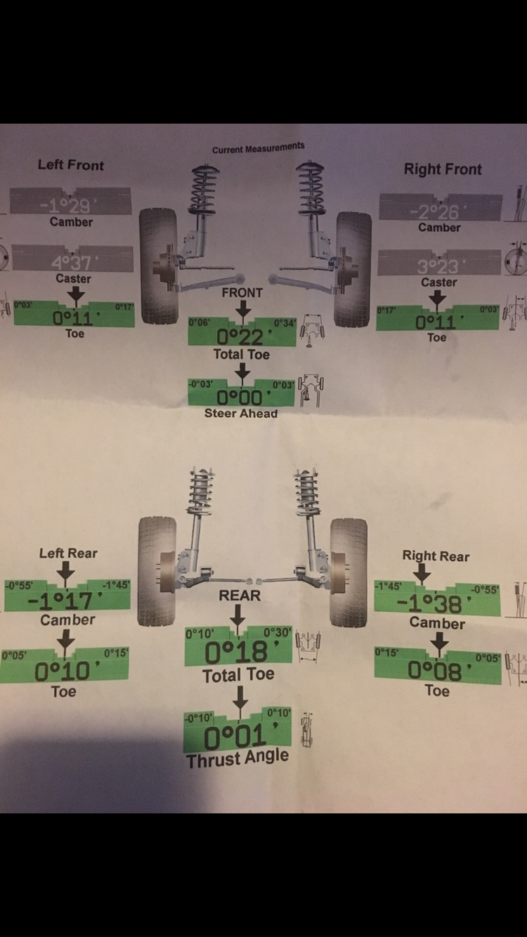

I had mine set to factory well I think it's factory Does this match yours or close?

Emm ok mate would be interesting to see you alignment report if you still have it? So can compare to mine

Looking at the alingment settings, the difference in front camber may be causing an issue. Having the camber even as much as possible helps with how the car handles and ensures the power can be put down evenly.Rs63855 wrote:Here's mine

Emm maybe! But front camber can't be adjusted?

On my print out it looks like the wheels are pointing out on the front? Or is hat just the pic?
Re: Torque steer fixed by bigger front tyres?
Just the picture. Positive is toe in. Negative is toe out

Front camber be adjusted, but it needs to be adjusted by moving the subframe. I had my RS4 aligned by Center of Gravity and there was a particular focus on making sure the front camber was even. The front end of the car was much improved, particularly when crossing over the crown of the road to overtake. It's worthwhile getting a specialist to align the car as it can make a huge difference to the way the car feels to drive and the way it performs.Rs63855 wrote:Emm maybe! But front camber can't be adjusted?

Surely that can only balance it from one side to the other, not actually adjust it? I fitted adjustable top arms to my B7 to allow the camber to be adjusted.innercry666 wrote:Front camber be adjusted, but it needs to be adjusted by moving the subframe. I had my RS4 aligned by Center of Gravity and there was a particular focus on making sure the front camber was even. The front end of the car was much improved, particularly when crossing over the crown of the road to overtake. It's worthwhile getting a specialist to align the car as it can make a huge difference to the way the car feels to drive and the way it performs.Rs63855 wrote:Emm maybe! But front camber can't be adjusted?
Does your car have air suspension? Your front toe tolerances are larger than mine. What does it say at the top of your paperwork for car / model / suspension type?Rs63855 wrote:Here's mine
