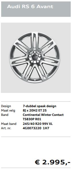

Not sure if a set of 19's would fit over the brakes properly (even the standard brakes) and to be honest I wouldn't want to fit wheels smaller than the recommendation from Audi on to a £90k car just in case of problems (particularly insurance not paying out for example!)
Audi sell a 20" winter wheel package on the continent (it's possible to order from UK and have them shipped, as annoying they not available yet available here even though I've chased Audi UK) picture attached with spec and pricing.
