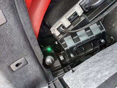

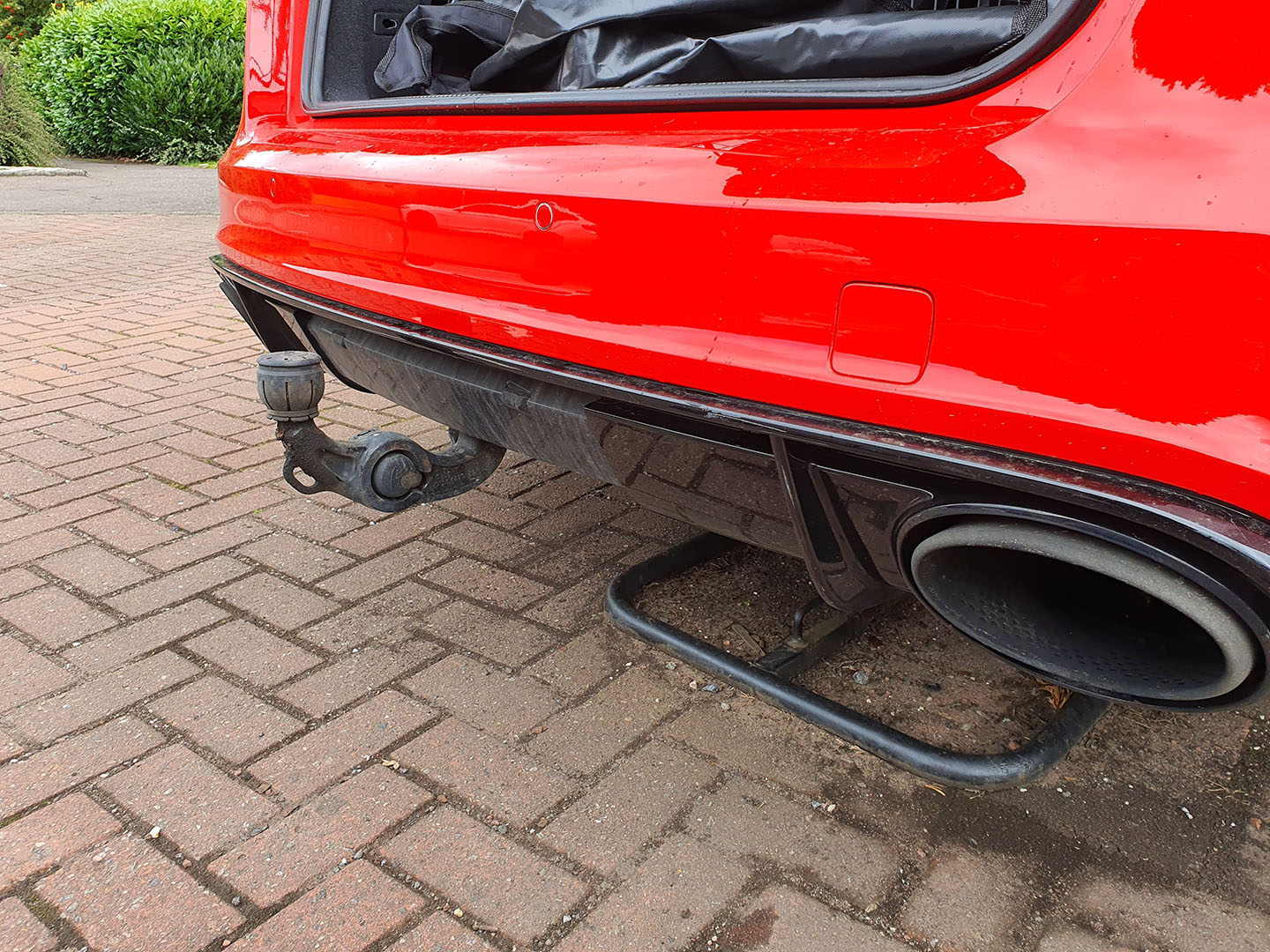

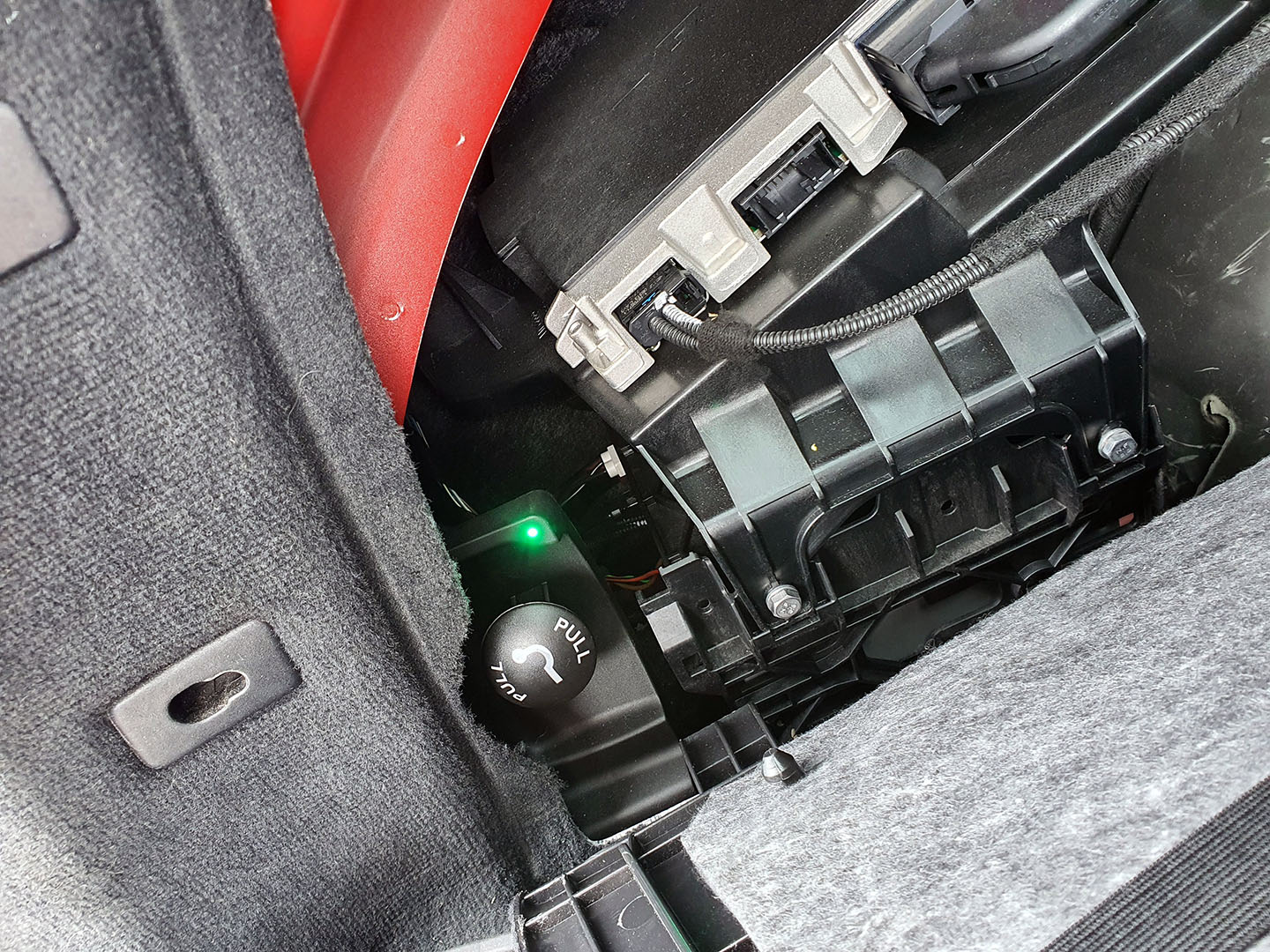

Well now, I've just discovered my non-dynamic RS6 already has the towbar fitted with all of the electrics. My clue came from @PhilMorrison who said he had to remove the diffuser panel (thanks Phil). So I looked for the panel - and spotted the ironwork behind it. My option Sticker doesn't make any reference to the towbar, but it's there. I've got the electric pull-cord in the near-side of the boot, and the towbar pops out from underneath. It looks like it's never seen daylight before.
Check your RS6s folks! Maybe we all got towbars as standard?

Hahaha. What a find. Now you have 2
