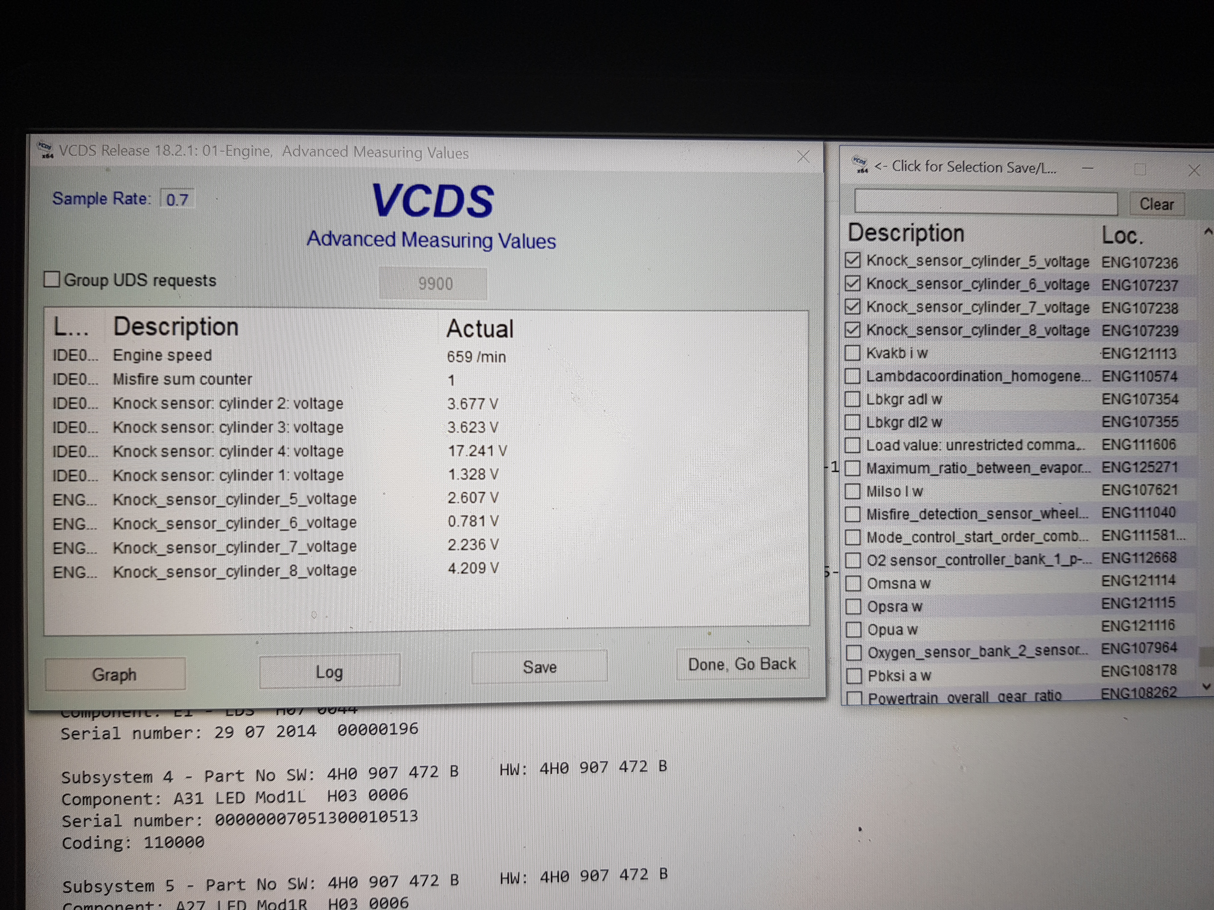

attached photo taken with my note 8 whilst using VCDS ... my counters are random ... cylinder 5 though not so much as cylinder 1 ... I have just purchased this Audi (parted my M5) and could feel the misfiring in the drivers seat ... just a tad now and then ...
I have also monitored the live data of misfires per 1000 rpm across the cylinders and the misfire is random on cyl 3 , 4 , 5 ,6 for the 10 minutes I was watching it ...
More concerning though is knock detection voltage on cyl 4 18.xx volts ... all the others are up to 3 volts ... is this correct? Is this reason for concern ?
attached pics .
I`m going to get the coils and plugs replaced as I can`t see any record of these being done and knock wood the misfires will go away ... I just finished a nightmare with my M5 and I just moved back to audi ... I hope this is better but as it turns out first day it misfires ... jeeez
