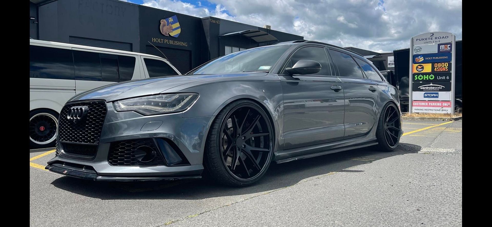

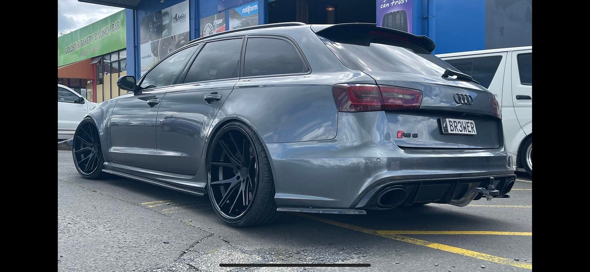

I run a business that fits wheels an tyres, the most aggressive fitment we have done on a RS6 is 22x11" 20p offset with a 15mm spacer. 285/25/22.
With the car sitting on CTS links and on dynamic setting still no rubbing.
