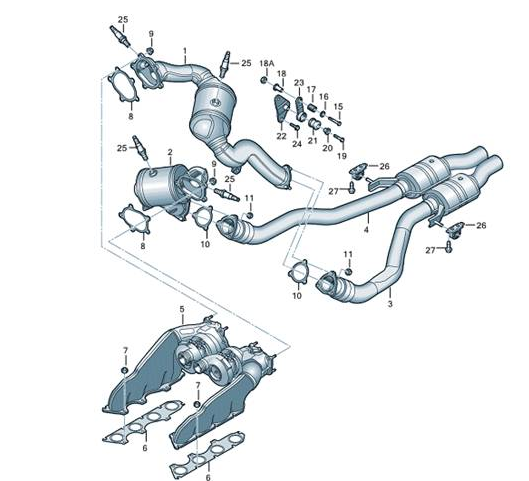

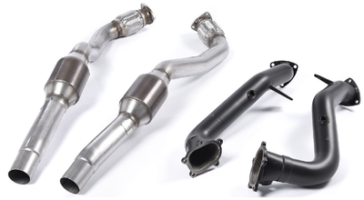

I am failing to resist the urge to swap out the OE cats with the 100 cell Milltek jobs. Brutus has had them on for seven years now and she flies through every single MOT on emissions. I can't help but feel that I should be completing the non-res job on this by adding them too at the same time as the remap.
Yes, it is 2k that I don't really want to spend right now, taking this remapping much closer to the £5k mark, but bloody OCD and is there much benefit to me doing this or am I really expecting diminishing returns adding this on?
Purely when compared to the OE design, the far more direct flow seems pretty obvious. I absolutely won't run decatted, done it once, never again, not worth the hassle for me at least.
vs
Thanks for any input on this.

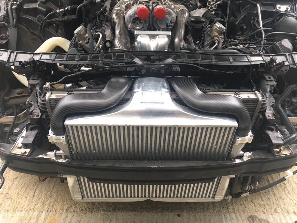

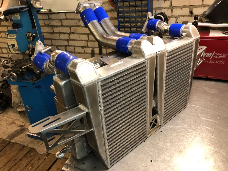

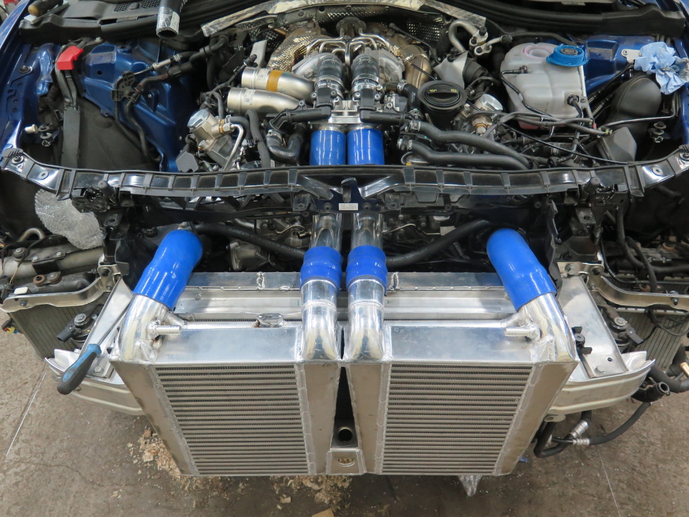

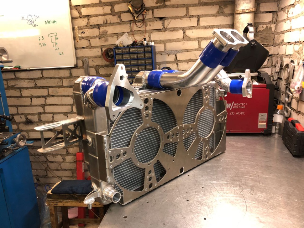

The bit everyone misses because its too difficult. Can release big gains, around 40bhp I believe

WoW . Impressive bit of fabrication there

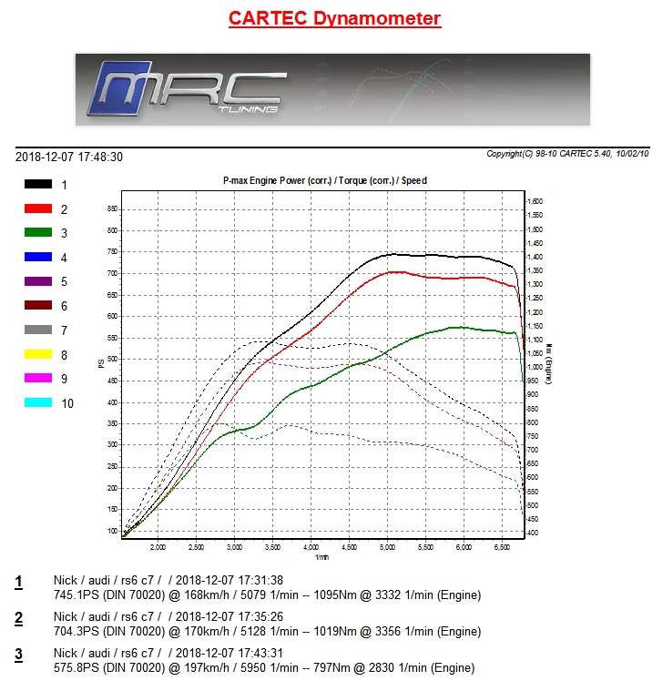

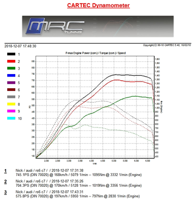

Ok, MRC have done their usual magic and I pick her up in the morning. Switchable mapping apparently, no bloody idea how that is going to work, but sounds like a good idea tbh as I was a bit worried about the additional strain on the car when I have a lead foot for the most part.
Final config for the car was -
Beissbarth 4-wheel alignment to hopefully dial out the full throttle torque steer/squirrelling that my other aligner couldn't
Milltek Full non-resonated exhaust system with 100 cell cats
Autotech uprated high-pressure fuel pumps
NGK 4905 race plugs
Uprated air filters
MRC Stage 2 Remap on Tesco 99 with switchable mapping.
Results below ladies, not too shabby!!!!!!

Great stuff!!
And how was the drive home
Re: Stage 1 MRC remap, any other sensible mods to do?
He picks its up tomorrow he said. Pay attention Perc.
745 is a great result whilst still being MOT compliant. Congrats.
The timing of the runs is odd though. The clock says the highest power run was 1st run then the 2nd highest was the 2nd run and lowest power was last run.
