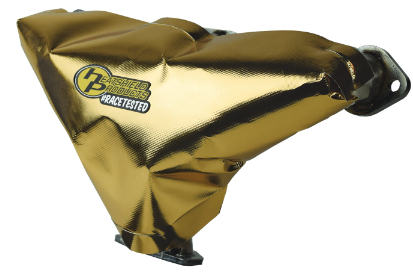

I've been talking to the guys at Heat Shield and sent images of the engine bay for an engineer to recommend the best products.
Here is the reply:
Wow. They don’t leave you much room in that engine compartment.
First up, covering the hot side of the turbos with our Lava turbo shields
https://www.heatshieldproducts.com/auto ... rbo-shield
Next, all the exhaust piping with our Heatshield Armor material. Covering this with our thermal barrier will help to drastically cut underhood temps, reducing the amount of heat the engine is soaking up and how much the cooling system has to dissipate.
https://www.heatshieldproducts.com/auto ... ield-armor
If the Heatshield Armor won’t work for these areas, our Lava Exhaust Wrap will be the next best choice
https://www.heatshieldproducts.com/auto ... haust-wrap
To help the intercooler, I would recommend using our Lava Tube material to install around the intercooler lines in the engine compartment, to shield them from heat and help the coolant stay colder as it travels towards the intercooler.
https://www.heatshieldproducts.com/auto ... ube-sleeve
For the air intake piping, I’d recommend our Thermaflect Sleeve, to protect those pipes from heat soak and heating the air traveling through them before reaching the engine.
https://www.heatshieldproducts.com/auto ... eve-velcro

They won't do an RS6 specific turbo shield IMO, the turbo housings are huge on these as they are part of the downpipe, and would be very surprised if one existed. I too have been talking to them, basically i plan to get the lava header armour .5" and use it as a blanket, not much room but will fit.
Its important its fitted all the way up to the back of the turbo's - this will be the biggest gain by far from all the recommended bits above as this will protect the cold side of the turbo AND the cold air feeding the turbo's - it one hit.
You can also use the very same stuff to wrap your downpipes, as ceramic coating only holds back 30% heat max, this stuff holds back 80%,
You can even get them in gold now !!!

I did some rough measurements, looks 2 sheets 18" 24" for turbo's/manifolds and 1 (or 2) sheets 10" 36" for downpipes (depending how far you want to wrap them.
More or less brings it on +-420€ (or 610€)..hm :s. Getting pricey for just some heat insulation, i'm sure it helps a lot and maybe why audi cheaped out on that material. Prices are taken from ebay, 1/2 thickness (better thicker then do a half job).
The left overs would be good for the oil/coolant lines to the turbo's.
Interesting fact, but was recording some temps after the car was in garage for already some time...most stuff was around 50-55°C. The 'cold' side of the turbo's are aluminium if not mistaken, those were still 70°C :(. Fact is aluminium picks up and holds heat longer then cast metal, no wonder IAT before the throttle body gets so high.
Anybody knows 'cheaper' source?

Decided to order 2 sheets Heatshield Armor Downpipe Shield Kit ½" x 10" x 36" (155.82£ shipped to Belgium).
In the first place to wrap the manifolds and hot side turbo's. Not sure if wrapping the cold side is a good thing (the aluminum might be better of unwrapped).
I'll see how far i get with those 2 sheets, maybe with the rest i should be able to cover half of my downpipes and the oil/coolant pipes of turbo's. Altough maybe again it is best not to cover the hot lines so heat isn't trapped, but cove the inlet lines and prevent them from heat).
Will see how it goes...
