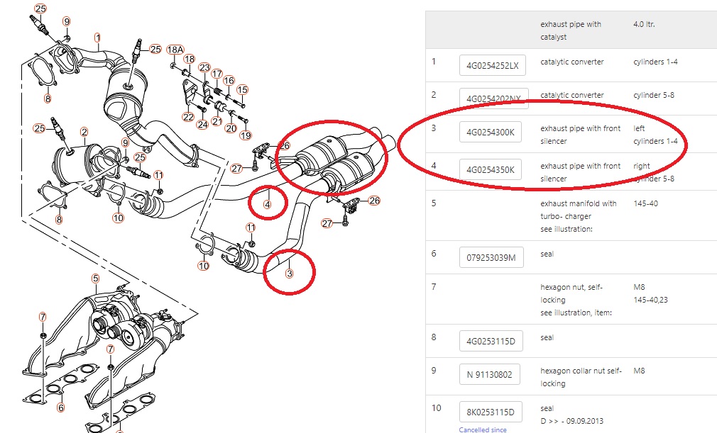

NotNormal wrote:
Thu Oct 29, 2020 3:07 pm
I’ve now added the RS6 air box and pipercross filter amd the RS6 Performance Sports exhaust and secondary cat delete (mainly for noise)
The RS6 doesn't have any secondary cats. What you deleted were most likely the front resonators.
Re: Centre resonator delete testing video
Post by MikeFish » Fri Oct 30, 2020 10:16 am
See items 3 & 4
The only cats are items 1 & 2.
See items 3 & 4
Fair enough, I took the terming of the pipes off an American forum.
I stand corrected 😬
Sounds better without the resonators 😎👍🏻
