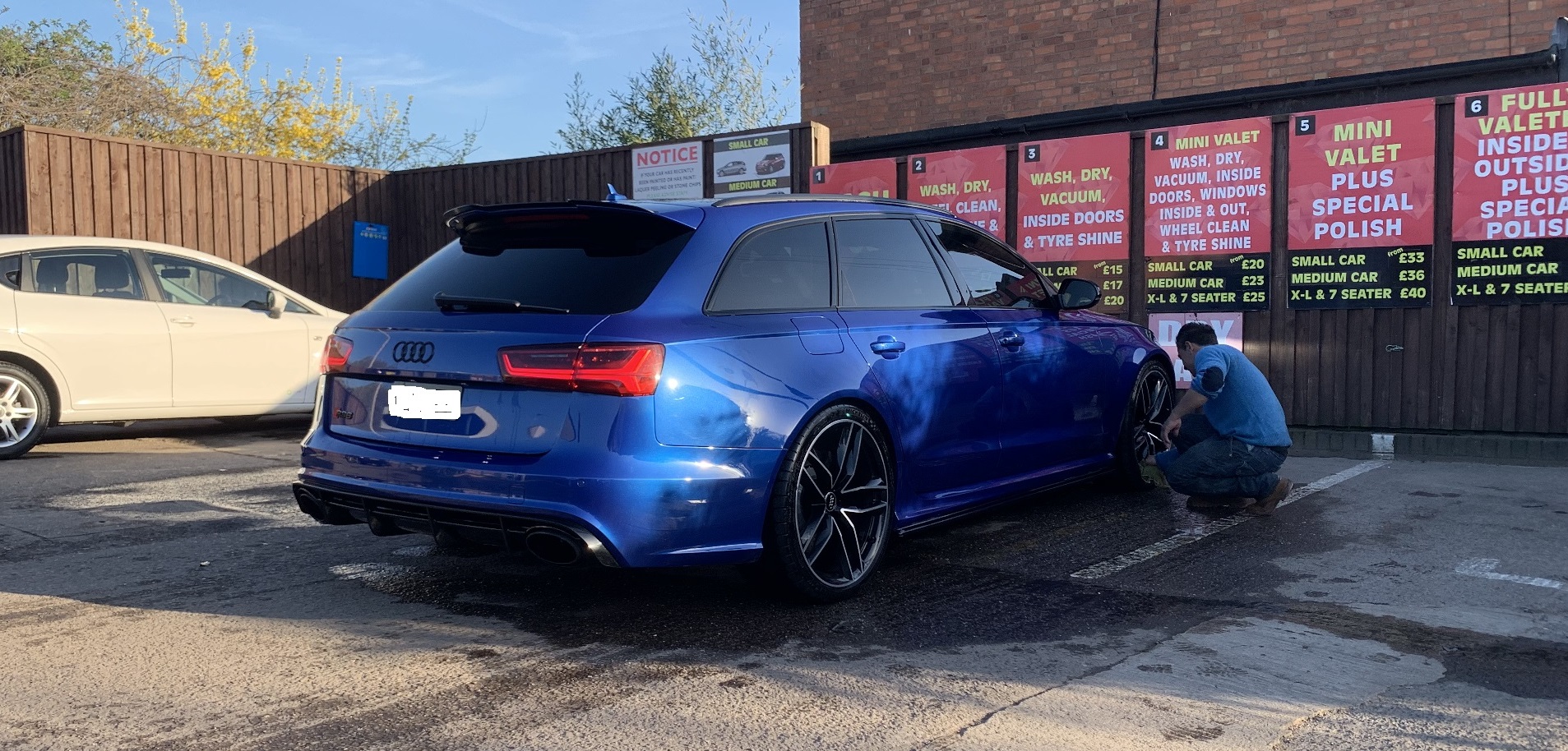

So, 2015 face lift with 15mm rear and tools in the boot, perfect!

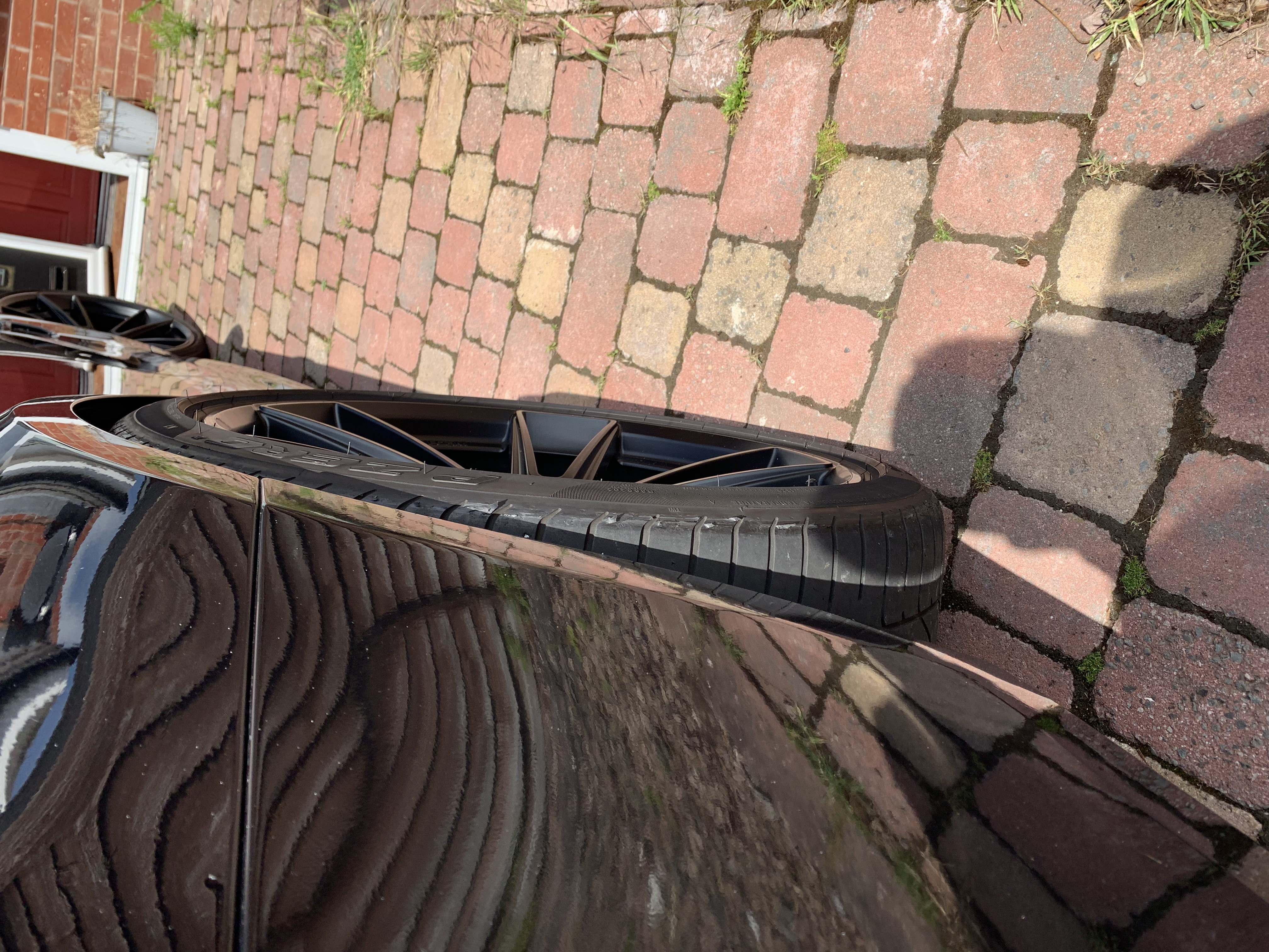

2017 PE with standard everything, no weight in boot, looks too small and I could swear the wheels look narrower as the rubber is stretch over the rim a little

I reckon the sweet spot for RS6 is 20mm rear and 5mm front, if at all. You can feel the car tramping on the white lines a little and I'm pretty sure someone doing a 4 wheel alignment would cringe, but it sure looks good!
