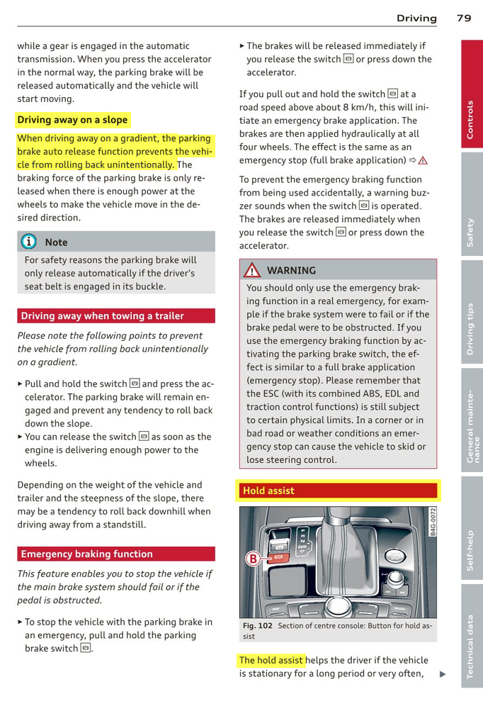

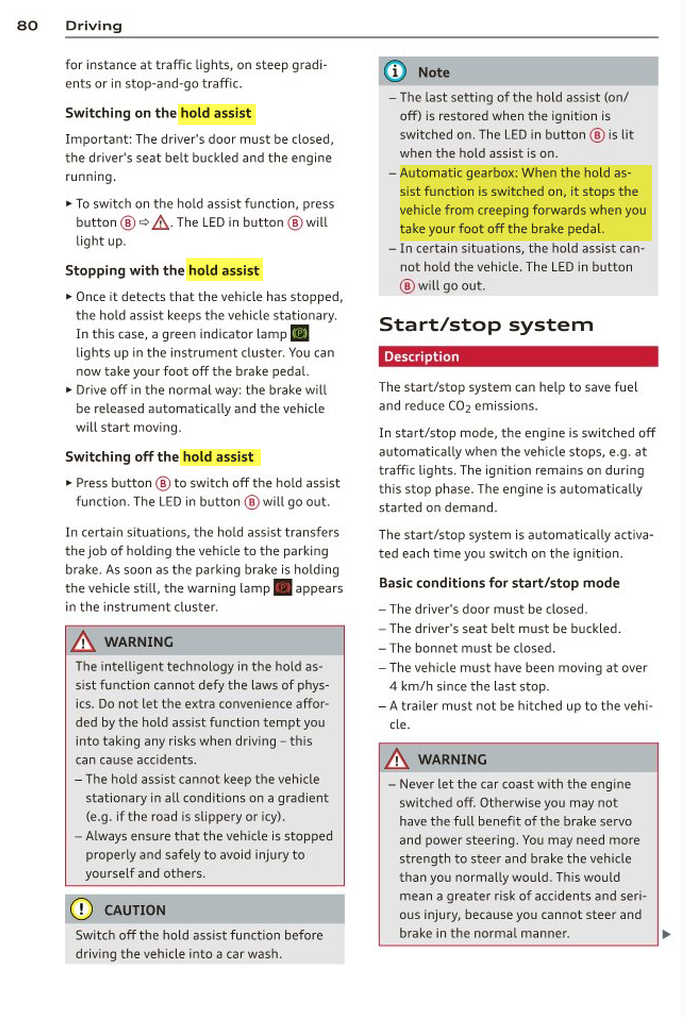

I've highlighted the relevant sections to make it easy for you.
Hill Hold Assist is done using the electro mechanical handbrake auto release funtion... as it says.

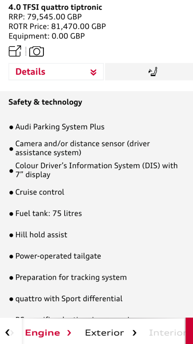

It may say that in the manual which I’ll stand corrected Mr Bee but I’ll challenge you to finding Hold assist on any option choice on any model Audi. It is always offered as Hill Hold Assist and I would say that is what people know it as. At the end of the day people know exactly what I was on about and I dunno why you felt the need to be quite so ANAL and point out that it’s not Hill hold assist and in fact according to you Hold assist. Which takes me to the other point of yours which is, if you believe that Hill hold assist is the electro magnetic brake then that would mean if cars which have not got hill hold assist as a ticked option then that car would effectively have no parking brake. My Wife’s A3 doesn’t have hill hold assist but she has the electro magnetic handbrake so I ask YOU seeing you know it so well. What is on my wife’s car? Now do you see how dumb this debate has become?

Oh dear, I didn't realise you'd get so touchy and offended by being wrong for once. Please don't try to be a smart ass with me by misquoting and claiming I only said snippets of what I actually said. There's no need at all for such animosity or rudeness between people who don't even know each other, no matter how long they've been on this forum!
I'm sure you're a font of all knowledge and right most of the time but even perfect people are wrong occasionally :) ANAL in your isolated opinion or not, I pointed out it isn't HILL HOLD ASSIST because IT ISN'T! no matter what you call it. Why not learn something? It'll be better for your health :)
I stand entirely by what I've said in whole (not snippets of it) and I am supported 100% by the manual if you'd ever care to read it. It's NOT according to me, it's according to AUDI.
HILL HOLD ASSIST is provided by the AUTO RELEASE function of the electro mechanical HAND BRAKE. That's not me saying that, or twisting words, or calling something by its wrong name, it's stated for all to see in the cars manual.
HOLD ASSIST for holding the car stationery in stop/go traffic is provided by the HOLD ASSIST button.
Therefore, if your wife's car has an electro mechanical hand brake that will AUTO RELEASE on applying power to drive the car, she does in fact have hill hold assist (whether it was offered, ticked or not). If it doesn't auto release, then she doesn't. It's really not rocket science and it's bordering on insanity if you really believe there's anything in my words that suggests a car without hill hold assist doesn't have a hand brake - That really would make this debate dumb.
Anyway, I've made my point, I already had, and I'm only sorry you took such offence and read my comment so personally, it wasn't. ;)
In this crazy old world with all the technology we have it really does help if we call things by the correct name and I was merely trying to help the OP do so in order to get to the bottom of his problem. I'm not 100% sure, but I don't believe hold assist applies the hand brake with the same force as using the hand brake button, and in my experience it also releases the car much smoother, whereas using the handbrake button (hill hold) can make it quite harsh. I think that's why the manual contains warnings about hold assist not being able to hold the car in certain circumstances. I'm pretty sure it doesn't mean on a vertical incline or upside down :)
Hope that put's things into more perspective - I'm knackered now :)

I will absolutely agree with you the manual is ambiguous, but it makes more reference to starting on an incline in the electro mechanical hand brake section than it does in the hold assist section, however, it also makes reference there to starting on an incline too. The odd thing is that although they make reference to hill hold assist as an optional extra, absolutely nowhere does the manual refer to HILL hold assist, neither does their on line glossary. I'll therefore accept the anal badge to some extent, but I still think it's important to refer to the functions by their Audi name in this thread in order to accurately define what the OP is doing. No word twisting taking place on my part ;)
