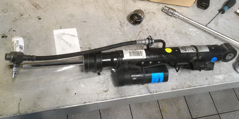

First feedback from the dealership: rear left damper fault. Discussions on-going with the factory as to whether the damper needs to be replaced.
Not quite sure how else they could resolve the problem.

Here is the faulty damper:
And an interesting explanation on Audi's DRC hydraulic linkage:
