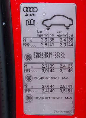

Mike posted this in another thread...
So Audi recommended for 21's is F44/R41...
MikeFish wrote:Image
MY16 Audi RS6
Posts: 6713
Re: Car feels like it's taking off goes all wobbly ??
Post by Ian_C » Sun Nov 20, 2016 3:02 pm
Leo-RS wrote:Mike posted this in another thread...
F44+R41 is for M+S (literal translation from German = mud+snow = winter tyres)
From that sticker, factory 21" summer tyres:
F41+R38
F44+R46 with rear passengers and luggage
Post by danilobandeira » Sun Nov 20, 2016 11:52 pm
Mine is different
Post by Markp » Mon Nov 21, 2016 1:34 pm
Higher figures for "cold" temps on your summer tyres reflect hotter climate than the UK. Lucky you.
You will notice the winter spec tyres are the same pressures.
Post by Nigelo2 » Mon Nov 21, 2016 1:35 pm
Mine is different again (May 2016 supplied with P Zeros on 20" rims)
