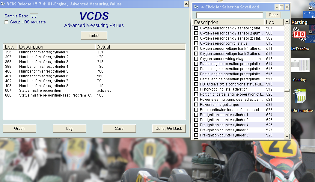

Intermittent Misfire

Pre FL- Stock. Never noticed any sensation of a misfire- sometimes the switch from 8 to 4 cylinders can be felt so maybe this explains the count? Cylinders 1 – 4 – 6 – 7 as opposed to 1 – 5 – 4 – 8 – 6 – 3 – 7 – 2. Do you feel a misfire when the gbox is in sport as well? [4 cylinder mode deactivated by default iirc]

Thanks for the info Leo. If it were a plug issue, would you not expect for it to be present in more than one cylinder instead of just 5? And if it were the plugs, would you not expect it to go away now I'm back stock?Leo-RS wrote:Speak to Doug at MRC,

The bit about CoD I totally agree with as when I had the tune, say if I was in comfort and cruising on the motorway at 70, then hit kickdown, it would nearly always activate the CEL for a few seconds and that's gone away now I'm back at stock.
I have swapped cyl 5 plug for a new one to help rule it out but that didn't seem to help. The original one looked pretty okay. I've still got it so will take a photo of it when I get home.

Thanks for that...makes me feel a tad better!feeltheburn wrote:Pre FL- Stock. Never noticed any sensation of a misfire- sometimes the switch from 8 to 4 cylinders can be felt so maybe this explains the count? Cylinders 1 – 4 – 6 – 7 as opposed to 1 – 5 – 4 – 8 – 6 – 3 – 7 – 2. Do you feel a misfire when the gbox is in sport as well? [4 cylinder mode deactivated by default iirc]
Gearbox in sport and pushing slightly when still cold will bring on my misfire (the type which gets logged like in my original post) the majority of the time. But if I just sit there idling watching the above parameters, you'll see the cylinder 5 number increase by 2 or 3.
