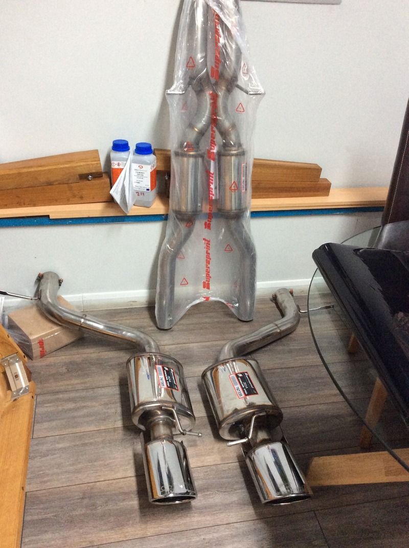

I'd recommend Supersprint, its off the shelf. Tuned to the car and only £400 more than a Milltek but the built quality is another league! Sounds miles better too. These are C6 system for comparison only not C7
Milltek
Supersprint
Milltek
Supersprint
