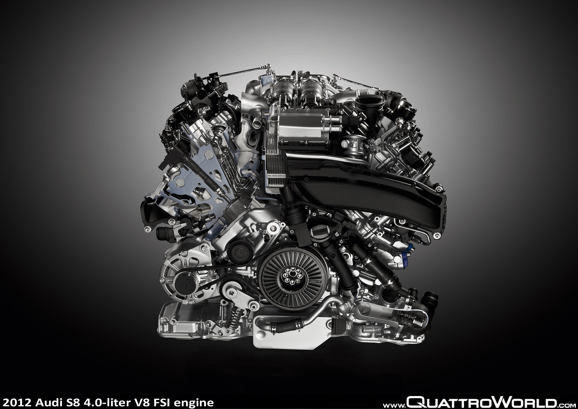

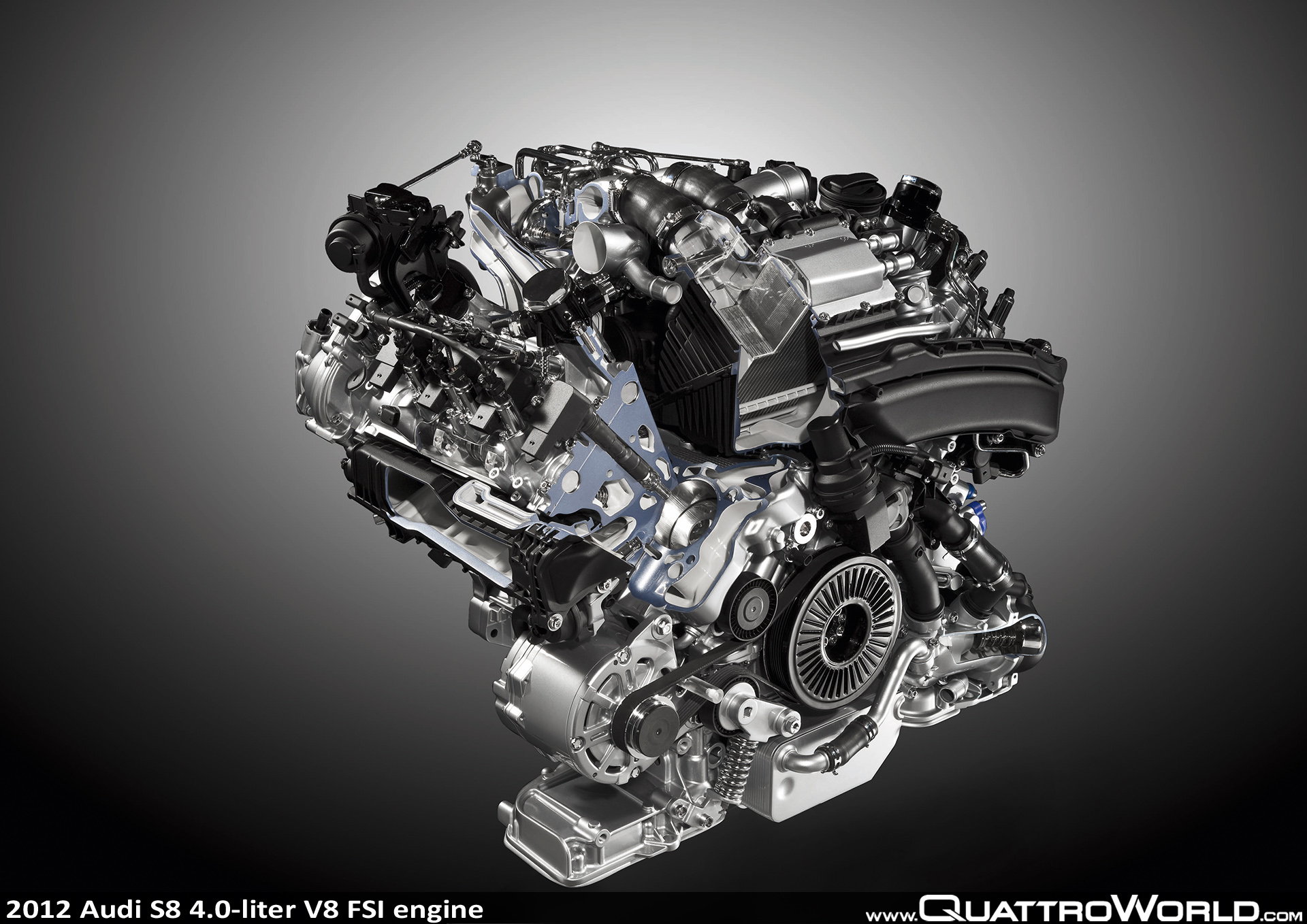

Looking into the cooler, its not going to be easy. Deffo not a diy. Looking at the intakes there is no easy hose connection, would need to be something fabricated. Looks like I will have to wait until some tuning company sorts out an upgrade.Leo-RS wrote:The stock charge cooler is holding things up with the hybrid turbos at the moment.
Other tuners have ditched the charge cooler in favour a new intercooler to get more horsepower, I'm sure there's an APR RS7 running over 1000 at the moment on hybrids and E85 and standard engine with updated big intercooler.
The MRC800 car is at early stages of testing and can't progress any further until they sort out the CC/IC.
Even trying to fit a larger CC there seems little to be gained. Might look at the water side to keep temps down but if flow is also restricted there will be little gain
