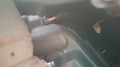

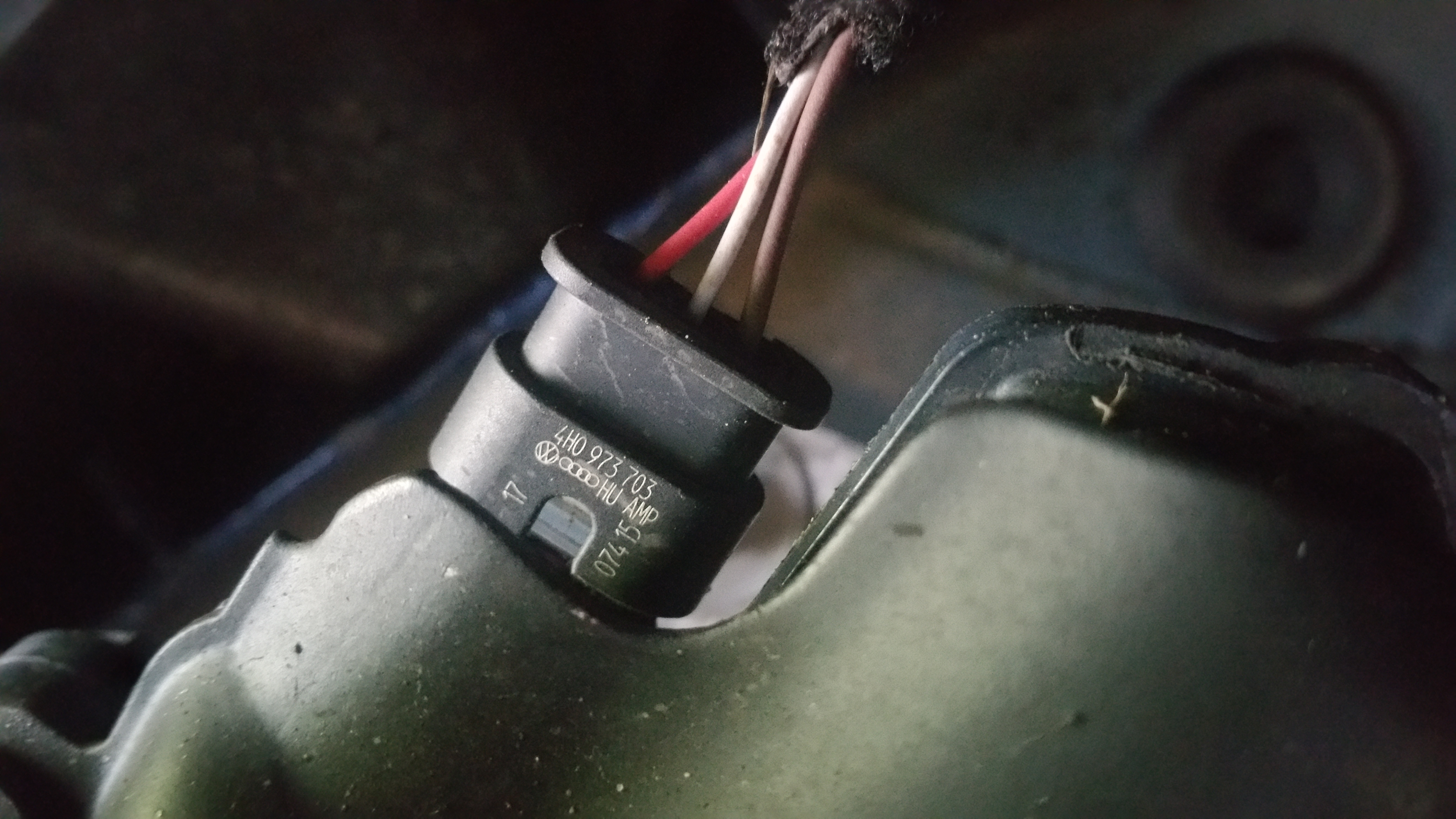

It's very difficult to photograph as space is limited.
Essentially go under the car, and look to the bumper side of each exhaust.
You will see a lead - follow the lead to the exhaust. There is a male/female plug into the exhaust.
Press the button in the top and gently pull it away. Job done.
Put tape over the socket and the lead plug and cable tie the lead away.
It's not as good as disengaging the vacuum on a b8 rs4, but it is marginally better than the valves being on, IMHO.

Sorry best photos I could get wedged under the back of cat with big brick phone! As above really simple to do. Hope it helps.
