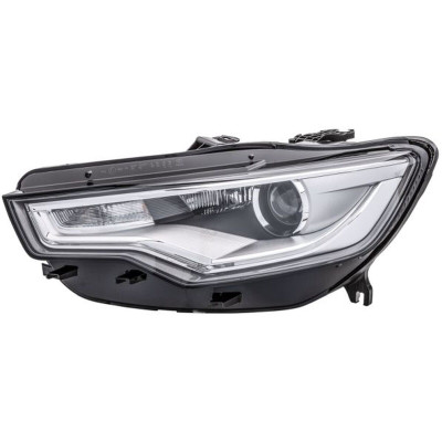

ok without sounding thick i have no idea on my headlight type, went in via the airbox , i can see the indicator bulb, then another bulb next to it which i have taken out (H7) bulb , then next to that is a sealed unit which is where that big round part of the light is almost like a camera lens , thats what doesnt light up, and neither does the H7
tonybolony70
Posts: 7
Joined: Sun May 03, 2020 9:36 pm
Re: RS6 Headlight Bulb
Post by tonybolony70 » Wed Dec 06, 2023 1:13 pm
, this is what my headliamp is like , also tested the H7 on a 12V battery and that is working

Post by morski » Wed Dec 06, 2023 4:49 pm
Easiest way to check the bulb is to swap the xenon bulb form the other side to this one and test it. Still no joy would then mean testing the control units again by swaping from other headlight. Again check fuses as well just to be sure
