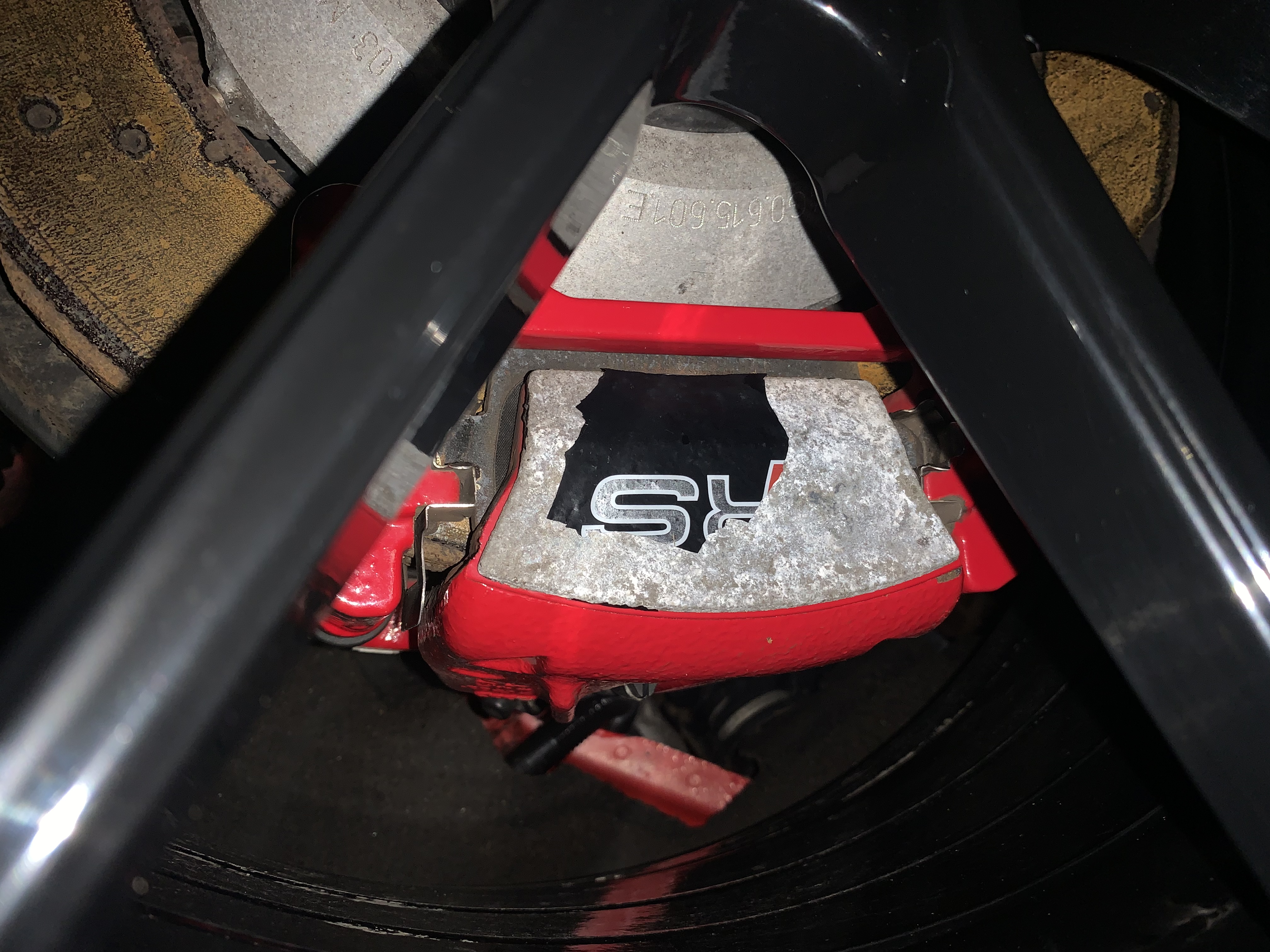

The decals on my rear caliper flat faces have broken down and need replacing. Expecting Audi dont offer this on its own what are the options please?

Im hoping to cover the full face like OEM rather than just the words RS6, didn't see that when I searched.

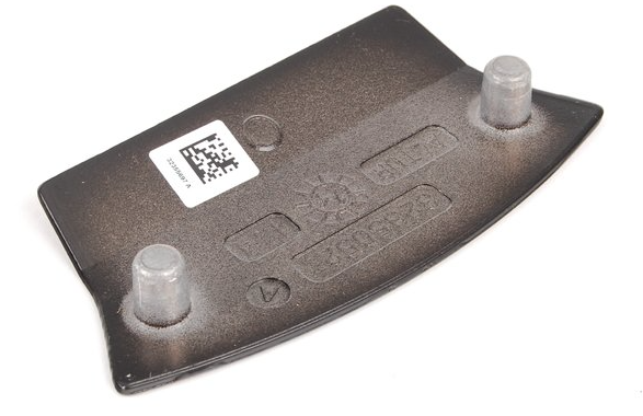

The RS6 c7 rear caliper is a fairly common style used on a lot of VW group cars with the exception that the outer face of those fitted to the RS6 C7 are predrilled to accept the cover plates.
When I did my pads and discs it was a simple matter to gently prise off the covers (iirc the cover pins are solid aluminium posts that are a friction fit in the caliper holes- with the 'clips'). My covers were in reasonable condition so not much effort was required to remove them- your ones seem pretty corroded so maybe some release fluid on the cover pins would help so as not to damage the cover when prising(?). [It turned out I could have left the covers in place when changing the discs and pads as the pistons simply push back in and don't need to be screwed back in with a winding tool (VCDS is required to back off the hand brake though)].
As usual google is your friend - part number appears to be 8K0698221A (best to confirm with Audi).

That's a great find, thanks, I checked with an Audi parts supplier and its a discontinued part sadly, not sure why or what the alternative is now, probably a full caliper.

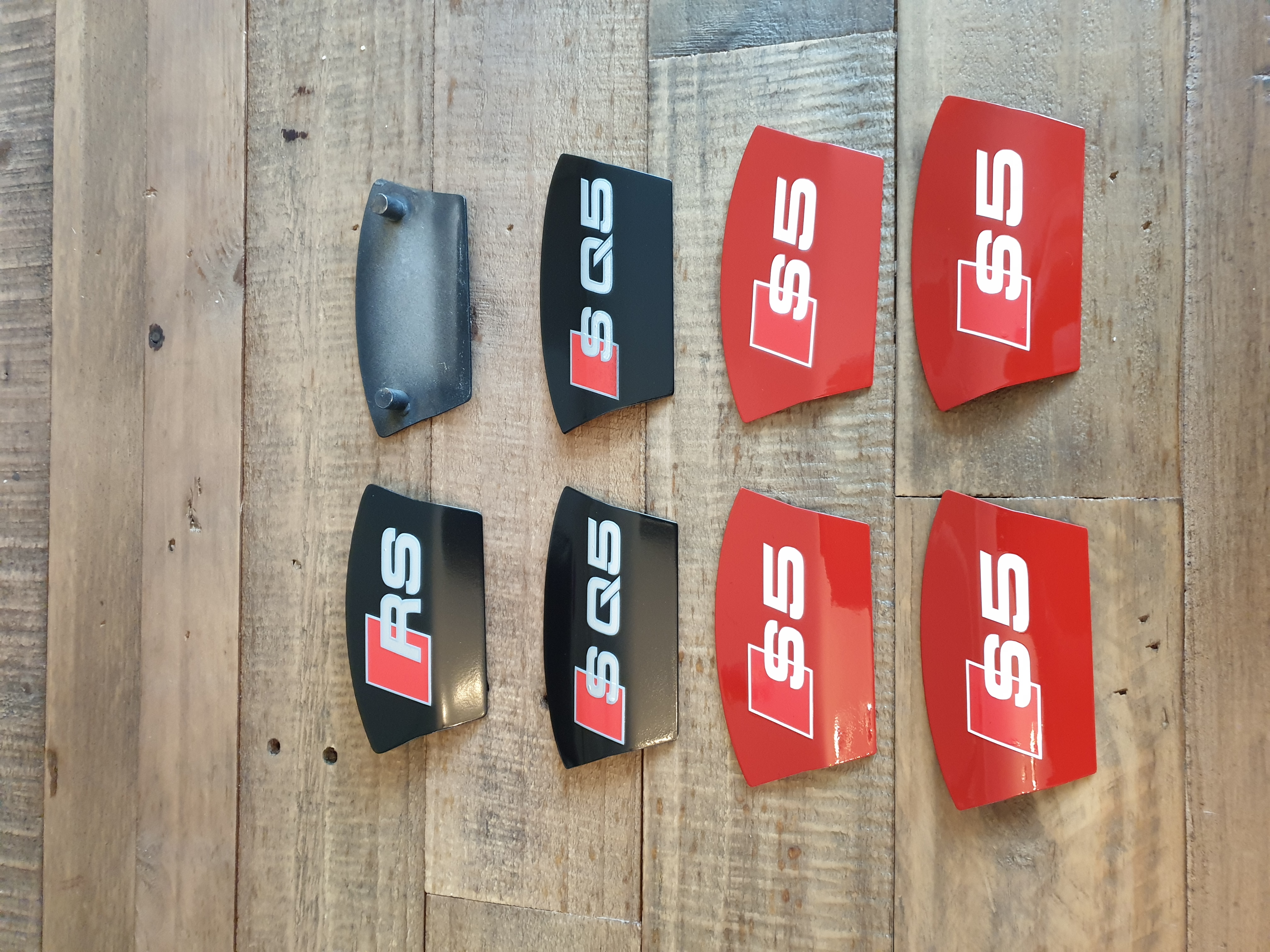

I managed to get 2 new rear decal plates and emblems - custom made:
Dave Williams used my remaining OEM as a pattern and fabricated the plates including the mounting pins (a first for him). The finish is truly top quality and really puts my OEM plate to shame. Best of all they are stainless steel construction so should fare better than the aluminium OEM which are prone to oxidation!
And I didn’t need to waste money on buying a new calliper just to get a replacement plate after all - I almost did!
Please feel free to drop Dave an email enquiry (davewilliams220@yahoo.co.uk) if you are in the market to replace/refresh your calliper plates - you wont be disappointed!

Plates are relatively easy to replace - on my stock (non-performance) 21” wheels I didnt even need to remove the wheels to do so. It was a matter of gently prying off the my remaining OEM plate - the fixing clips came out attached to my plate- otherwise it would have been easy to fish them out. I have a kit of plastic interior trim removal tools that I used one of to ease the plate off - I’d recommend not to use anything metallic. The clips have small barbs on them and it was fairly easy to make them more prominent again to ensure that they grip the plate pins and calliper holes.
I think prices are around 70 GBP for the pair - excellent value compared to a +400GBP calliper from Audi. Make contact with Dave, he is a great guy; he will let you know the actual pricing and I am sure that you wont be disappointed.
