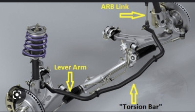

I also think it’s arb links, but they didn’t checked that, don’t know what to do, it’s a little bit annoying when you go to Audi and they can’t find anything neither any noise anything

As morski wrote I think it can be a arb links but Audi couldn’t diagnose that, so I think I should go to them and point this picture asking please check ONLY ARB LINKS

Jump into a reputable garage mate and ask for their opinion.
