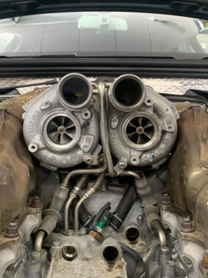

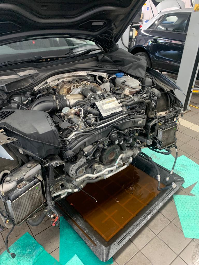

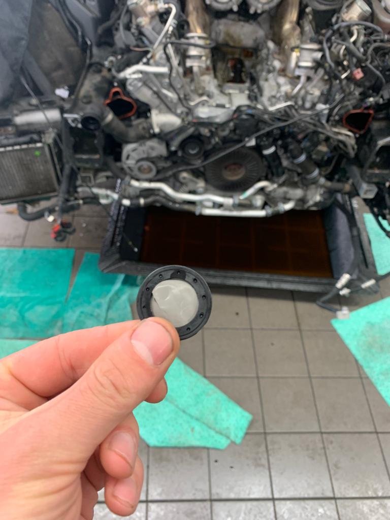

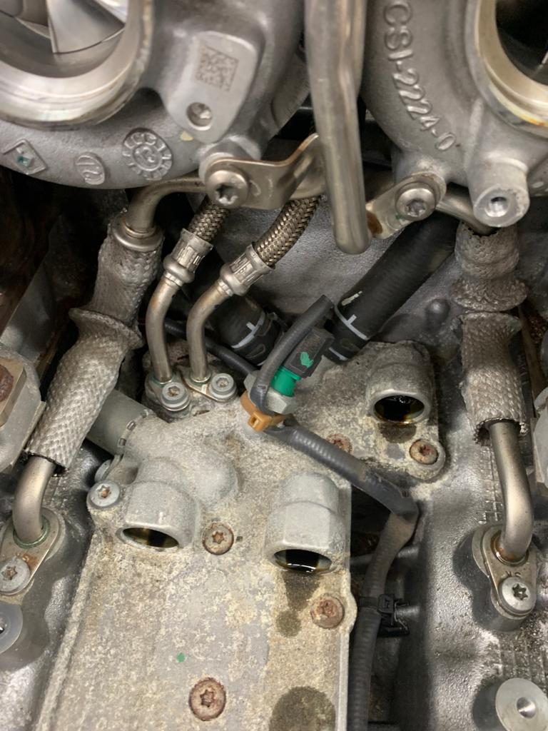

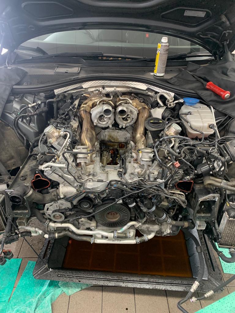

Well it turns out it’s not the strainer that’s on back order it’s actually the rubber seals on the breather unit. Audi won’t authorise the replacement of the unit just the small plastic strainer and the seals.
Once the breather is removed to change the strainer to a metal mesh the seals need to be replaced.
If you want to pay for it Audi will supply new unit plus the strainer.
As you will see from the pics it’s an all day job for a standard car but longer if you have Adaptive cruise night vision as all need to be recalibrated

Wow, a lot need take parts away, that’s why Audi don’t want to do it, I still don’t have anything on my Audi app

I think that’s my car! It went in with a misfire and only got the recall work because I had an issue with the crank breather. The master tech working on it refused to do the crank breather an not the recall work…. He pushed to do it all at the same time as if split into two jobs it’s number off job both times….
Well mines running much smoother now I’ve had my misfire issue sorted and bonus the recall got done. As you can see the gause on mine was split.. if it had broken down it would have mashed the turbos. Hope everyone gets a resolution on theirs… seems like Audi can’t hold out much longer
