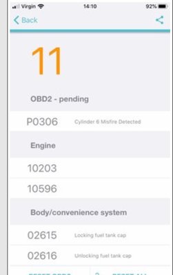

Post by Tadass910 » Mon Feb 03, 2020 5:55 pm
Lig wrote:
Mon Nov 18, 2019 9:53 am
So did a google and downloaded OBD Auto Doctor and this shows the misfire counts.
Interestingly tho' it shows cylinder 8 having more counts than 6 (the others have very low or 0).
I am no engineer, but maybe 'some' misfires are normal and the ECU 'manages' these...??
But because it flagged an error with Cylinder 6 (when the EPC light came on, and the car ran rough) then I still plan to change the ignition coil on 6 and we will see how it goes...
Cheers,
What means those codes on carista app? 10203 and 10596?

Post by Lig » Wed Feb 05, 2020 9:11 am
Hi Tadass,
I 'think' they are generic codes for engine misfires.
My understanding is that in general there will be some misfires and the engine management 'manages' this.
IF your Engine warning light (EPC) is not coming on, and all is running fine, then no problem. But if you are experiencing physical misfires and the car is not running smooth, then you need to investigate further. I would recommend downloading the 'OBD Auto Doctor' app, as this will show you the misfire count and on which cylinders (please see my posts in this thread).
I hope this helps.
Lig.

Post by Tadass910 » Wed Feb 05, 2020 2:18 pm
Thanks for information, I don’t have a check engine light, but with my carista I tried scan and got 10622 code, I tried removing it but it always comes again, car runs fine no issues, obd auto doctor not sees anything.

Post by Lig » Wed Feb 05, 2020 3:42 pm
Thats strange that OBD Auto Doc doesn't show any misfires? Have you looked at the 'On-board Diagnostics Monitors' (example images earlier in this thread). As I would expect it would show some misfire counts even though it states 'Passed'.... With my issue, Carista flagged up an error with Cylinder 6 misfiring but OBD AD showed more misfires on Cylinder 8. When I got it checked with VCDS this also showed the problem with cylinder 8. From my experience I would use the Carista as just a guide...

Post by Tadass910 » Wed Feb 05, 2020 5:09 pm
When i scan with Carista i only get this code 10622 with obd auto doctor I don’t get anything
