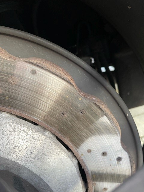

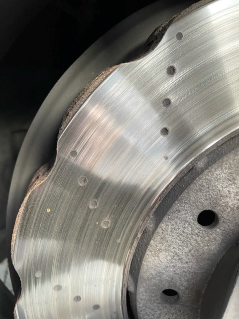

I've attached some pics of my discs. I would say the lip is around 0.8-1mm (probably more pronounced on the inside edges) and there is some noticeable corrosion (which flakes off when rubbed). But I'm not getting any judder or squeal and the wear dimples are still visible.

I would measure the thickness. I would say they are close to being on the minimum.
I changed my front discs and pads at the weekend (B8 RS4) and I waited for the light to come on.
This is the 2nd time I have done them, 1st time at 30k and 2nd at 61k so fairly consistent. The discs were below minimum thickness and that is with one set of pads.
There is only 0.8mm per face on the discs. The pads had about 3-4mm left.
As the front pads are reasonably expensive and you will probably be changing the discs well before the pads are worn out, I would just bite the bullet and change the lot.

I think you’re right about the discs getting close to minimum as I have since read in another post the difference between full thickness and min thickness on these discs is 1.6mm, so with mine being ~0.8 worn on one side I must be close to this. I think I am edging towards biting the bullet. I’m just not sure how much longer I plan to keep the car. But I guess even if I sell next year, nearly new discs will be a big selling point.
