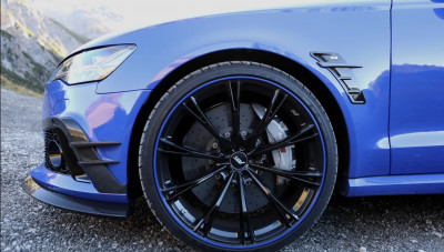

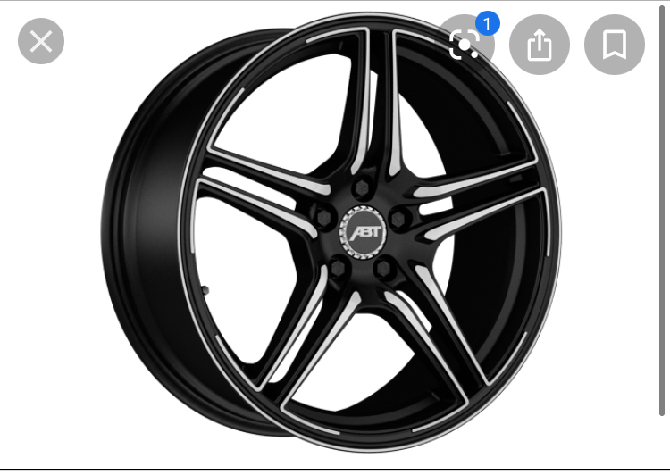

I am looking for some new wheels for my RS6 Performace with the ceramic brake kit. I am looking for a set like the black set below. Any ideas?ImageImage

Black rims looks nicer

They are BBS CH-R II powdercoated all black

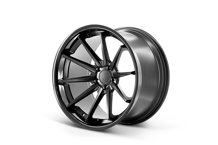

I wonder if I can put 20'' wheels on RS6 with ceramic brakes. I am trying to find a model I like but the guy that is selling them told me that 20s won't fit, too small for the brakes. I think I've seen a car with 20'' with ceramics or am I wrong?
The model is Ferrada FR4

20s will fit as long as they have the right offset and centre bore size. I tried wheels off a C6 RS6 with ceramics and 20s, they fit over the rotor and caliper but the centre is too small on the older C6, 55mm vs 65mm, so I needed to use spacers to put them on but they went on.

Those wheels looks like they would suit, they have to have a steep angle from the centre to clear the callipers, these look like they would do the trick

I asked the seller two times, he was pretty sure this model will not fit. Sadly I like it a lot as well as one similar which will not fit as well. Will need other deep concave model to search for, there are not many.
