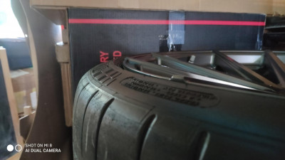

These photos are of Michelin PSS 285/20/21 on a 10.5 rim. Look okay to me, see what you think.

Thats what ive seen everywhere that the 285 is perfectly fine on the 10.5" rim. The picture is what im referring to.. look a little stretched to me and exposing the rim so theres no rim protector. what do you think?
I know different manufacturers of the same size tyre can vary in the way they protect the rim edge.

I was going to suggest that maybe it looks bad in that photo due to the actual style of the wheel but they look like the exact same wheels I have and the box behind them is the box mine came in too. I see what you mean though but I don't remember mine ever looking like that. Maybe it looks worse because they don't have the weight of the car on them.

Yes TSW Bathurst 21x10.5... Pictures i have seen the 285's look ok but these do look like they need some extra width ... like you said maybe they need the weight of the car on them but i have my doubts
