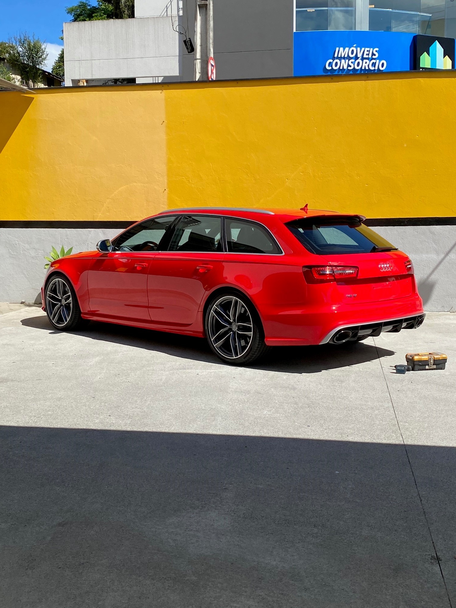

I recently purchased my RS6. I have had many "cool" cars but the desire has always been to acquire this one in particular. I still have a Macan at home and I traded my brand new LR Velar P380 for a red monster.
I wish the more experienced could help me:
- 2015
- Only 12K KM
- All revisions every 6 months at Audi
- Tires and pads have already been changed by the former owner
- Full package, carbon, ceramic, alcantara ...
Questions:
- Should I change the differential and gearbox oil?
- In the morning, when I leave the garage after reversing, I can hear a "cloc cloc" just like something lose and the noise stops as soon as the car warms up - any suggestion of what it might be? I´ve read many thoughts about suspension, gearbox oil, s-tronic problems, quattro ...

2. Does the knock happen when the steering is on full lock only or does it happen when travelling straight? If on full lock, then this is normal and is to do with the tyres and geo... If when going straight then I would get this checked, do you have warranty?.
Is that image of your car? As it’s a pre-facelift and I thought all 2015 cars were facelift. But maybe a 2015 64 car could be pre-fl???

And you´re right It´s 2014/2015 car without the face-lift. Probably just a few were produced on this spec ... Car was purchased 2014 nov.
