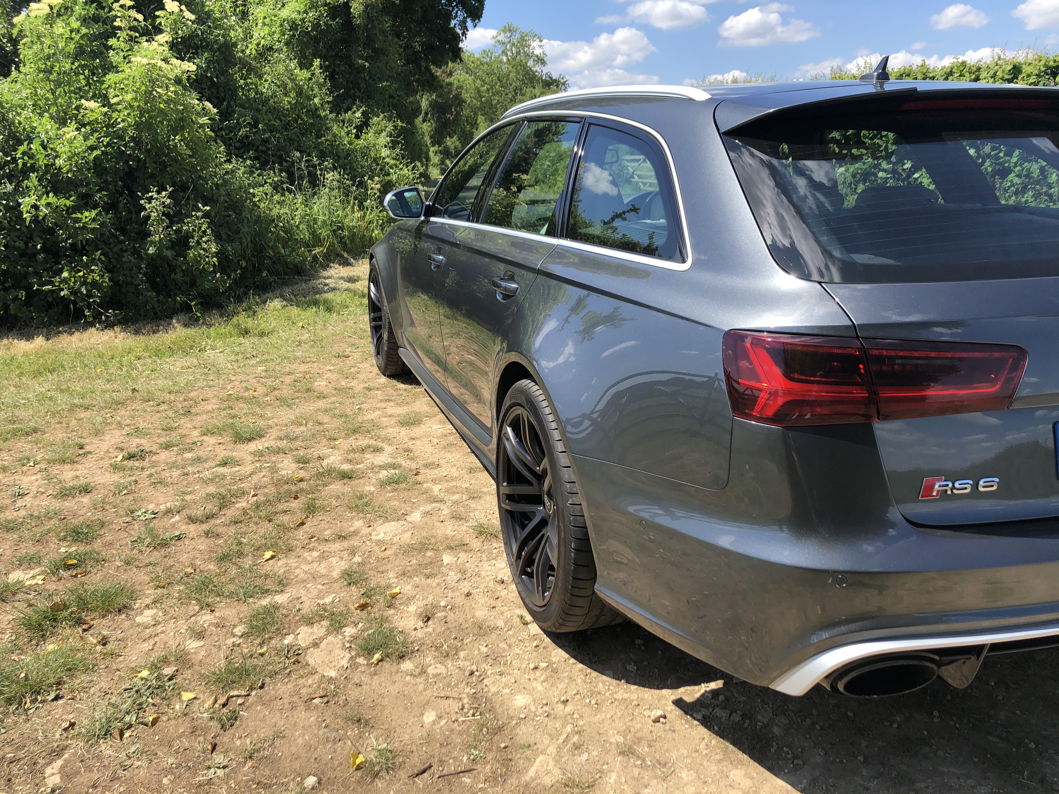

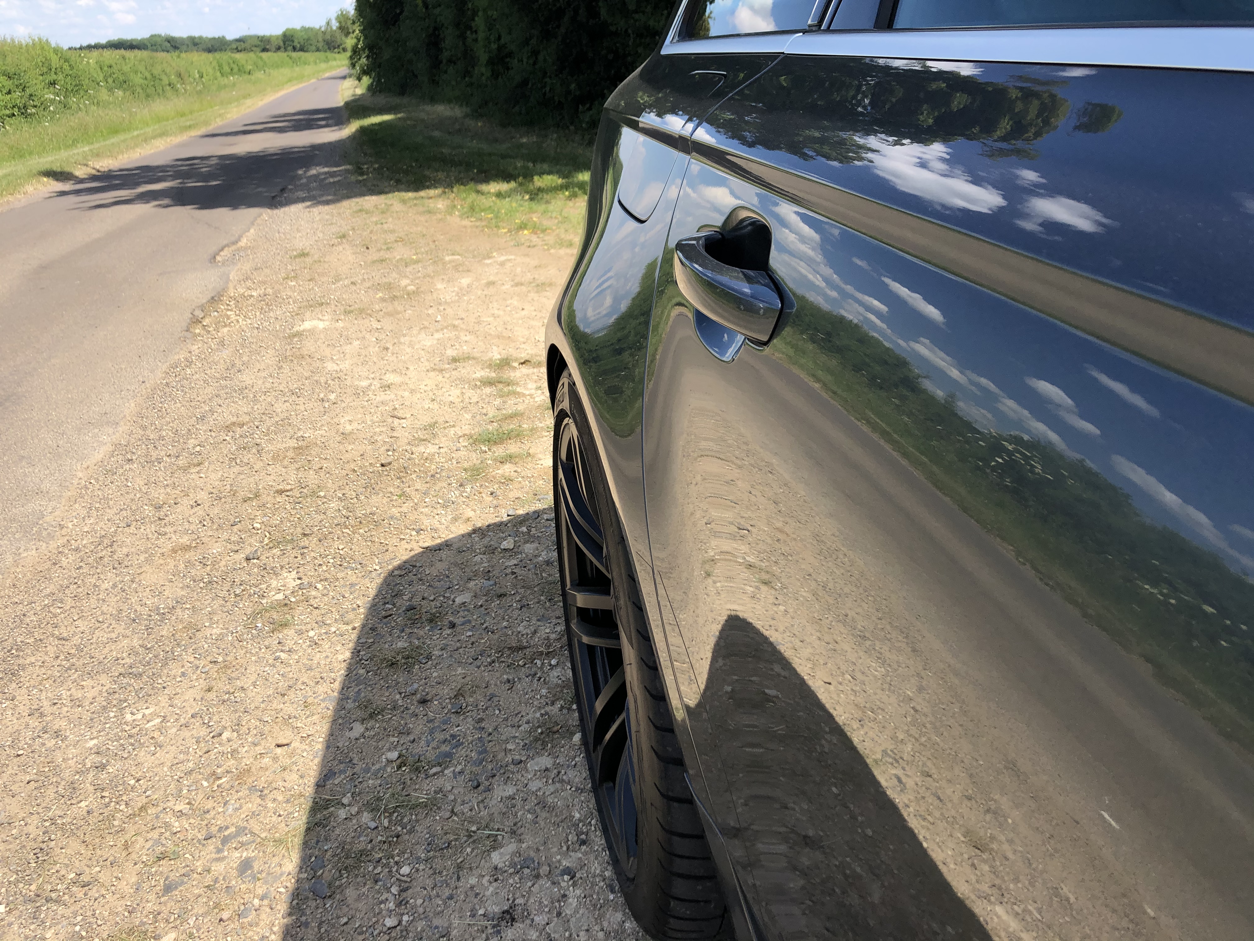

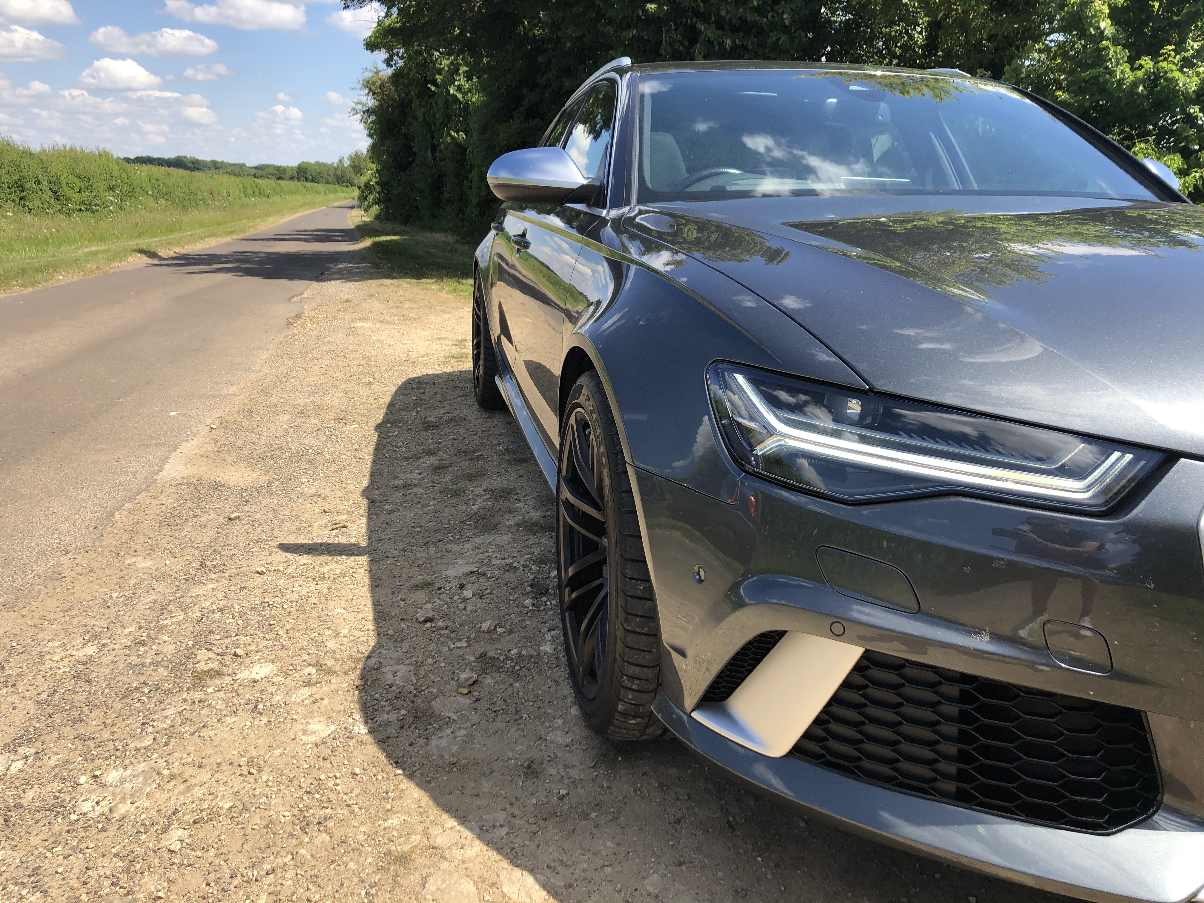

So got my spacers and bolts fitted today. Along with some OE 20’s from OE silver 21’s and it looks a million times better! The fitment is bang on. And the bolt lengths were fine. With no catching on the front. And plenty of engagement on the rear.
For reference I fitted;
OE 20’s with 275/35.
12mm spacers on the front.
15mm spacers on the rear.
The bolts fitted were the ones supplied with the spacers.
The locks are McGard black series 41mm with radius seat
On measuring alone the lock bolts are 1mm to short on the rear and 2mm to long for the front. But in use as I say. There’s plenty of engagement on the rear. And no interference on the front. All meaning I only need one locking wheel key.
I’ll take some pics tomorrow for you too see.
All that’s left ride wise is to loose some arch gap! KW HAS kit inbound!!!
Craig.
